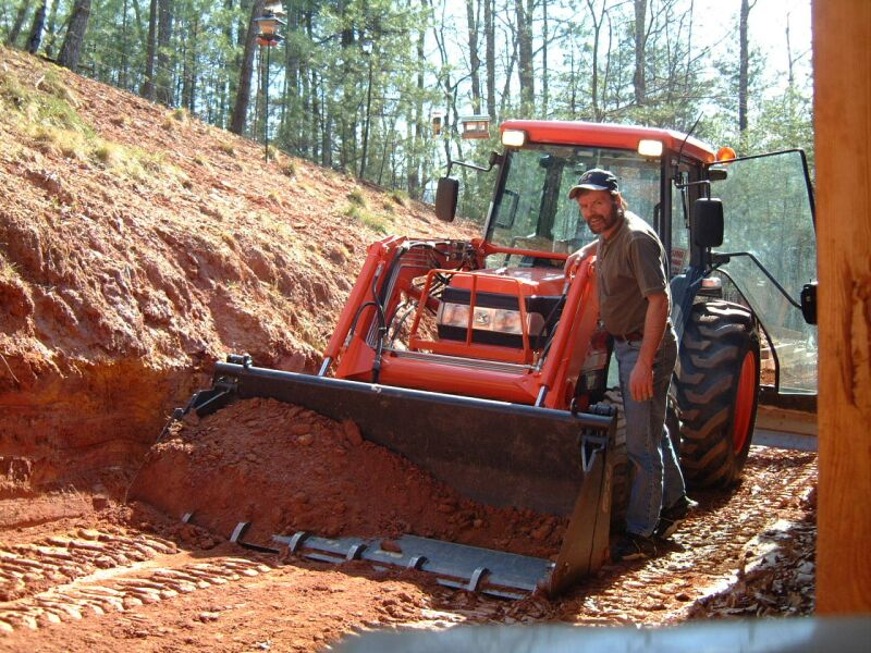

I have the 4n1 bucket from W.R.Long, mfg in Tarboro, NC. Mine was installed with my tractor (also from Carver Equip.) I have a Kubota 4610 and it works great. It's a bit heavier than regular bucket so filled tires are needed and an implement behind helps too. I've pulled 5-7 inch Jack Pines and white pines up by the roots with no problem. I've never gotten really good at using it as a reverse type box blade yet but it can do that as well with jaws open and rolled down and under. A great investment.
