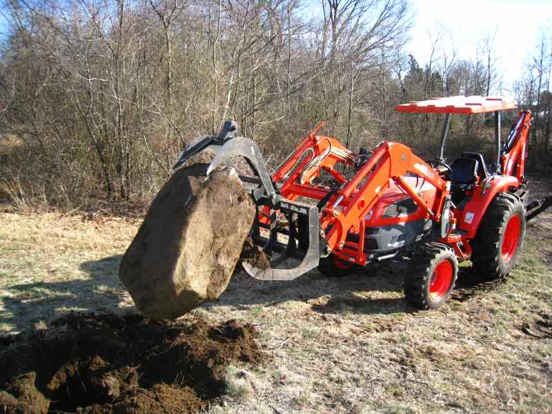

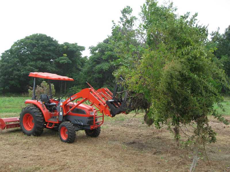

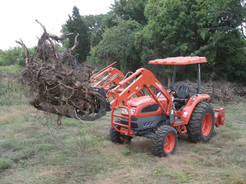

You should read through the many grapple threads on TBN. Do a search. To begin to answer your question though let me give you some things to think about. First, do not make the common mistake of buying a grapple rake that is the same width as your loader. Mistake. Expensive and heavy mistake. You will get more productive work done and save money with a smaller grapple. You have a 40hp tractor. So do I. I have a 48 inch light duty rake on a loader with 3700lb breakout and 2700lift capacity. No problem. Works great. Costs about a grand and weighs half of what a Bradco does. The big grapples are built for skid steers not CUTs. CUTs need light duty grapples. Markham seems to be the most popular these days on TBN but check out WRLong for comparison. And again, remember that the grapple market is mostly aimed at skidsteers so don't be bamboozled. Small is beautiful.

Island,
Impressive pictures and good information. Thanks.
That rock is impressive!
Your first picture would be good for Halloween. Think of kids ringing the doorbell "trick or treat" and the tractor with open grapple comes rolling out looking for them :eek::eek::eek:
Ken
I was thinking of painting some green blood drops on the grapple jaws and carrying around a JD mower for halloween. :D
