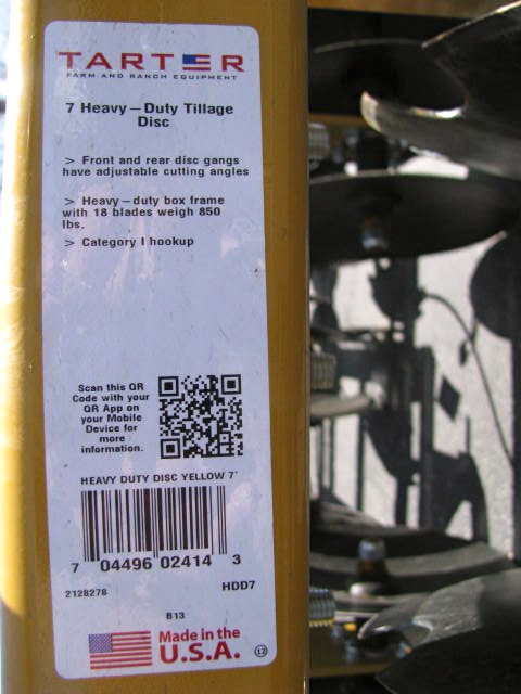

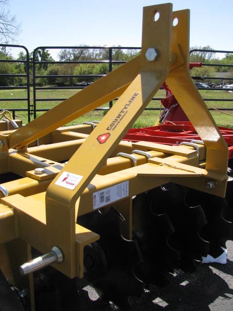

40% correct, varies by geographic area, varies in time. Recent photos.
It is your money. Buy what will make you happy. Sometimes I buy the value implement too.
I have never seen a Countyline PTO implement without thick rust on the PTO splines. Why TSC does not protect the splines with Fluid Film and a cover I do not know. It would be worth $100 to you NOT to have to clean the rust off.
You cannot connect PTO shaft from the tractor to the implement unless splines are absolutely rust free, smooth and lubed with something light, not greased. And connecting PTO is still always a trial.
