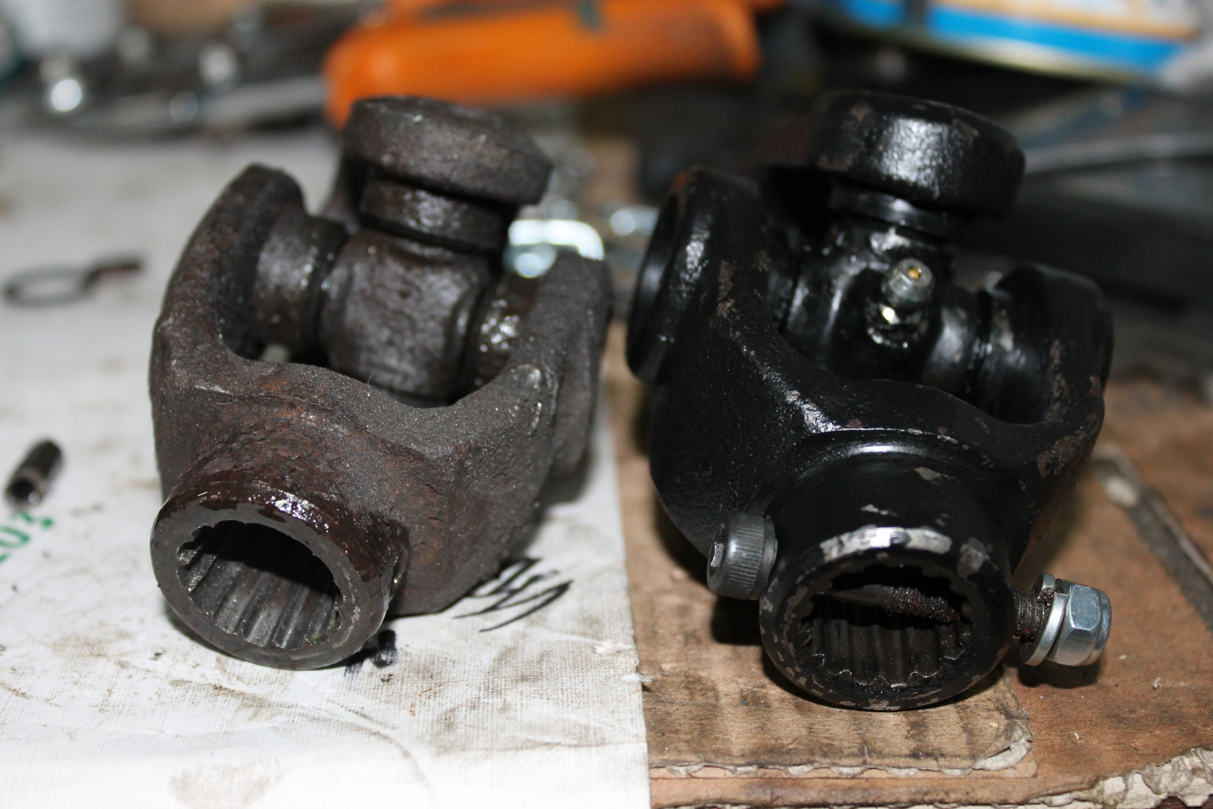

I stripped the splines of the U joint on a Kubota B7000 a looong time ago when I didn't knew any better. It happened a couple years after I built and added the loader to it, that really put the stress on the front axle.
Luckily it stripped the splines on the U joint and not the splines on the pinion shaft of the front axle, so that mishap only cost me around €70.
And this is what happens on tractors without loaders and people do not care and run with 4WD engaged all the time, regardless of the type of surface. Pic from an ad:
image;s=1000x700
These are obviously extreme cases that won't happen right away, however, if done enough times it will damage something eventually.
Spending 2 seconds disengaging the 4WD when not necessary can save a lot of money in the long term.
