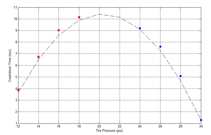

I don't worry about F/R drive torque error on dirt, grass or gravel. It's a big deal on concrete or asphalt. And, air pressure is about the only variable available to you to change it if your axle loads are set (loader, loaded tires, sprayer tanks, full fuel tank.
You can check it using a coast down technique if you have a manual transmission. Start with a very high front tire pressure, Run the tractor on a level surface in a gear to give you a fast walking speed. Push in the clutch and time the seconds to come to a complete stop. Lower the pressure 2 psi and do it again. If you can draw a graph on the back of an envelope, plot the pressure on the x axis and the coast down time on the y axis. After a few runs, you should notice that the curve climbs a bit, reaches a peak and then starts heading down again. The pressure at the highest coast-down time has given you the lowest front rolling resistance which has a strong drive torque component. When the drive torques are balanced (i.e. no strain in the front drive-line) you have the optimum drive ratio (theoretically). Your results will depend on the load case you choose (i'd pick the heaviest one because that's where the tire wear and the drive-line strain would be highest).
For a hydro unit, there is no clutch to disengage, so I would run the test with the same procedure, but write down the speed you attain when coasting down a decline in the road. Same strategy: The lowest rolling resistance gives you the highest speed steady state speed for the exact same throttle setting.
If I were working, we would put strain gauges on the front drive shaft and measure the minimum front drive torque and front tire pressure. But this ought to get you very close. You do need to find the peak of the time or speed curve, though. If you can't, then you might have a tire size mismatch that's causing a problem. Worn tread, wider that standard rim width, or just plain wrong front or rear tire size is the cause.
   / 4 Wheel Drive and Tire Ratios #16
Here is an example of the procedure. Note that if you start with a pressure too low, it can take a while to get the optimum settings. Start with high pressure. You can bleed down the tires quickly without having to run back to the compressor. optimum pressure.JPG
