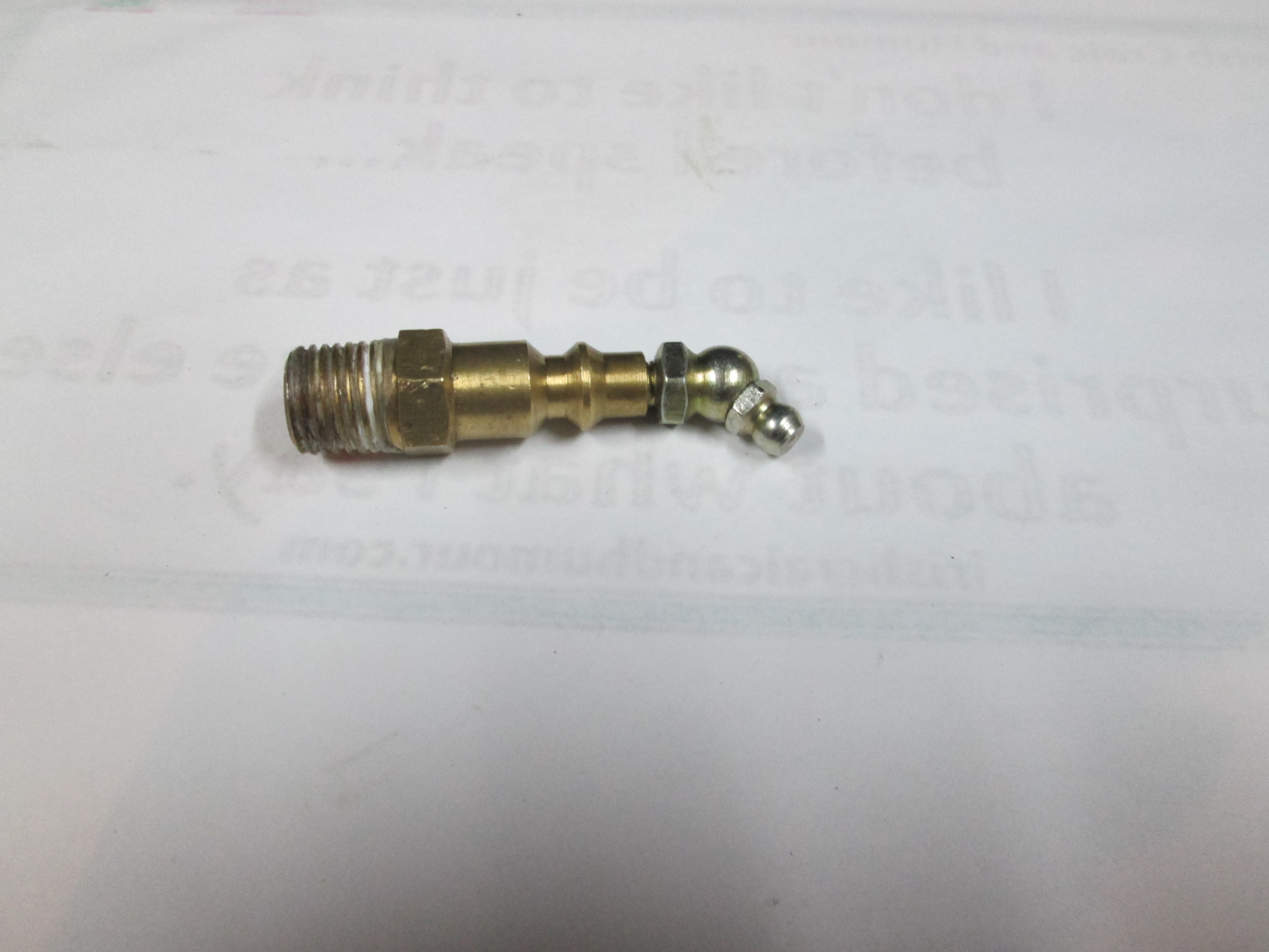

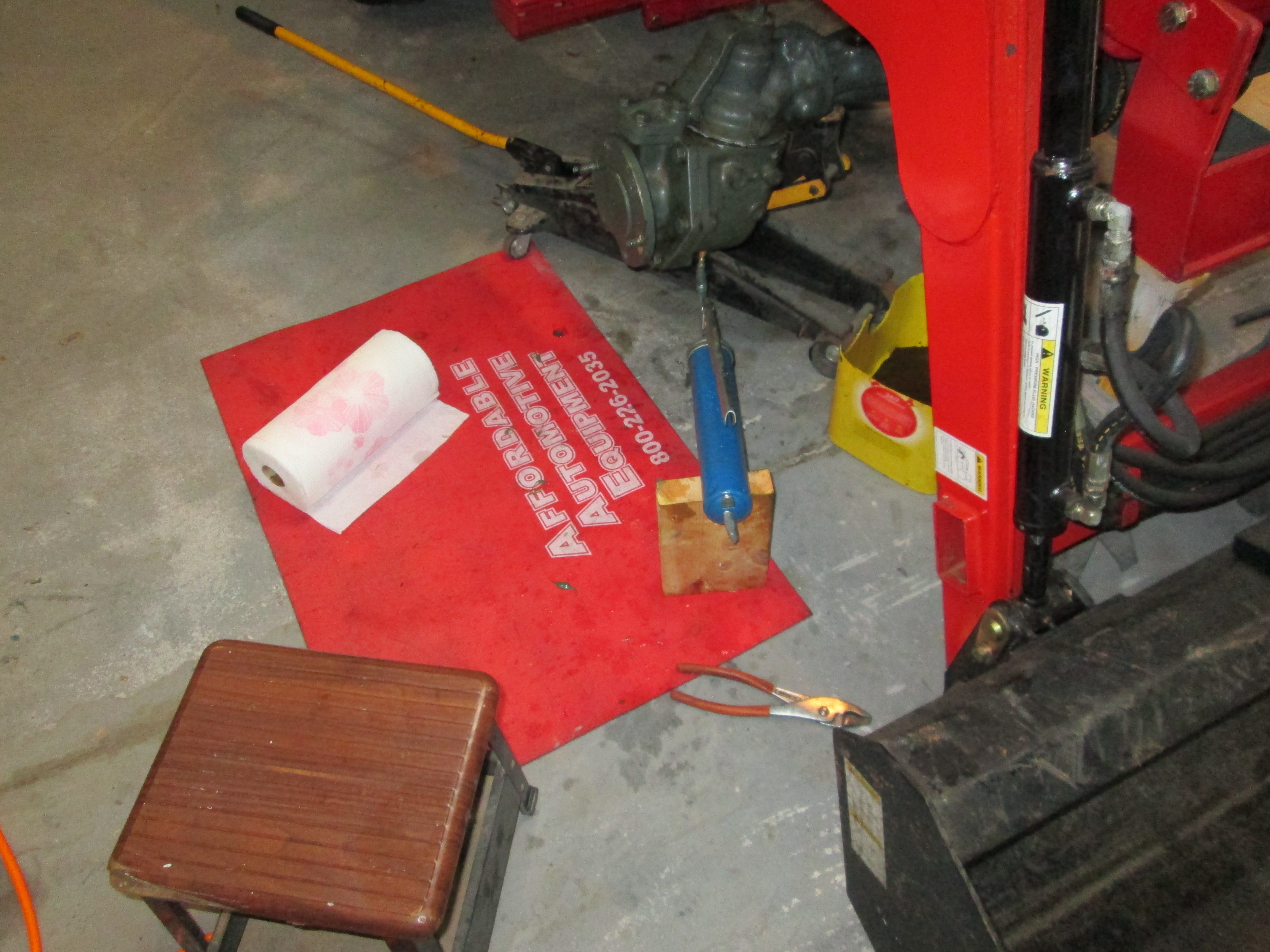

I reinstalled the seal and repair sleeve with some rtv sealer behind the sleeve. But I used the JD Corn Grease instead of gear oil. I made an adapter for grease from an Cabinets (1).JPG air tool fitting and drilled and taped it for a grease fitting. Always filled the hub from the bottom to eliminate air pockets. I put 11 tubes of grease in the front axle, NO MORE LEAKS. I posted some pics but do not know if they loaded.
   / 4 wheel drive front knuckle leaking #8
nice little design on the fitting for filling it. That's a lot of pumping to do with a manual grease gun!!!:eek:
