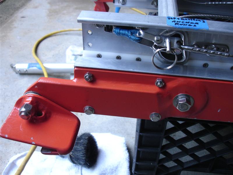

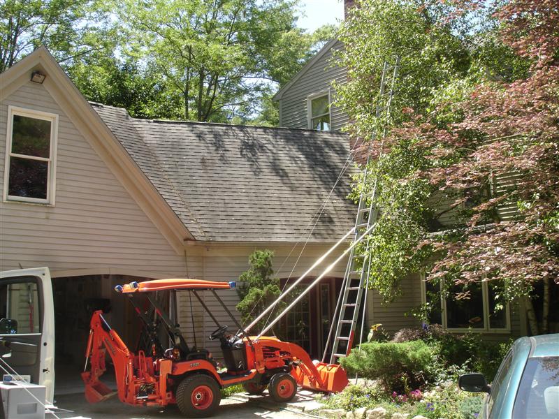

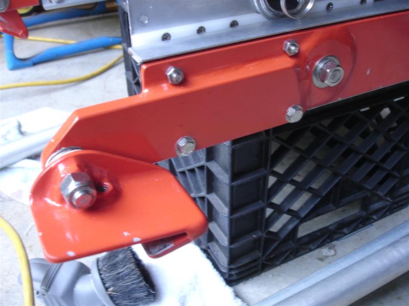

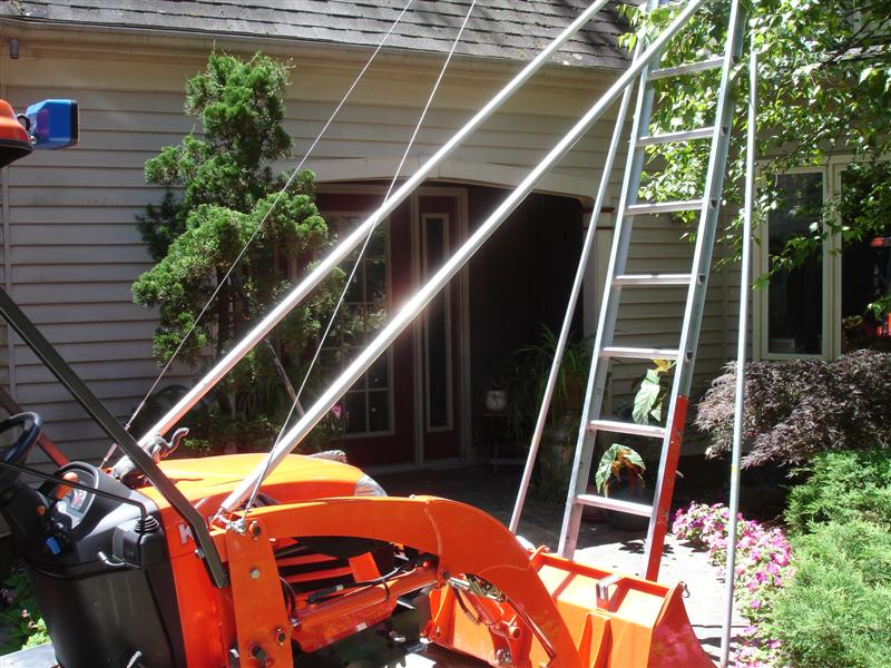

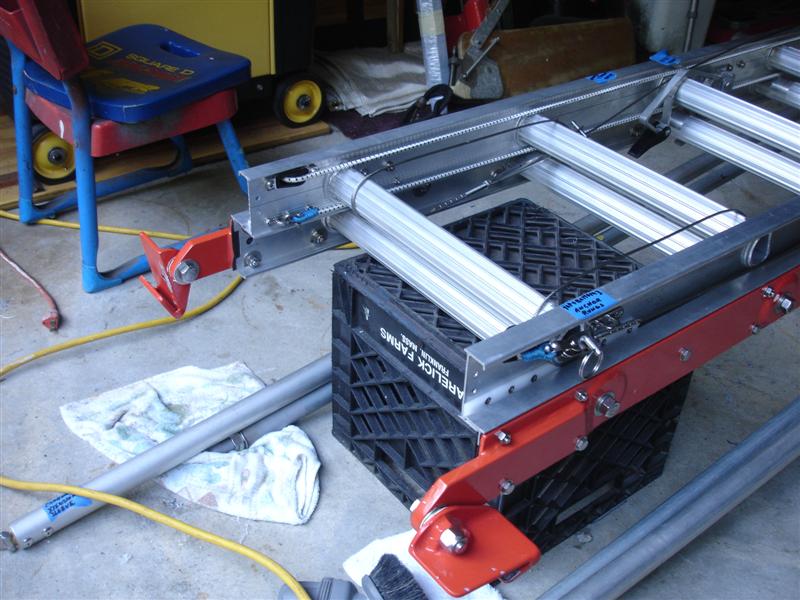

PB - Have done it and have been meaning to post fab pics. My set up is free standing & will have a small platform built for the top when I can find more quality Monster Garage time - today we're off to Sandy Neck in Barnstable harbor - first decent Saturday in a while - has been a pretty weak summer for getting on the water this year. Couple pics in the meantime to tide you guys over . . . .

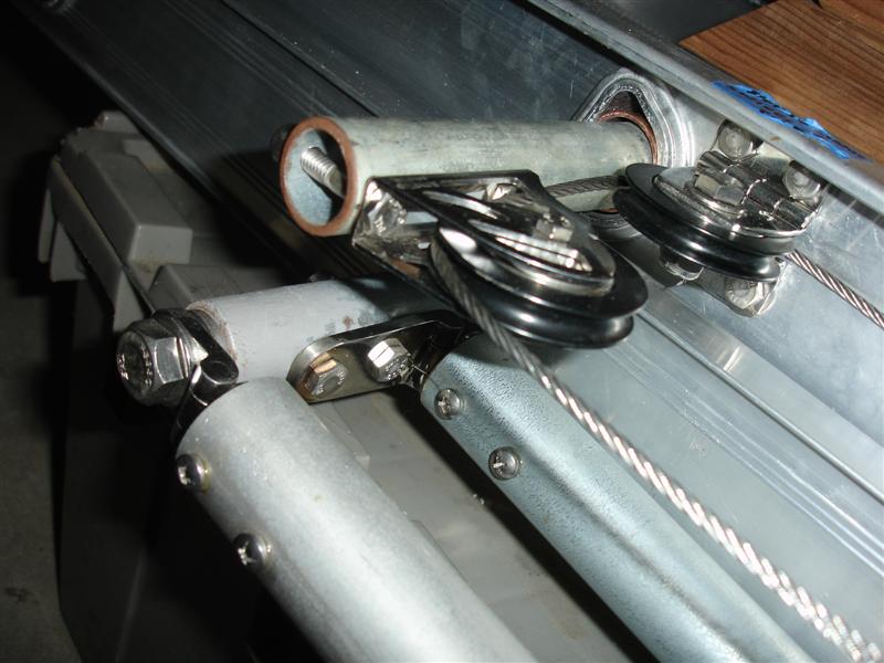

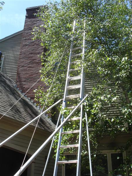

Couple more pics then gotta load the boat. Ladder is very stable but bucket needs to be to be planted hard, and dead level - I use two wedges cut from a 16" 4x4 under the bucket lip to accomodate grade. Will be mounting a small level on the ladder in the future. I put the outriggers down 1st to square up the tractor. Can lift the bucket up 7' and fold the entire assembly horizontally back over the sunshade for transit - though wouldn't attempt any crazy grades with it . .

ACHINBAC - that is some interesting engineering. I like how it looks like you don't need to lean against anything to climb the ladder. I'm not sure I trust my fabrication skills that much. I'm a little jealous of your cool idea now!
It would be interesting to see some close-ups of all the joints and "hinges" as well as a video of it in action.
It certainly gives me something to think about and that was what I was hoping to get from this thread.
