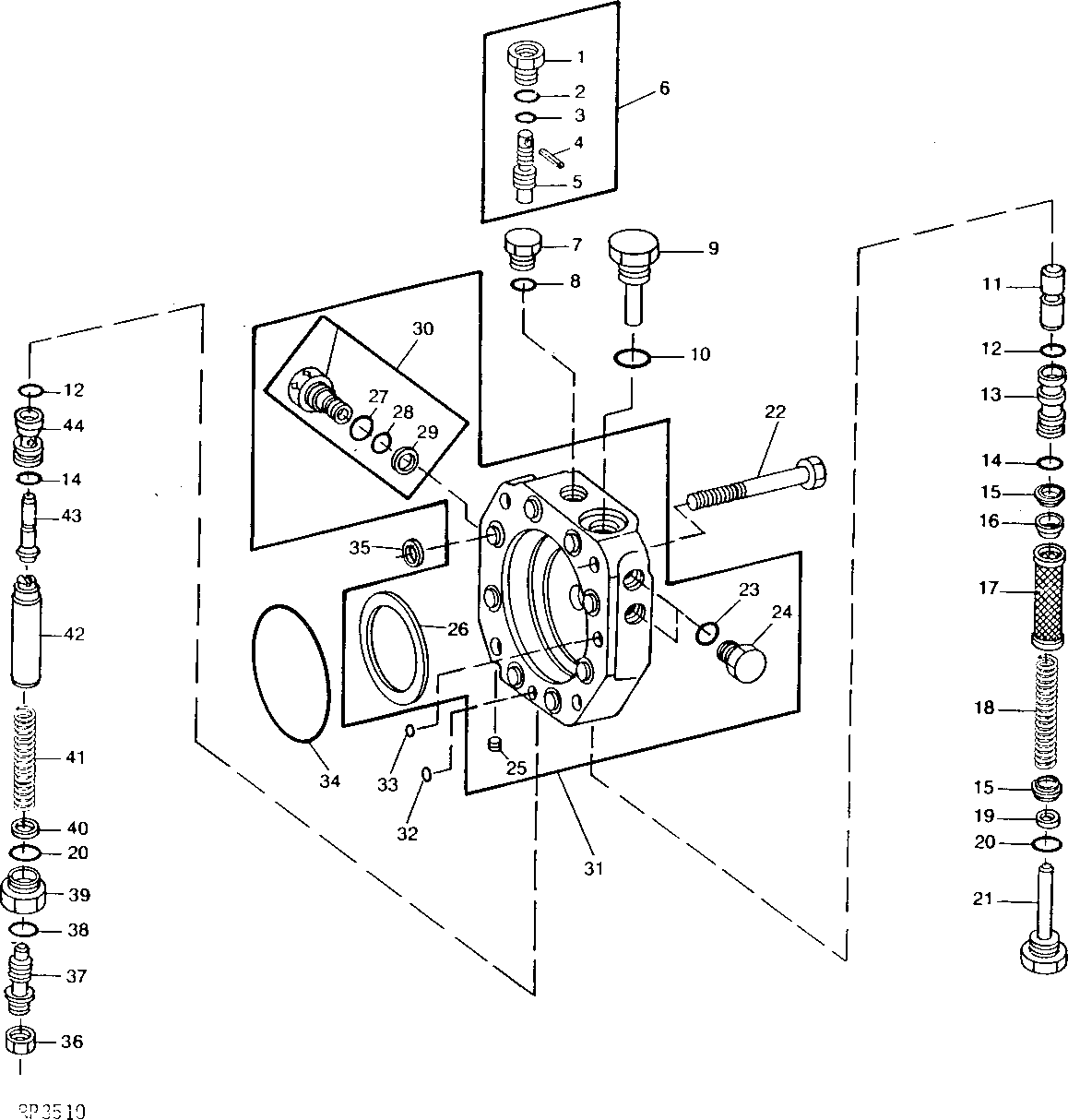

/ 401 C hydraulic pump..?? #8
Remove parts key #7 and install gauge. Here's the spec's on parts key #7
Thread Size 0.562 IN
TPI (Threads Per Inch) 18
Thread Length 0.394 IN
Length 0.689 IN
Diameter 0.00 IN
Hex Size 0.688 IN

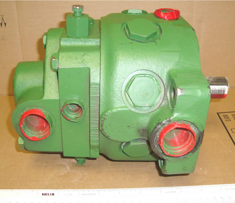

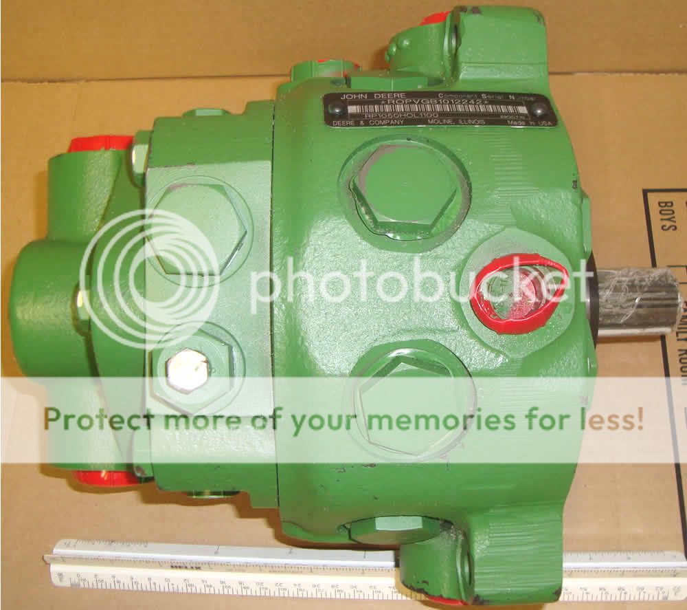

Have you checked the charge pump?
Some photos may help.
Your pump is the same, except your charge pump is in your transmission housing (I believe)
Right Side
Left Side
TOP
BOTTOM
FRONT
BACK
/ 401 C hydraulic pump..?? #10
Length 0.689 IN
Diameter 0.00 IN
Hex Size 0.688 IN
The thread size per your specs will be SAE 6. Also called ORB (O Ring Boss)# 6. The 6 is for 6/16" or 3/8"
