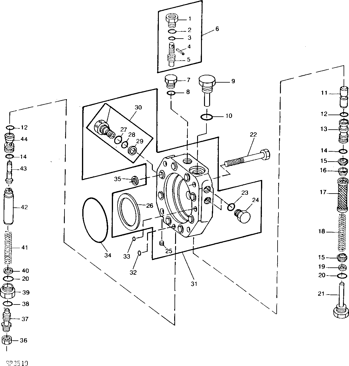

We've had this happen before and my guess is that its the stroke control valve. They stick sometimes and the dealer should have a tool that will take care of the problem. If it was the pump coupler it would have made a nocking noise long before it went out.
/ 4010 hydralics #6
We've had this happen before and my guess is that its the stroke control valve. They stick sometimes and the dealer should have a tool that will take care of the problem. .
I worked for a JD dealer for 21 years several years back and I'm unaware of any "tool" to correct a sticking stroke control valve other than a destroking screw(parts key #6).AR33249 SCREW,HYD PUMP SHUT-OFF,ASSMY/FIELD ADD 15.48 USD

You need a de-stroke vavle like tx jim said. Get one. Install it on hyd pump, then with engine running, screw it all the way in then back out. Should fix it.
Your tractor may already have one installed. They are fairly common. Look on top of the hyd pump for a little T handled screw theaded into a nut @ the front of the pump.

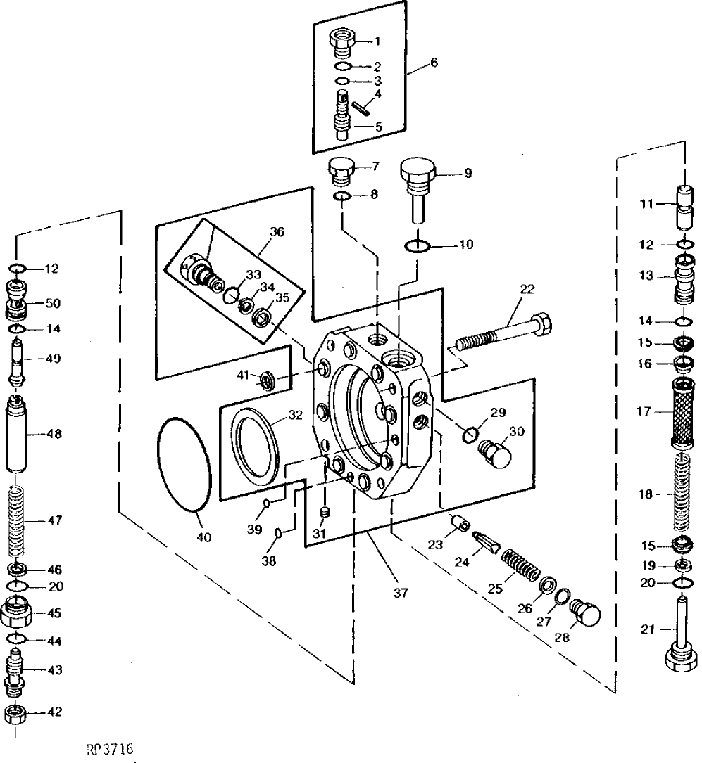

I've been looking all morning - pretty sad, I know,
For where to install the A-R27173 Filter Element; Stroke Control Valve.
In the paper I got from John Deere there was an arrow pointing to behind the left front screen, by the air filter.

Your screen goes in the hydraulic pump endcap. On the bottom of the pump you will see two large plugs. The one without the adjusting screw in the middle is the one with the screen. remove plug #21 and spring #18, some shims#19 and guide #15 should come out. Then packings 15 usually stay in the housing and will hold the screen in the housing. Use a pick to pull out the lower seal and screen should come out. The other parts above the screen should stay in place.
