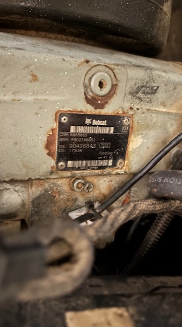

Try doing a search for RE 93430. That is the data sheet number for a Rexroth A30 pump. Does your pump look like the diagram in the data sheet?

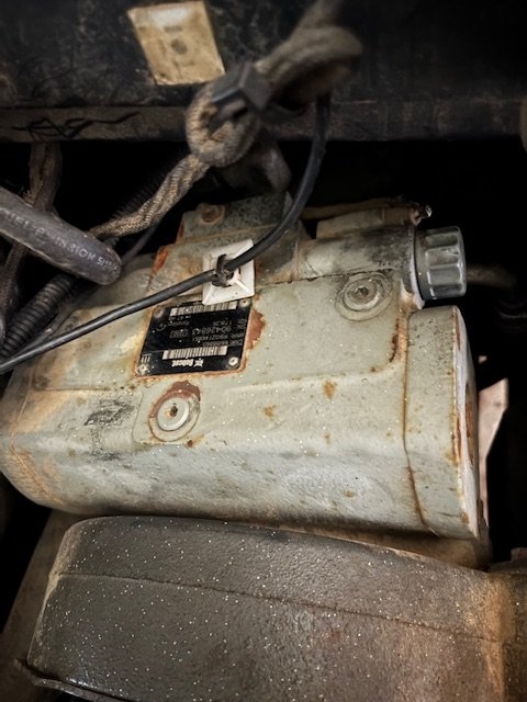

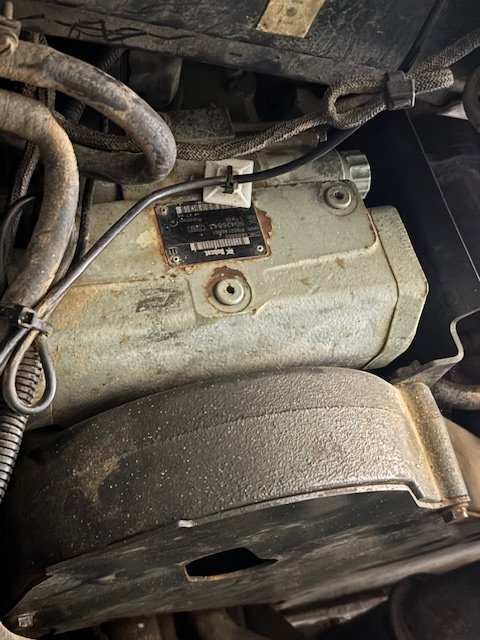

It does look like it. 3 pictures I took and one of the picture from the service manual.

   / 2018 Toolcat 5600 2100 hours charge pressure dropping when warming up ! #16
The name plate is a Rexroth product and description fits the A30. Pump was manufactured 36th week of 2017.
