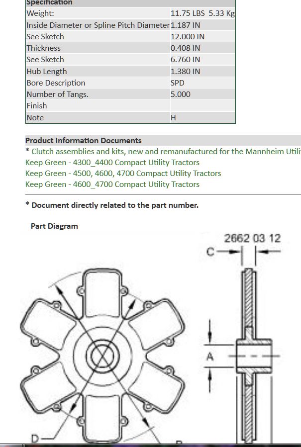

Not sure what a button clutch is or where this rubber boot is......I'll do some research and see what I can see.
I talked to the mechanic who I would have fix it. Had his own farm mechanic shop for many years. He said it sounded like the input shaft seal also and said he could split it and change the $2 seal if that is what it was. :) Gotta love it. Said it would be about 10 hours, maybe less. And that we would probably need to look at both clutches while we were in there. About $600 in labor, 2 clutches at around $300 each....$1200 sound like a decent price?
Probably have a little machine work and possible a few small parts for the clutch but have to wait and see. And he said the clutches may be fine, but if questionable he would advise changing them while we were in there as there would be hardly any more labor involved once it was open and tore apart.
   / 4020 hydraulic fluid leak #16
Button clutches has bronze like pads that hold good but aren't suitable for things such as FEL work. To access rubber boot one needs to remove dash panel that both key & light switches are mounted into and look to the left.
