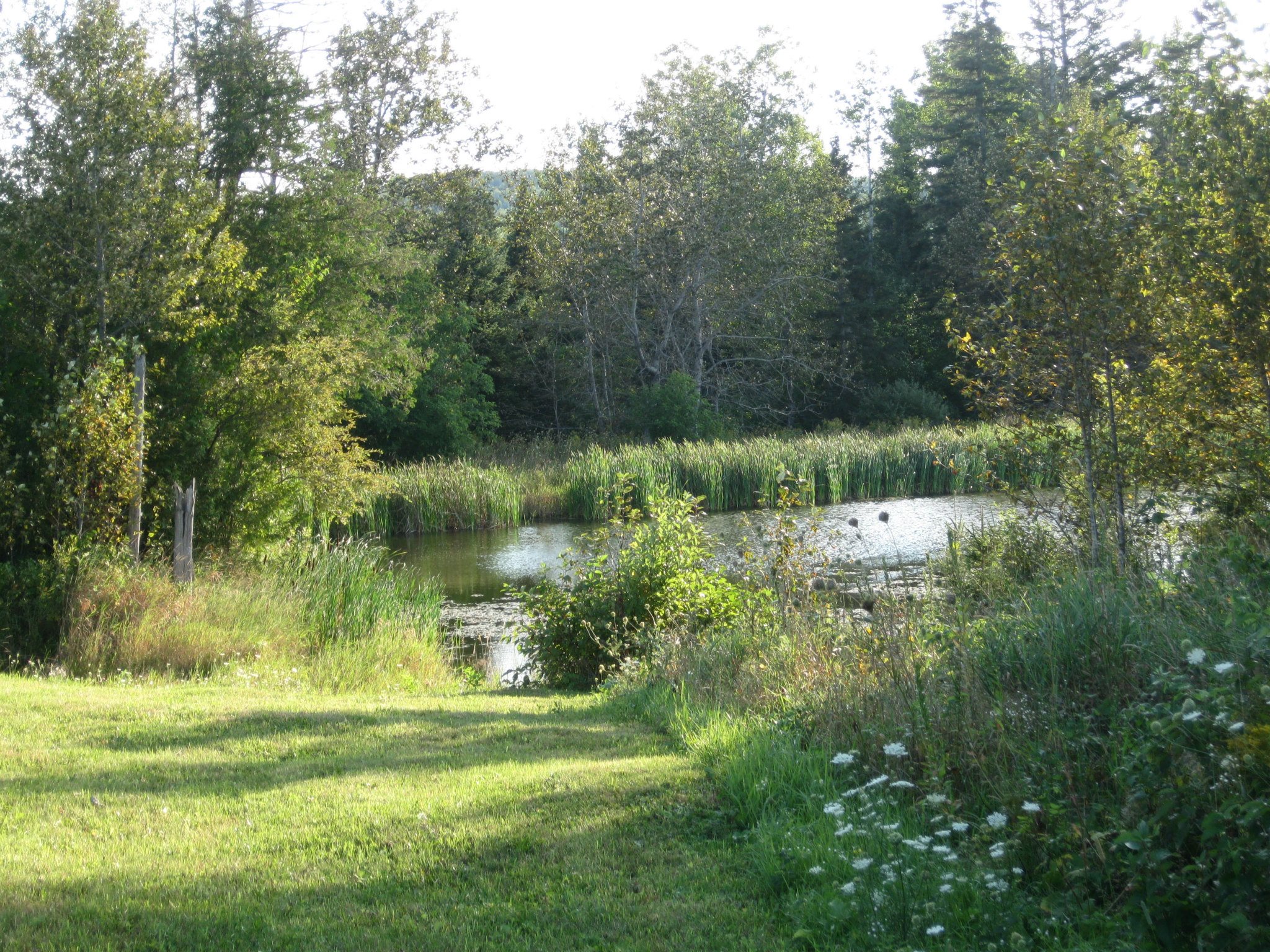

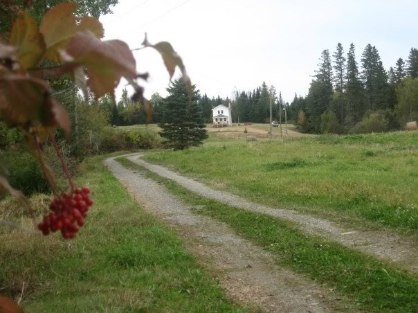

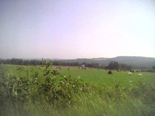

With apparently few takers, it's likely I'm going to need something to mow 50+ acres annually on an ongoing basis. After a time it may be that we'll put the fields back in the CRP where mowing is part of the terms and conditions. Which brings me to tractor HP. With that much grass, I think at a minimum I'm going to need a 7 or 8 foot cutter. After somewhat familiarizing myself with tractors and looking at three brands, JD, Kioti and Mahindra, I think I like the old school simple tractors best. To my mind the Mahindra 25 series fits the bill both for their price and relative simplicity. But I also like the 4WD feature as I think it should be especially useful for snow removal and work around the pond area. The 5510 may still be too small and the 5530 seems to be a more complex machine w/turbo and shuttle. Which brings me to the question, how important is 4WD? My neighbor owns most of the farmland surrounding me and he's suggesting I go with the 2WD. What say you? Here's some pics of the property:

You may want to price a 8ft cutter. (I assume you are talking about Bush Hog type brush cutters) They get pricey. You may want to ask about HP requirements. I think @ 45 PTO hp you will be underpowered. If its just grass and REAL light brush your cutting you might think about a 9ft sickle bar mower. They require much less HP and good used ones run around $1200. A 6ft rotary cutter could be used for everything else. 50 acres is a lot of cutting!!
"But I also like the 4WD feature as I think it should be especially useful for snow removal and work around the pond area."
Other than the price, there is nothing a 2wd will do better than 4wd. They are much safer with a loader. I don't think you mentioned a loader, but I think you will want one some day. They are by far the most usefull attachment you can have. When your in 4wd you also have 4 wheel brakes, which is good while working around wet areas, like ponds.
Happy hunting, Bill
   / 4025 4WD sliding or constant mesh transmission? #19
I say it is up to you no matter what, but I think the 4wd 4025 is the bang for the buck. Someone on here mentioned that they know of someone or themselves run a 7ft with 2sets of blades, gearboxes, etc. on a 2wd 4025 and it does better than a 6ft. Another thing is time. How much time do you have to maintain the 50 acres? More time less tractor, less time more tractor. As far as snow I dont deal with it down here. In fact I dont recall us getting anything that stayed on the ground for over an hour since the mid 80s, but I am in the sand and 4wd is almost a must. If you want a loader than I say 4wd is a must and I think it is something like 2wd with a loader is best over 60hp+ because it will be a more powerful heavier unit.
You know you want the 4wd 4025!...lol.

I really like the 25 series TBT. I'd be all over a 55/6525 4WD if they offered either. The sickle bar is a good idea. I understand they can be a bit more to maintain but perhaps not such a big deal...maybe a 6 foot rotary cutter to go around the rough areas as well. The last time the fields were cut it was done with a sickle bar.
The correlation between time and HP is a good one. I've got just over 6 years to retire if it all goes to plan. Hopefully I can get more seat time once I'm there.
