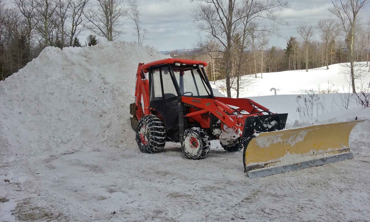

My sort of a solution. There are some ok soft cabs, but don't expect too much.
