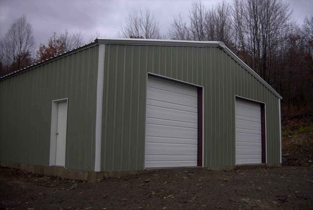

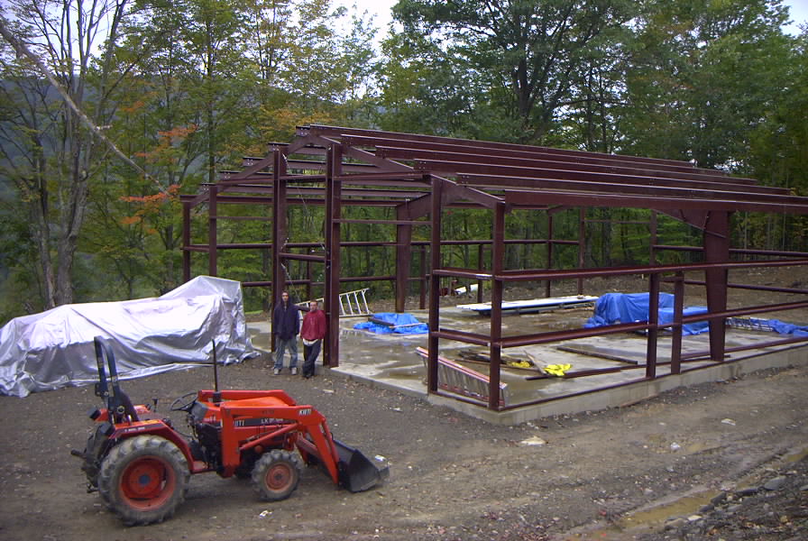

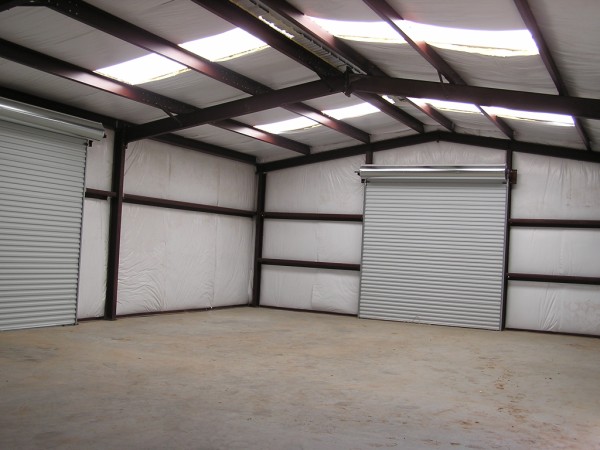

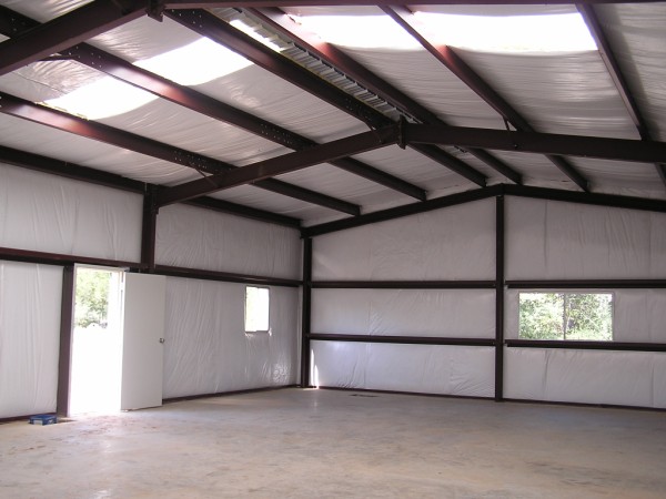

here's mine -- 30X50 x12 on 4" slab with #3 rebar on 12" ( #5 bar in the footers and berms) - 20x50 leanto attached w/no slab -- 2 10x10 rollup doors, 1 personnel door, 2 windows, insulated .... I didn't turn a hand -- $32,950 ...... I really wanted a 40x60 -- but it busted the budget. the leanto has sides added now - they weren't done in this pic................
edit .... added other side view ....
