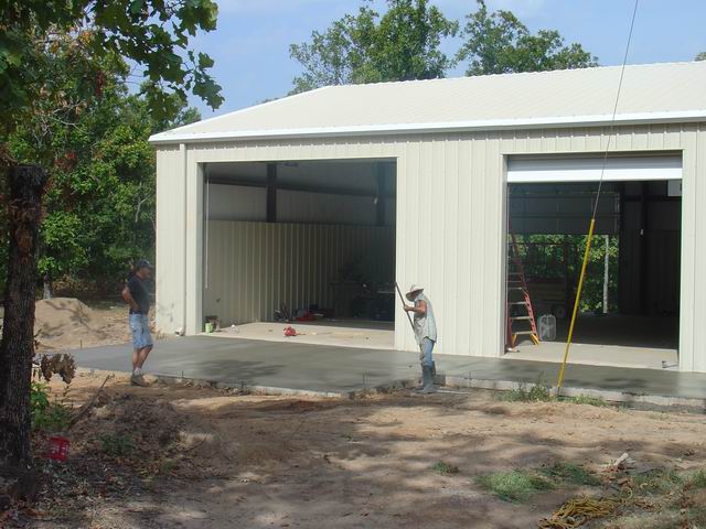

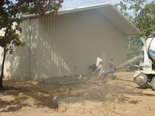

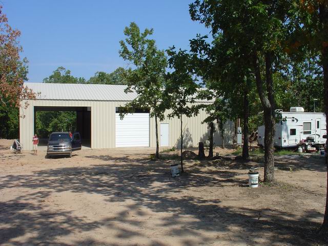

In June05 I had a steel frame building erected on a 24'x42' concrete pad, 3000psi concrete 6" thick with #4 rebar criss crossed on 24" centers. Wall height is 12 ft, roof is 2:12. Two 10'x10' rollup doors, one window, one 36" wide mandoor.
Building cost:$16,000 installed. Slab: $7500

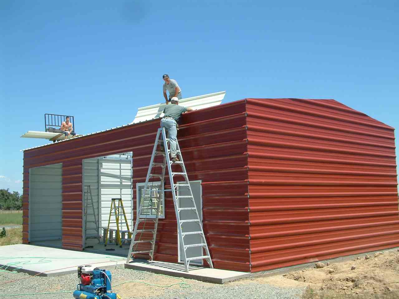

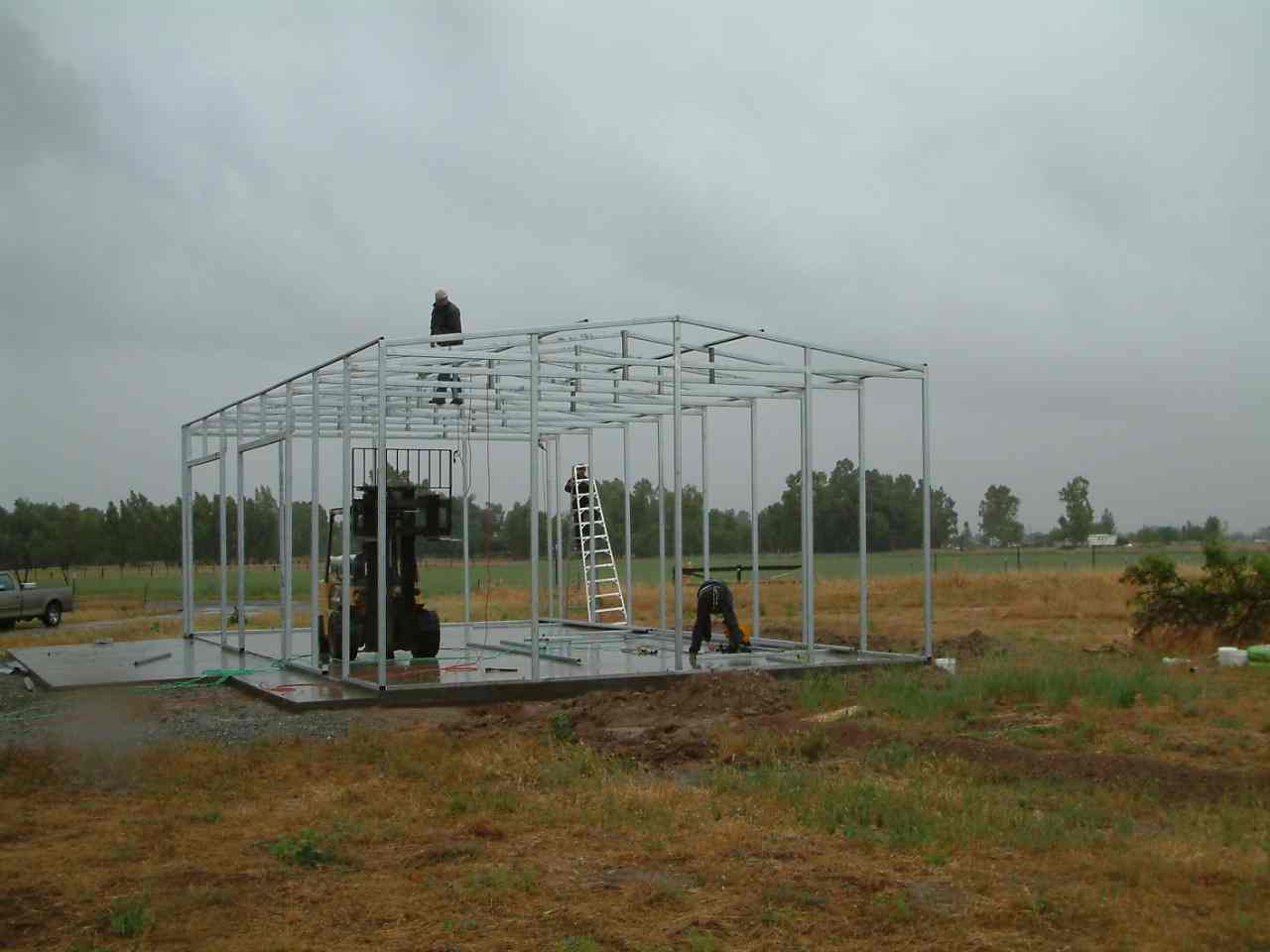

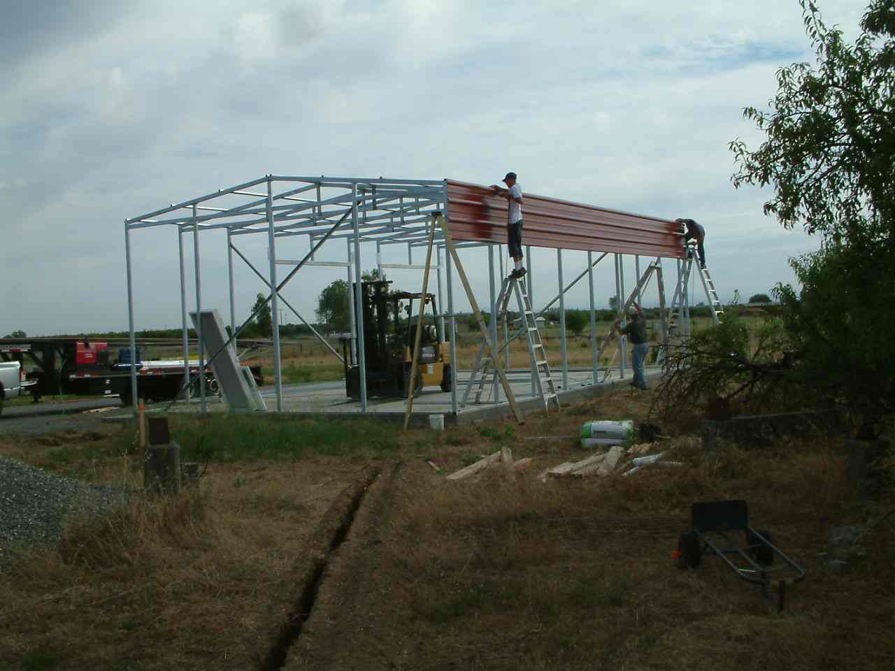

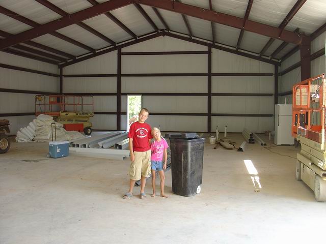

Attached are a few pics of the metal building we just finished and are building a 2-story lakehouse in one end. The total building is 50'x75' with 14' sidewalls, 3/12 pitch, heavy gauge metal, gutters, 4 small wall-lights, 5" concrete floor with 3'x3' rebar and fiber, 2 18'x12' overhead doors, 1 12'x12' overhead door, 2 walk-ins, 31/2" vinyl backed fiberglass insulation, 8' metal lining around the inside walls, approx 1,200 sq ft of concrete approaches and sidewalks. The building is a bolt-up, the overhead doors have commercial i think 4" rails or tracks and are insulated. Total cost labor and all was $70,000. That didn't include electrical which i did myself. The doors added a tremendous cost at approx $8,000 for the three of them but they are nice.
A bit about the house or living area in case someone is interested. We used about 40% of one end (30x50) to build the house. The stage we're at on it at the moment is the texture is done......flooring, trim, cabinets, paint and plumbing fixtures left. We were able to put 9' ceilings in the lower story and still had plenty of room upstairs where there are 2 bedrooms and baths up there. Our master is 400 sq ft , cathedral ceiling, with French Doors overlooking the place with a 6'x20' deck. (you can tell i'm excited....lol) We are very impressed that it's turning out as nice as it has inside a metal building!! We used 2x6 studs throughout and prob overkilled on insulation. The cool part is the outside part upstairs (where the ceiling is 7' or less) makes incredible storage areas and a lot of it. We've used every sq ft with a purpose. 4 bedrooms, 3 showers, 4 potty rooms in all. Maybe this info will help you or give you an idea.

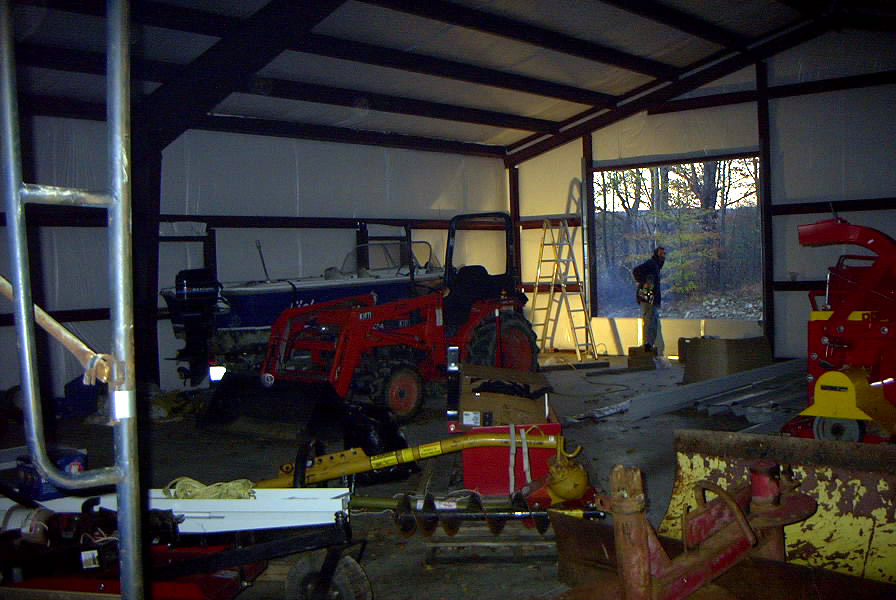

Keving, I have a 40x50x12 building. I have a (not quite installed yet) Bendpak lift, a car, two boats on trailers, my 30hp tractor, all the implements, shop, bench, welders, table & radial saws, drill presses, tons of hand & power tools, rolling tool crib, etc. and of course a water cooler/refrig since I'll be spending so much time there. Not a great picture attached, but it will give you some idea - still looks roomy.
Hate to burst your bubble, but I would be amazed if you could get much done for only $25k. My excavation, foundation & backfill cost me close to that. Perhaps you might consider putting up a pole building with a gravel floor to keep costs down. You can pour a concrete floor sometime down the road (perhaps when you hit Lotto :D). Most of the posters who provided costs are way above your number and as kmdigital pointed out, steel prices have gone through the roof. Good luck and keep us "posted".
