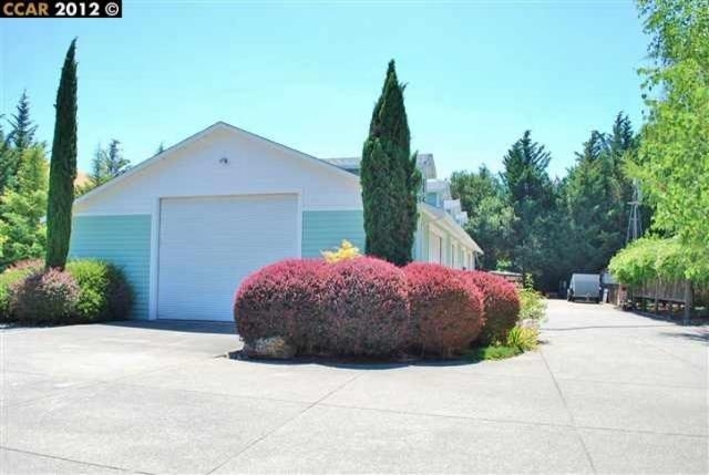

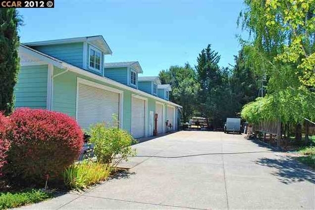

40x96 hits the sweet spot for me…
   / 40x60 pole barn advice #13
Yes… Castro Valley on 5 acres with city water and fire hydrant.
it’s the one that got away in 2012… the property that checked all the the boxes and I made full price non contingent offer only subject to survey but the seller had accepted a 50k less offer earlier that day… for 6 weeks I was in back up position.
I keep in touch with the buyer but he says never going to leave… make a deal with my widow.
