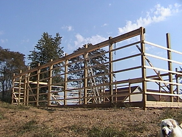

This is the front of the building with the walkin door and window, can't see window yet, and two 10'tall by 14' wide overhead doors.
I will try to keep updating with pictures.

Another shot of the front. The front faces the East.

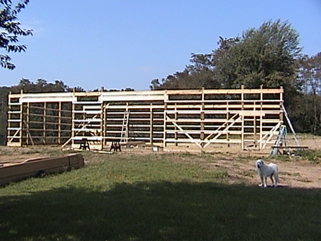

This is the South side. It will have one window in it.

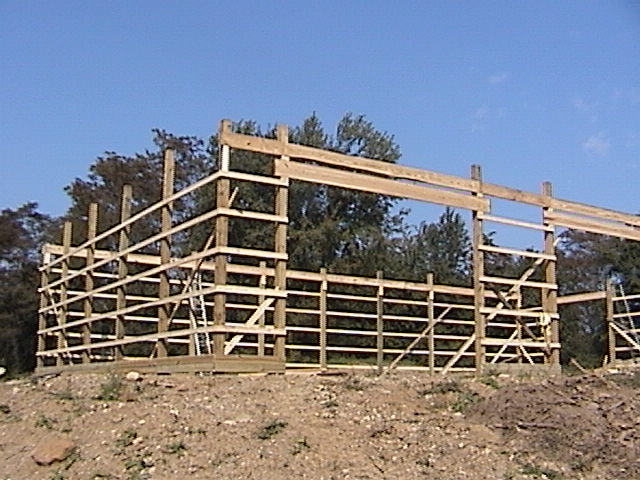

This is the back side. It will have 2 windows. This side faces the West.

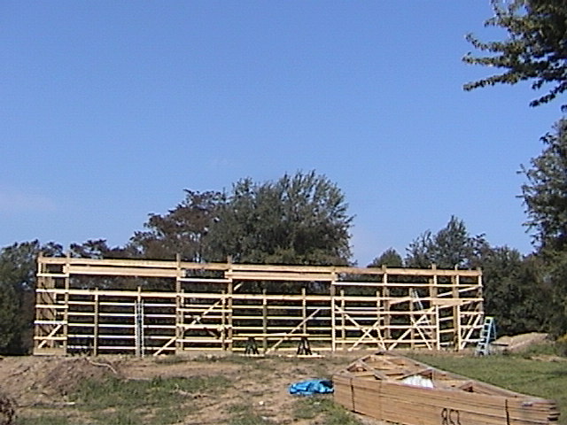

This is the North side. It has 1 window and a 10'x10' overhead door.

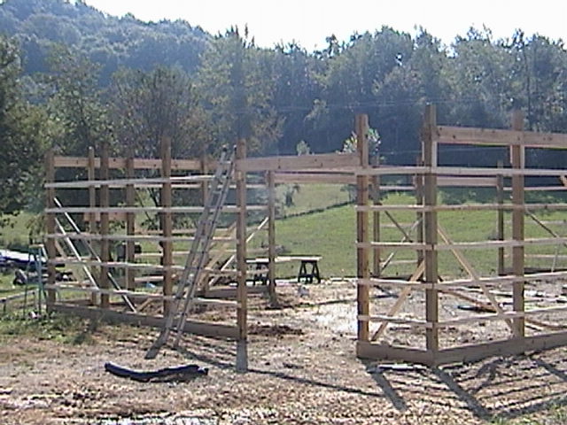

Would you mind sharing what kind of foundation you set for the barn? I'm considering building one, and don't particularly want to set in a 4' deep frost wall (like is done for real buildings here in Massachusetts).
   / 40'x64'x12' Pole Barn
Re: 40\'x64\'x12\' Pole Barn
Bebster,
I had a dozer come in and level out a spot. Soil looks like bank run. The dozer piled up all the dirt in one spot for me to use later.
My holes are all about 36" to 42" deep with concrete in the bottom. Set the 6x6 post in them, filled with dirt/bank run and stomped down. I attached "lock blocks" to the bottom of the 6x6's to help keep them locked in the ground.
