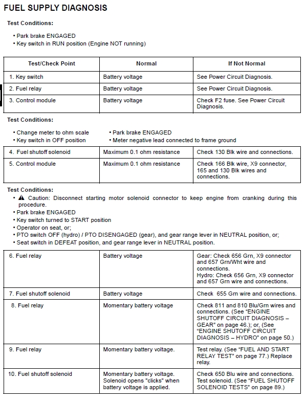

Hi,
I have a problem with my 4100 hydro and was hoping someone on here might be able to help.
For reasons I wont get into I was running with a dead battery that would not take a charge. I jumped it and was running it for about 30 minutes or so that then it died on me like the key was turned off. I put it in neutral and jump started it again but when I put it in gear it died, even though I was on the seat. I started again, got off, lifted the seat and manually pushed the safety switch under the seat and then put it in gear and it immediately died. I restarted and then heard a hissing noise and smoke poured out from under the tractor and it smelled of electrical stuff burning.
I shut off and stepped back, looking for flames and when I didn't see any and the smoke cleared I popped the hood and took off the side panel and could see the end of the fuel shutoff solenoid was melted. I touched it and blistered my finger it was so hot.
Obviously I need a new solenoid but I'm wondering what might have caused this. Is this a symptom of a bigger issue?
Could it be related to running it with the bad battery?
At $180 a pop for a new solenoid I don't want to just replace and fry the new one if there is an underlying problem. How should I go about diagnosing if there are other problems? If it were just a bad solenoid I suspect the first symptom would not have been it dying and then starting again but dying when put in gear...
Any help is greatly appreciated.
Thanks,
HD
   / 4100 Fried Fuel Shutoff Solenoid #2

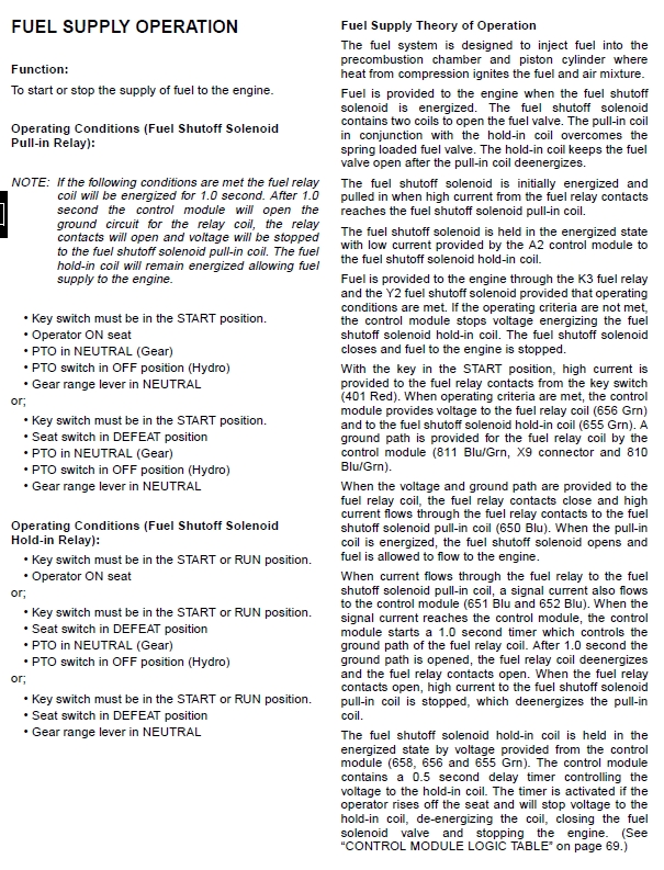

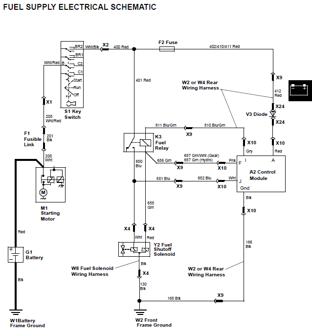

Sounds like the high current pull-in coil in the solenoid had continuous power. That would burn up the coil. Could also be what ran down your battery. Control Module A2 should normally activate the coil for just one second. I would start with A2. Some data is attached, but basically you can put a voltmeter on the wire for the pull-in coil and look for 12 volts to be there for just one second when you turn the key to start.
Edit: After analyzing the circuit, it could also be the contacts of Relay K3 have welded shut with the high current. This would be cheaper than a new A2 and more likely.

Thanks a lot JD755 that's awesome. Are the images from the 4100 technical manual?

Yes, the images are from the 4100 technical manual. Good luck on your repair efforts.

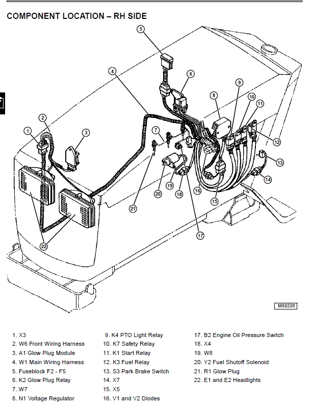

I was going through some of the test and realized I'm guessing on some steps. For example, it has me checking the fuel relay but I'm not 100% sure which this is. I tried tracing wires and I think I found it but was wondering if you could confirm.
I have the plastic panel off under the instrument panel and I'm looking at what look like 4 relays lined up at the bottom. I think it's the 1st on the left?

Looks like K3 Fuel Relay (12) is toward the rear. From your viewing angle that could be the left?

Thanks a ton for the diagram. I've got to get a tech manual! Yes, K3 is the one I thought. I found out that the pull circuit for the solenoid is hot all the time when the key is in the run position which is what burned up my solenoid. Hopefully it's this relay and not the control module that is the problem. Looking at the cost of the control module, I was thinking about rewiring the pull circuit to the starter solenoid. This way it would be energized when I hit the starter, serving the same purpose as the control module.

JD has used different methods to momentarily activate the solenoid. Control modules, thermistors, and (what I like best) just connecting it to the starter. That is how my 755 is done and is what you are contemplating. I never knew why they got away from the simplicity of that method. Nothing to go wrong, and very reliable.
If you make the change because the module is bad, check its other functions also. It has inputs from safety switches and the "bounce off seat" time delay that still need to work.
