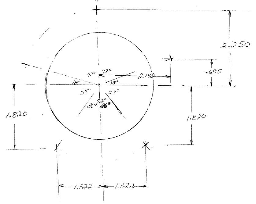

DSMAU,
I just sent you a PM. I just picked up a set of front 4100 rims with R4 from the local salvage yard for my 855. Could you shoot me the bolt pattern for the front and how you made the pattern work? I have ag tires and rims so I dont have the option of putting the R4 on turf rims. Thanks
   / 4100 R4 on my 855 ?
#12
Here it is. I hope the scan is clear enough to read and is helpful for you.
