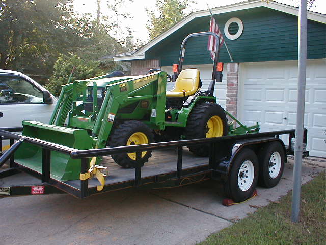

OK, I'm new here and all, but I just had to show ya'll a pic of my new baby. 4110 HST, 410 FEL and 413 cutter. Just put 3 hours on it yesterday and happy as a pig in #%@*. Thanks for all the great info and keep up all the good posts

Nice looking package you have there,and may many more hours enjoyment to come for you. /w3tcompact/icons/smile.gif

Looks a lot like the 4100 I bought this Spring. I have the same loader and cutter and they work great!
A suggestion if I may?
Install some tie down rings on your trailer! I noticed that you have your rachet strap looped around a trailer upright. That can weaken your straps in no time at all.

IRTEXN,
Since GaryM is probably out on his tractor, what do you mean about those tie downs? That's how I do 'em too, except they are attached to metal loops level with the platform of the tractor.

As Buick pointed out, I would weld some "upside-down" U shaped 3/8" (or something close to that size) round steel to the wide side (vertical side) of the trailer's channel to tie to ... you will find them helpful for many things ... I would put at least one per each open area between the vertical side rail supports of the sides ... you could skip where the wheel farings are ...

Gary, Buck and EM,
Thanks for the suggestion on the tie down rings. I have a buddy with a welder and a TSC close by. Sounds like an easy fix

I also have the Deere 4110 with the 410 FEL and a handful of attachments and I'm starting to look at trailers. Can you tell me what size trailer is shown in your photo? I'm leaning toward a 6'10" x 18' 7000lb unit.

Heath, I haul my 4100 with loader and attachments on a 16' dual axle trailer. Not alot of extra length, but everything does fit inside.

I use a double axle 18' trailer with a 2' dovetail as part of the 18'. I have four tiedown rings and will add more soon.
The 4100, 410 loader, and 413 cutter fit with about 1 1/2' to spare. This lets me move fore and aft to adjust hitch weight.
I have electric brakes on one axle, should have gone for brakes on two axles. Trailer GVW is 7500 lbs.
