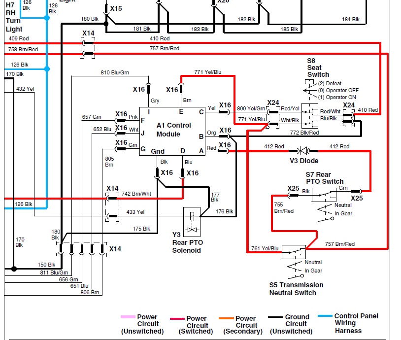

I'd probably start tracing through the safety switch circuits. If you have the schematic, find the first one in the chain and use a test light to verify 12v at each subsequent point. If not you can pull each of the connectors apart and check that the switch is closing with a multimeter.
Also make sure the keyswitch is providing 12v when in the "crank" position.

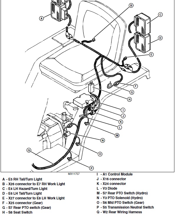

Found this pic in the service tech manual (my 4300 manual had the 4110 too), and think it will help you find that switch.. looks to be left side under left foot rest or thereabouts as item P.
I added the wiring schematic that involves the wires to the S5 neutral switch, so you can see where they lead into the A1 control module that I believe is located near this switch.

The verdict is in. It is the safety cutoff module located under the seat. Appears that current goes in but doesn't come out. So they are replacing the module -- a simple task but a pretty expensive part. Also, having been five years since it went into the shop, it is a good time to get things checked over like the coolant, filters, oil, et al. It has really low hours but age has a way of degrading some things regardless of usage. Glad to be able to put this behind me and get back to moving stuff around on the property.
