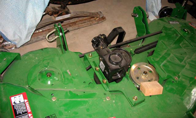

on Al3 's picture, he has the loader frames on
his tractor.. that is what the part number 12 is for,
it's a spacer to take up that space if there is no
loader frames mounted.

GREAT PICTURES!!! Yes I must agree I have the wrong bracket for some reason. Deere want $50 for it. So I cut the 3/4 rod in half. Then latheds off the weld. I then pressed out the remaining welded 3/4 rod and filled in the 2 wholes on each bracket with weld. I will now lay it out and redo the 3/4 whole spacing to 4-5/8.
I also had to order the left side bracket that looks like your second picture. The only differance is mine bolt to the trany block and doesnt require nuts on the back.

Do you have any additional pictures of your 4110 deck that you could post. I have a 4010 deck which I am trying to mount on my 4110 tractor. The 4010 and 4110/4115 decks are different in terms of rear connection points/brackets. I am looking for a good set of 4110 deck close-up pics to locate exact points on rear of deck for alterations (Local JD dealer suggesting re-welding rear deck connection points) so 4110 connecting hardware can be utilized. Before turning dealer loose, I would like to confirm deck alteration is doable - thanks

Here are two shots: first one is wider perspective shot from the front side. Second focuses on the rear mounts.
Pardon the dust---deck has never been used.

Pic # 2. Are you looking for some specific perspective? Good luck.
