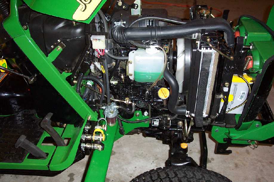

Well, I'll throw my $ 0.03 in: I think you are smelling exhaust and un-burned diesel from the temporary lugging of your engine as others have suggested. I smell it too, and it is distinctive from exhaust from a normaly firing diesel engine. It's the timing of the odor that makes me say this. I cannot, for the life of me, figure out what rubber would burn only during that brief lugging or strain. The odor I smell is kind of a sickly-sweet smell I could categorize as being in the same smell spectrum as rubber. I just throughly serviced and detailed my 4110 today, engine compartment and all. Everything is PERFECT /forums/images/graemlins/cool.gif No burning rubber there.
