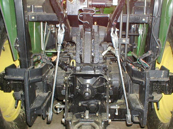

Well, the dealer brought back the tractor with the belly mounted mower. I was very discouraged. The unit is raised up with a convoluted system of hinges and hardware. It will be very difficult to fully use the 3 pt with all that hardware. I am going to take the darn thing off and build my own lift kit. If I had to do over again, I don't think I would use the belly mower.

I had to build a subframe for my backhoe and I decided to get rid of the MMM linkage mechanism. Here is a photo of what I did and it works well. Mowed about 15 acres worth and it does a good job of setting the deck each time.
Scott

   / 4120 and Belly Mower #18
Did you have to get rid of that mid mount mower linkage to use the backhoe? I know your deck uses the same lift system as my 970 and now 990 which I just done installing the 3 point linkage on. If your worried about mower deck removal, the arms on the 3 point to raise and lower the mower are more or less permanant once they are installed. The lift links can be removed by un clipping the circular rings where they connect to the 2 slides on the 3 point arms. And the deck comes off in a matter of minutes. I am just curious as to why you removed the system since it is quite expensive.

Hi Yellowsocks,
No, I did not have to get rid of the linkage to mount the bh. I got rid of it because it limited the 3pt range and use. Since I had to build a frame anyway for the bh, I decided to make a system that would give me greater use of the 3pt.
