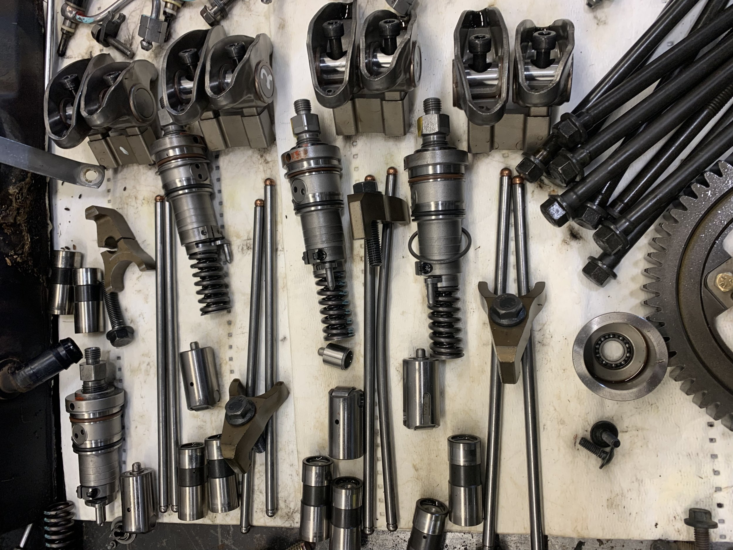

A follow up. After several attempts to find and clean the return line, I called a friend for help. He's an experienced operator/mechanic for heavy equipment and a willing helper. We played around and determined that we could make fuel exit the bleeder valve over the fuel filter but could not get anything from the fuel pump to the filter when we used the key and cranked it over. Now convinced that we had a bad fuel pump, we proceeded to remove it. After doing so, we pushed the plunger down on the pump by hand and it did push fuel. At that point Darol said, let me look in the opening where the fuel pump sits while you crank it. Ouch. The crankshaft (camshaft?) wasn't turning. Which means the pump wasn't operating, which means (or could mean) some very bad things. Like a broken timing chain (if there is one instead of a belt or gears) or a broken shaft. Ouch, ouch. The local JD dealer is coming to pick it up this coming Tuesday. I might be picking up returnables by the side of the road on Wednesday to pay for it.

Just got the bad news. The bolt holding the camshaft came loose and backed out. With damage to other parts, replacement parts, outside testing of the head unit, and labor the dealer is estimating around $10K to fix it. This is very unexpected and to be honest, disappointing. I’ve always been so confident in my choice of John Deere and remember feeling that even though the initial cost of the tractor was high, it would last for my lifetime. I have no choice but to fix it and have given the go ahead for the repair. But to put it plainly, it sucks.

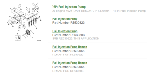

   / 4120 fuel return line location #15
After writing this earlier I thought of the same thing myself. Not sure how feasible it is since JD no longer makes the engine. But I intend to find out. Thanks for suggesting it.
They still have the complete replacement engines on JD Parts. I just looked it up and they are available at the factory for the dealer to order. 10,000 and some change. I would lean toward a new engine, but total cost would be higher since there would still be quite a bit of labor to install the new engine.
Yes. Engine alone is more than than parts and labor to repair the existing engine. I’m waiting for the test results on the head to make the final decision but I’m leaning towards repair of existing instead of remove and replace. Thanks though.

Tractor is back home again after an engine rebuild. My wallet is gasping. So far so good But haven’t had much opportunity to run it. I know sh#t happens, but the failure of such a key component (the bolt holding the cam in place) has left me with a damaged opinion of Deere’s build quality. I know, there are millions of examples to the contrary. But my experience has left me a little shocked. I figured the tractor would have outlived me. It might now I suppose, but only after some very costly maintenance. Ah well, onward. Time to put the chains on.
