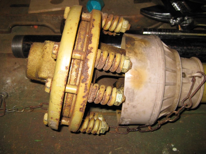

Well, I took the clutch completely apart today. I wire brushed the clutch disks and plates. The mower has been unused and in (indoor) storage for a long time so the clutch plates were somewhat pitted and sticking. I ran the mower with the spring pressure almost completely out for a while and it still continued to mow, unbelievably. I actually liked using it better with the clutch pressure backed off because it doesn't surge the tractor upon PTO engagement like it does wiith the clutch adjusted to spec but I'll see if it loosens up with ongoing use.
I suppose that is a question I might pose. Should the clutch be slipping upon initial PTO engagement or is it only there for object strikes? I'd really like to loosen it up and let it slip a bit at first. It really makes a **** of a noise and a rumble. I'm just afraid that if it isn't meant to be used that way I'll wear the clutch out prematurely.
Anyway, I got it all up to snuff and gave it a try. Check it out. It sure is a challenge keeping the height happy on uneven terrain. It would seem a set of wheels at the front of the mower would be helpful for this problem.

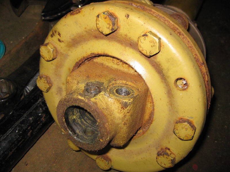

Yes, I usually use 1500 as my engagement speed for attachments. 1500 seemed a little jarring on the tractor. I found 2000 to be too aggressive but 1700 to be just about right. Still, I'm a little concerned. Along with the clutch, there is also a shear bolt between the clutch and the gearbox (see images for clarification). I took it out yesterday (to get the clutch out) and it was a little distorted. It would seem to me that the clutch should be slipping a little to protect that bolt. That sure is a lot of mass working against both that shear bolt and the PTO system on the tractor. I'd rather replace a clutch disk than anything else.

The cutter's clutch shouldn't slip during PTO engagement. Certainly not enough that you can tell at least. I could see it maybe slipping a few degrees (maybe 1/4" if you marked the plates) but that would be it. The modulation of the tractor's PTO system is enough to protect the system from damage upon engagement.
Slip clutch drivelines are designed for people that cut rough areas (read: stumps) where shearbolts would repeatedly fail. On a 413 a shearbolt driveline is standard, with a clutch driveline being an option. Replacing bolts is a real pain in these conditions, so the clutch serves basically as a "auto resetting" shearbolt. That shearbolt that you have in the system is basically a second level of protection.
Like you are doing, it's a good idea to slip the clutch at lease once per year and make sure any shearbolt areas have not rusted solid (i.e. remove shearbolt and let it spin a couple revolutions).

Otherwise, I'd back the clutch nuts off by some known amount, i.e., 1/4 turn, 1/2 turn, etc until you get some slippage. Slip it a few times to loosen it up, then tighten it back to where it was.
