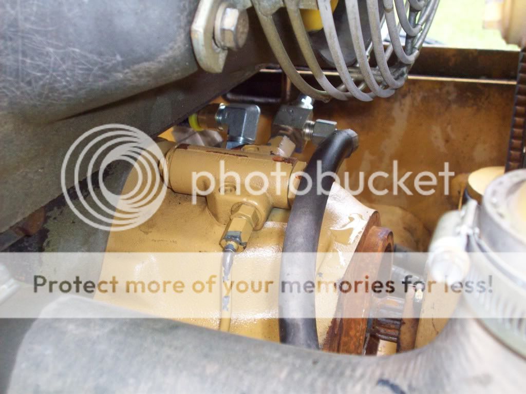

Can you add pics of valve?

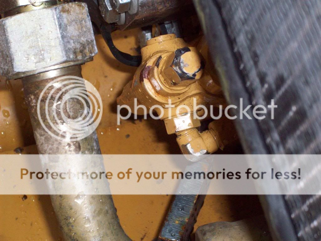

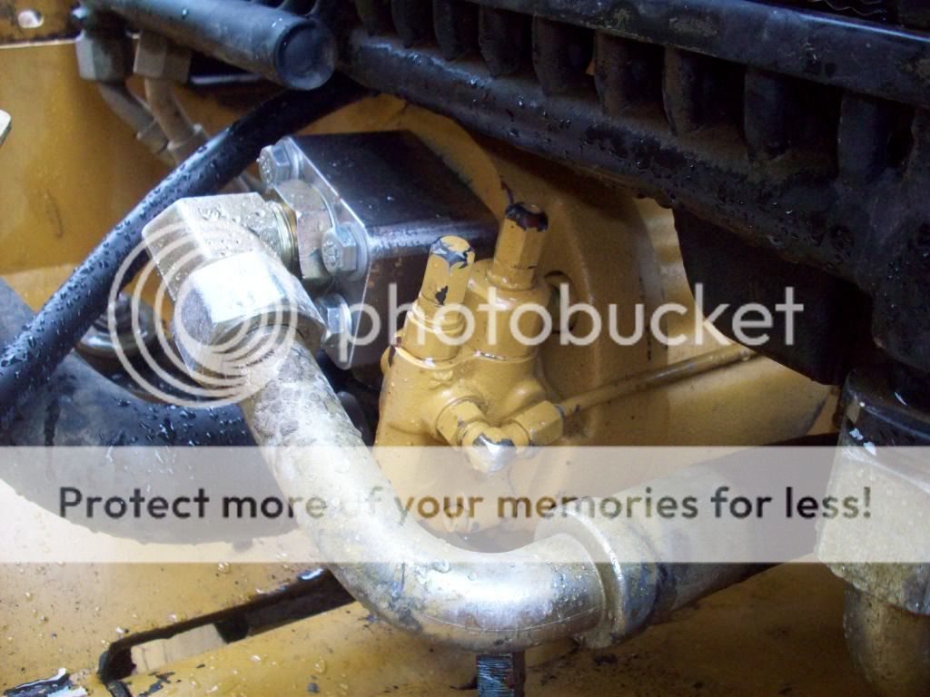

2nd pic. This valve has a few different names depending on what machine they are. Pressure Compensator valve, DR/FR valve, plus many others, however they are all the same. They are all plumbed up differently depending on how the manufacturer wants his Pump management system to work.
The rear valve of this pic, is what sets your maximum system pressure, about 3000PSI.
The front valve is your minimum pressure, which could be set around 300 PSI.
Now the pipe going into the front of the valves is hyd pressure from the system. Now depending on how much pressure there is, will determine your system pressure.
Eg. If that small hydraulic line has 1500PSI in it, then add 300 PSI (minimum pressure set with spring pressure ), then the system pressure will be 1800PSI .
Therefore they system pressure can be set anywhere between 300PSI and 3000 PSI.
1st Pic: So what I have just said about the 1st pic, then I will take a guess and say its a regulator or a flow restrictor. Thinking more a regulator.
Ok why differnent pressure's? Im thinking it could be for starting up.
The pump has spring in it so that the pump is in the fully swashed position ( Swash plate is at full angle therefore pistons will be moving full stroke- ie Full flow ).
So poor old starter motor on the engine when cranking the engine over also is turning the pump over when its at full stroke trying to get the system to 3000PSI before the swashing back to a no flow position.
Therefore starting speed is going to be very slow and will eventually burn out motors.
So if the pressure is very low on start up ( 300 PSI ), the pressure will be met very quickly, and the the pump will swash back to a NO flow position, and the starter motor will be able to turn the engine over a lot quicker !
Now when you go to operate your hydraulic system, you then provide 300 PSI on top of the set low pressure (300PSI spring pressure ) therefore the system pressure will be 600 PSI, then 600 PSI on top of 300 PSI you will get 900 PSI now this will keep going until it gets to the maximum set working pressure of 3000PSI ( very quickly ! ).
