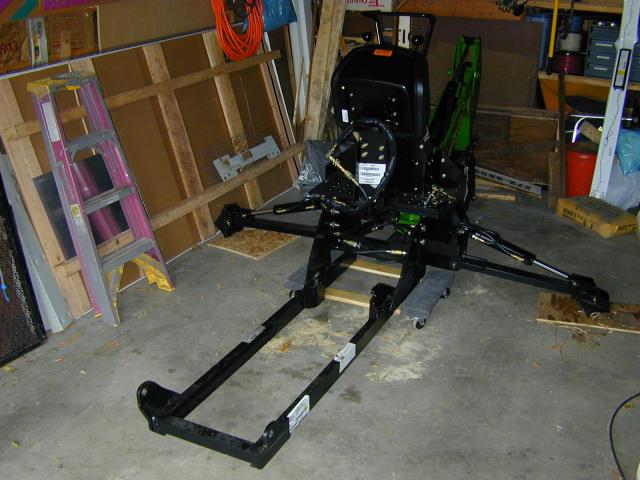

Being a subframe unit, the 46 takes more room to store as the entire frame is removed with the backhoe. The only thing that remains is two small brackets on the loader mounting arms which do to interfere with MMM operation.
Attached is the hoe off the tractor.

<font color="green"> which do to interfere with MMM operation </font>
Looks like some grammar mistakes, so do these brackets(the ones on the loader frame brackets) get in the way of the MMM?
