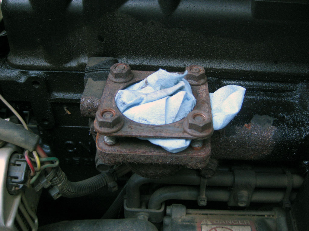

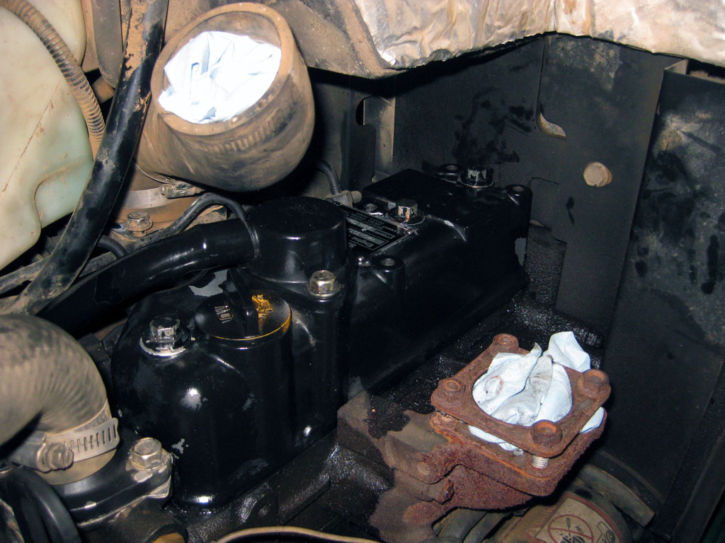

First the muffler need to be removed. Four bolts. I stuffed a paper towel into the hole and sealed it with the gasket and nuts. Don't want anything getting in there while you're working.

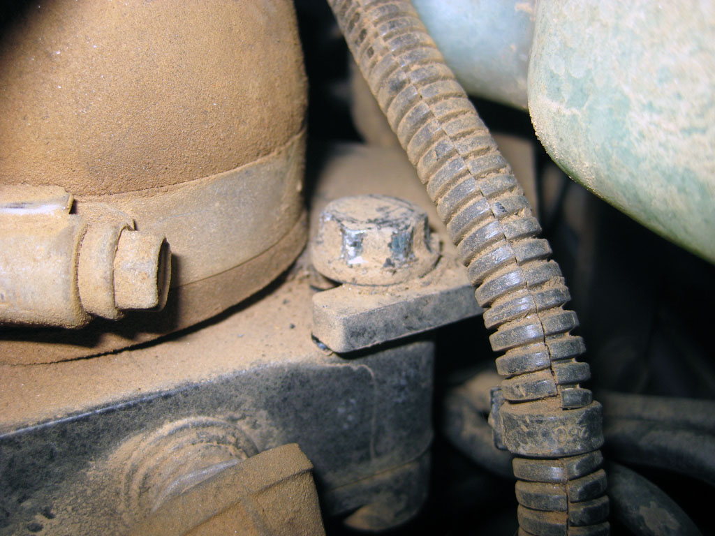

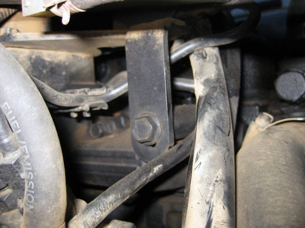

Then the airbox comes out. Three bolts and a hose clamp. You need to loosen the two bracket bolts that attached the box to the engine air intake. They don't need to be removed as the airbox bracket just slides under them. The third bolt needs to be removed completely. The hose clamp that connects to the engine air intake needs to be loosened to get the airbox out. Stuff a rag into that hose too to prevent contamination. When everything is loose, wiggle the airbox out.

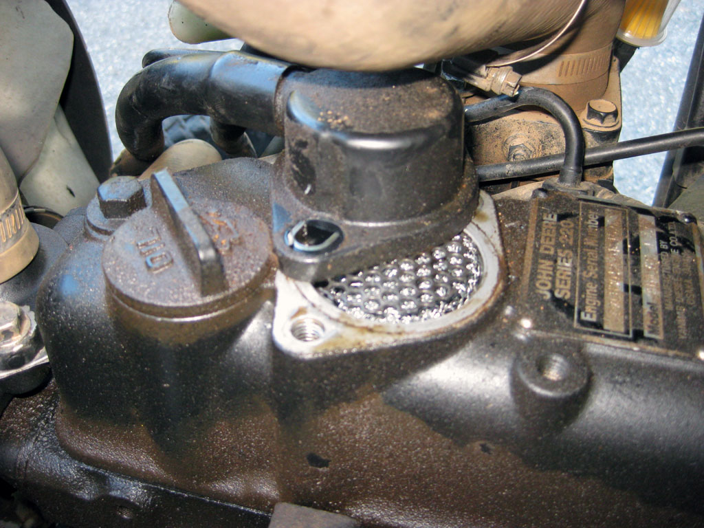

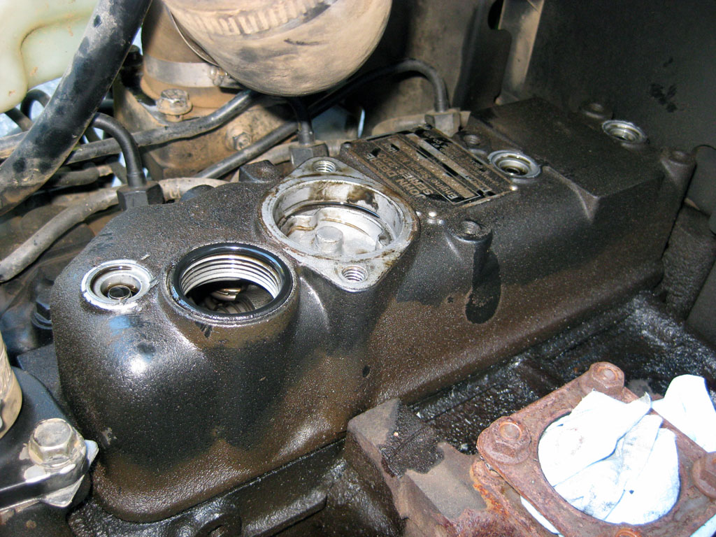

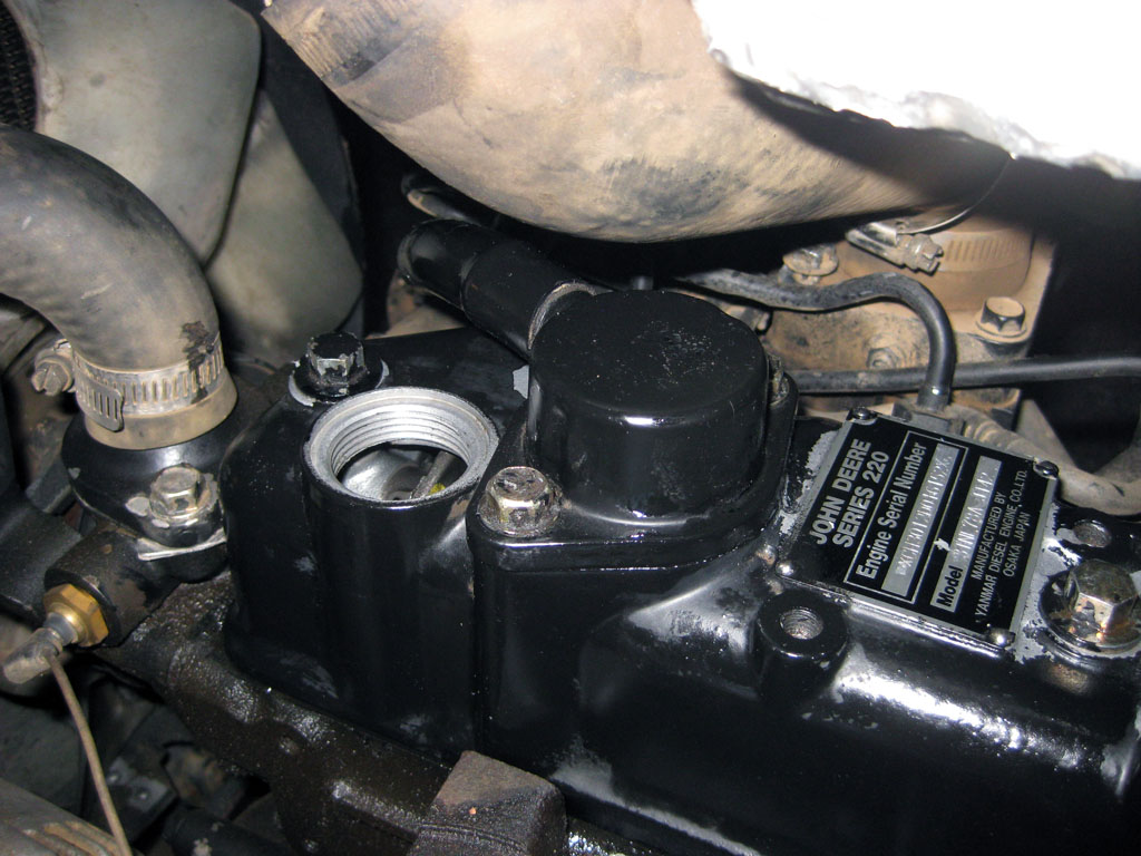

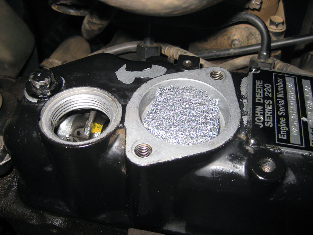

Next you remove the breather cap. Two bolts. You can see the breather plate and the breather baffle under that. There was a lot of oil under the cap o-ring. The o-ring was shot. Good clue as to why there might be a leak.

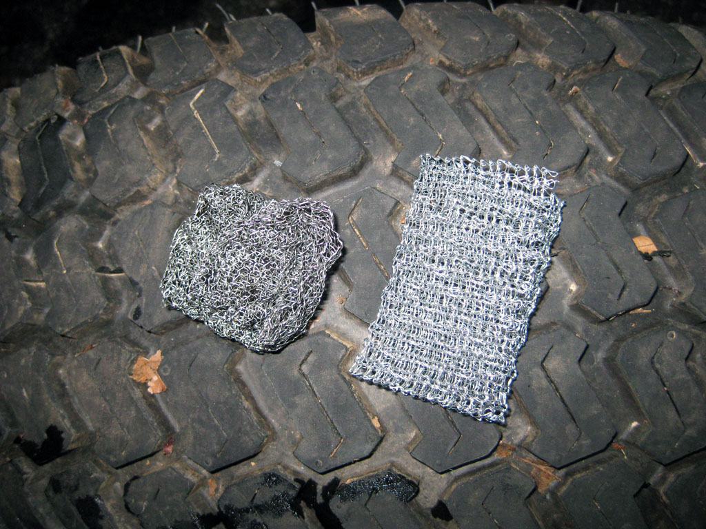

The breather baffle (the Brillo pad type stuff) was also poorly installed. Part of the hole down to the engine was open. Another good sign as to where the leak is coming from.
Next I removed the oil cap and the three valve cover bolts. The valve cover bolt o-rings were also shot. Wow, maybe its leaking from multiple places.

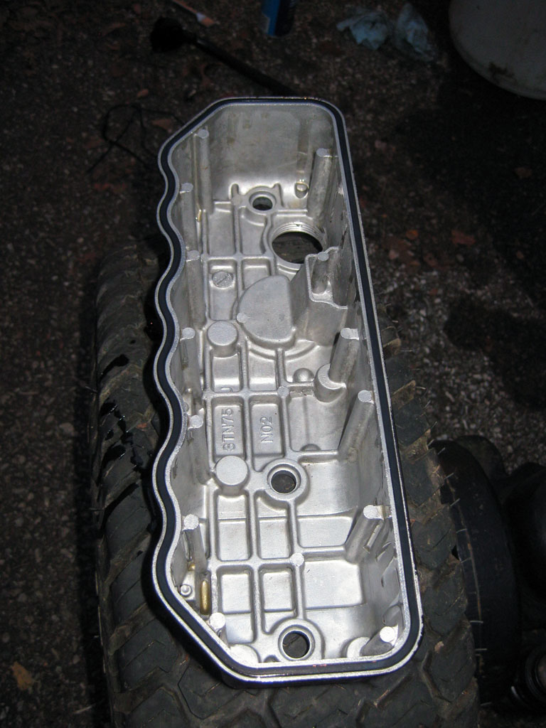

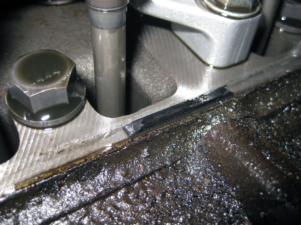

The valve cover comes off next. Lift up and out. I had to smack it lightly with a rubber mallet to make it unseal from the head.
You can see how the valve cover gasket didn't come off cleanly. The valve cover gasket was also shot. Anyone noticing a theme here? It looks like it was leaking at the back of the engine for sure. Getting happier I started on this project at this point.

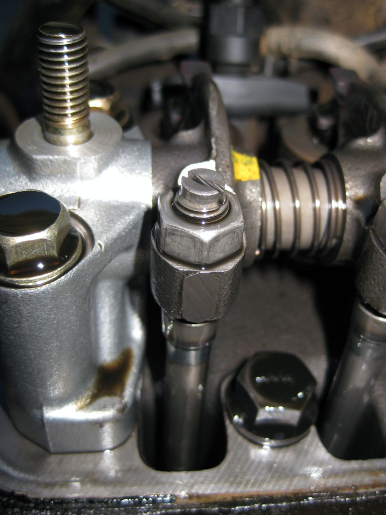

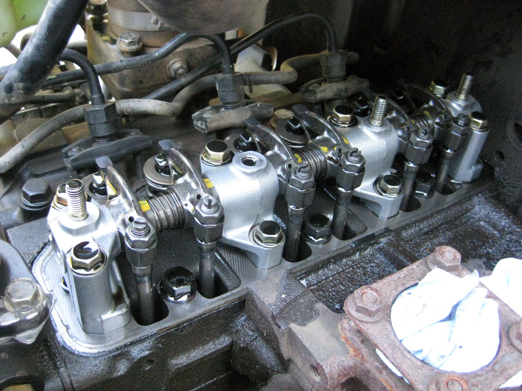

You can see the valves and rockers with the cover removed. Two per cylinder, six total. You can also see the flat head stud that gets adjusted and the nut that holds the adjustment. You can also see the rocker and the valve seat where the clearance is set.
All six clearances were too loose on my engine. 0.006-0.010" is spec. Mine were all 0.013-0.015".

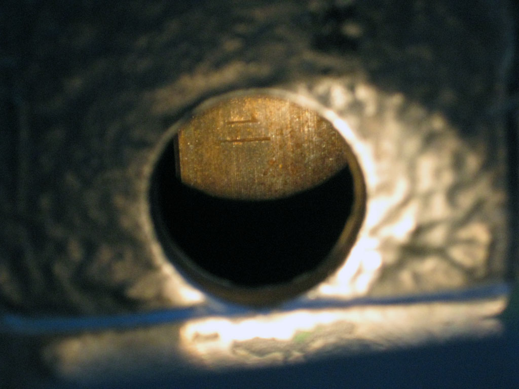

Now we need to find Top Dead Center for cylinder 1 and adjust the valves. Cylinder 1 is towards the rear of the tractor. Cylinder 3 is at the front. The valves are adjusted in the order 1, 3, 2.

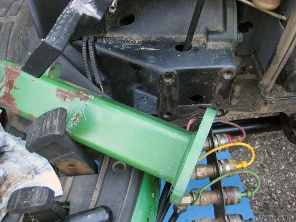

To set TDC on cylinder 1, you rotate the flywheel until the inspection hole shows the "1" mark lined up with the mark on the transmission tunnel. You're supposed to rotate the engine by the crank pulley bolt with a 17mm socket. First problem with the instructions: my nut was 19mm. Second, everything is in the way of making this happen easily. So I just pushed on the fan to rotate the engine. Surprisingly that worked like a charm.

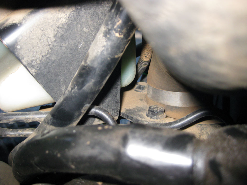

Now can anyone guess where the inspection hole is? It only took me an hour to find it. From under the tractor you can see a hole that looks like it would line up perfectly with the flywheel so you can see easily. But the hole is covered by a loader mounting frame. Well, that doesn't change the fact that its the flywheel inspection hole!!! So off comes the loader mount. So glad that turned out to be it!
Second problem with the instructions: they mention a mark on the transmission tunnel. There is no mark! Like the picture shows, you line up the "1" mark with the center of the hole. Oooh, precision.

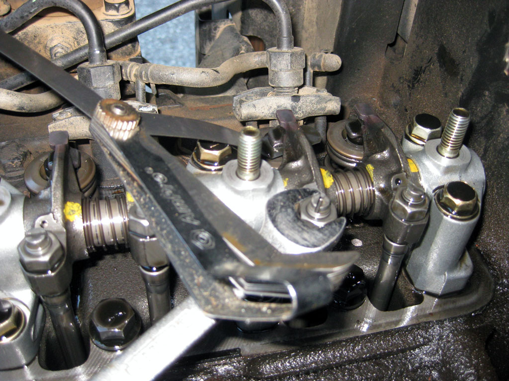

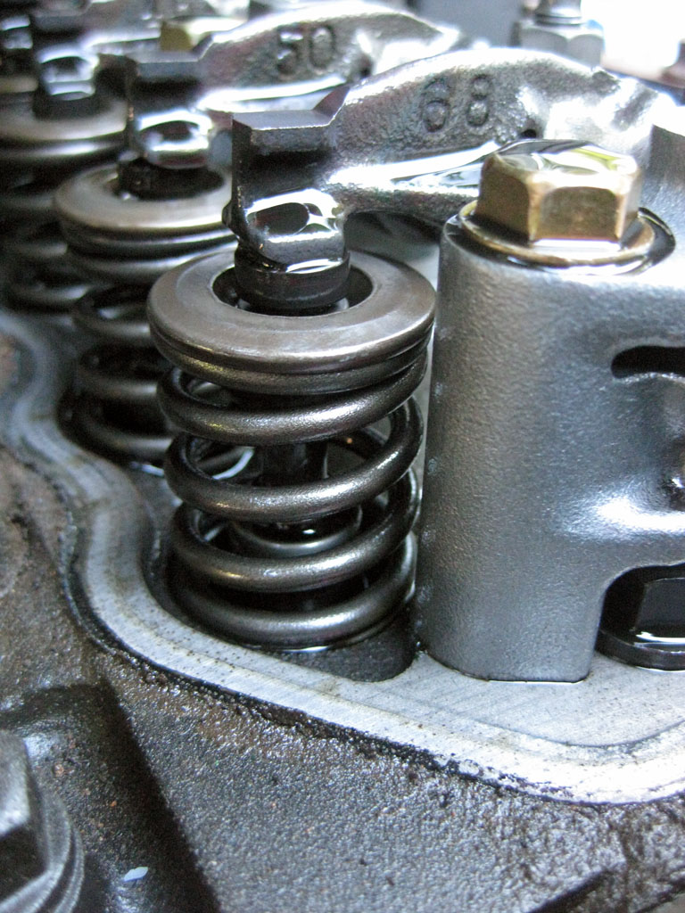

At this point you adjust the valve clearance. I used 0.008" as the spec. Why? My feeler gauge has 0.008" and 0.010" and I wanted them as tight as possible.
First you loosen the nut with a wrench. Third problem with the instructions: they tell you the nut is 10mm, mine were 12mm.
Then you loosen the stud with the flathead screwdriver top. They tell you to use a flathead screwdriver. I always use my fingers. It shouldn't be tight at all. Loosen the stud very, very little. Just to make it so the stud and nut will move independently of each other. If you loosen it too much, you'll need to check the valve seat (which you should actually do anyway) because it will almost certainly come out of position.
Slide the feeler gauge in between the rocker arm and the valve cap and tighten the stud until the feeler is in there really tight but still moveable. If you're using 0.006" then you want a slightly loose fit. Then tighten the nut but not all the way. Slide the feeler gauge in and out and be confident its at the right setting. Readjust if necessary. With the feeler gauge still in place (this is important so the stud doesn't move), tighten the nut completely. Check again that the clearance is right. Check the next size up to make sure it does NOT fit. If everything is right, move on to the second valve.
When both valves for cylinder 1 are done, do cylinder 3. Then cylinder 2. Its actually not hard at all. After the first one you'll be an expert.

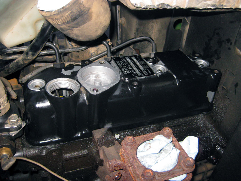

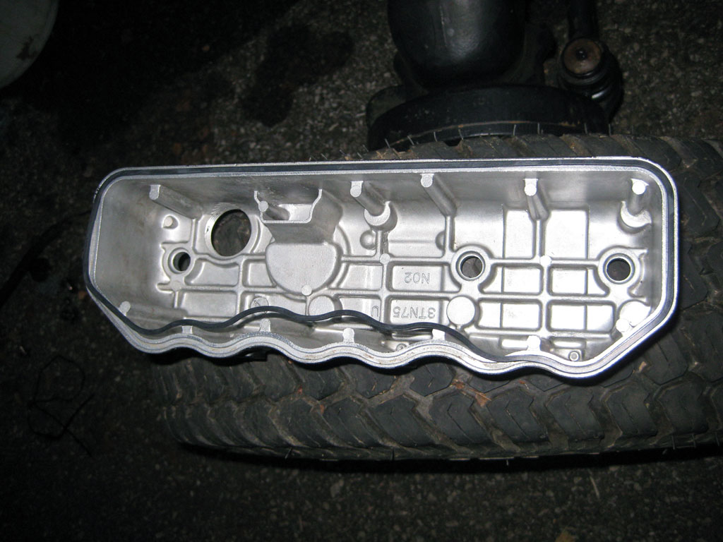

I cleaned the valve cover really well. Then I cleaned the gasket opening even better. I put some oil all the way around the groove and installed the gasket while smoothing the oil over top of the gasket.
Gently install the cover back on the engine. Then tighten the three valve cover bolts. I used three new valve cover bolt o-rings. The originals were shot (big surprise).

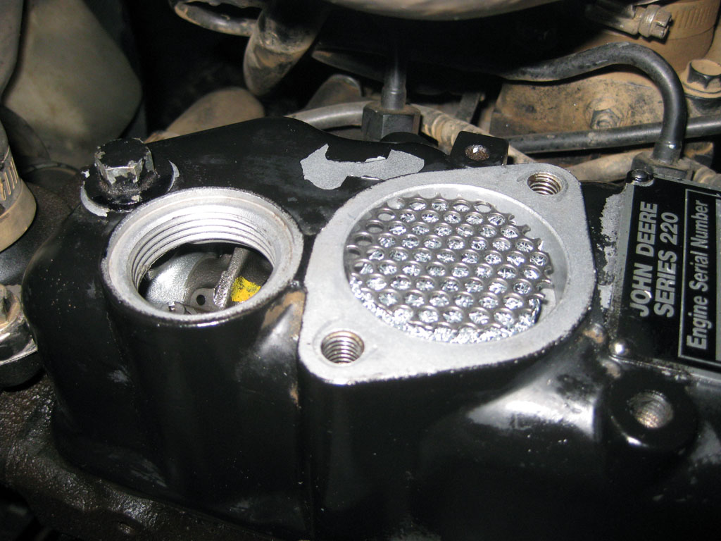

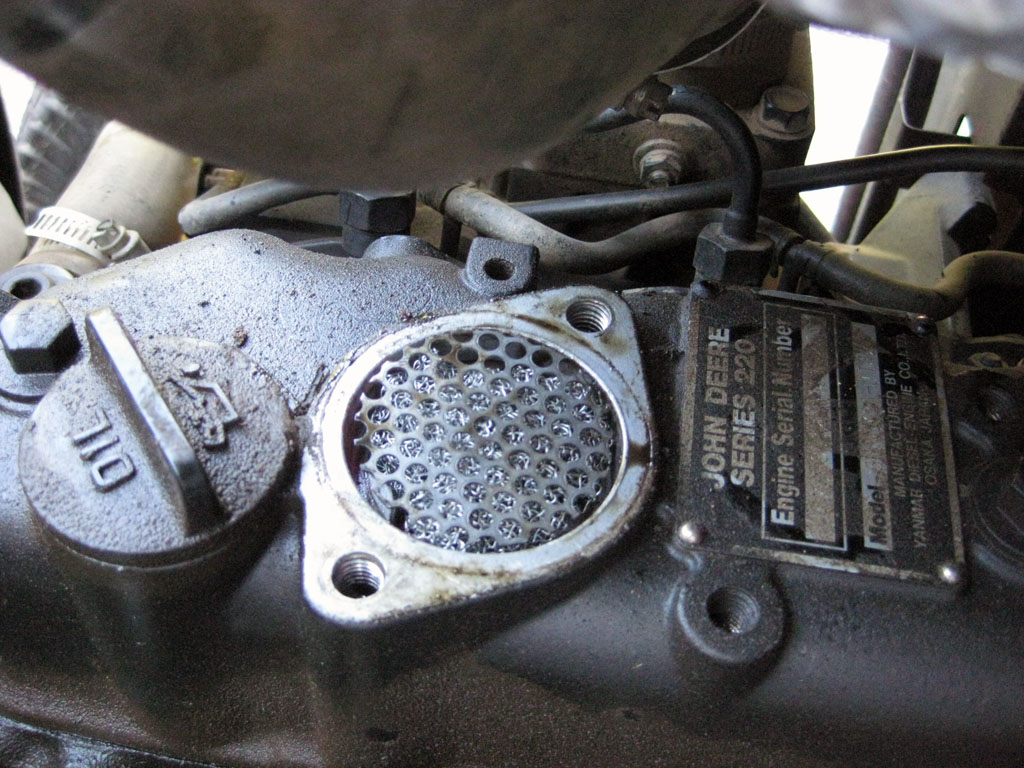

You can see the new baffle versus the old baffle. I was going to return the new baffle after first seeing it but after looking at the old baffle I decided I would use it. I installed the baffle better then the original was installed. Or so I think. I made sure to cover the opening better anyway.
The plate gets installed next. I cleaned it well too.
I installed a new breather cap o-ring. I rubbed it in some oil as well.
And finally the breather cap itself. I cleaned it very well too. I really need this stuff to be clean so I can see if there are any leaks after a few hours.

And the finished product.
Well kind of. I plan on removing the exhaust manifold to clean it. Mostly so I can spot any new leakage easily but also because I'd like to change the gasket. I'm just guessing but its probably in as bad a shape as every other gasket and o-ring I just replaced.
And got to finish reassembly of the exhaust and the loader mount.
I installed a new o-ring on the oil cap. I take it everyone knows why. :D
