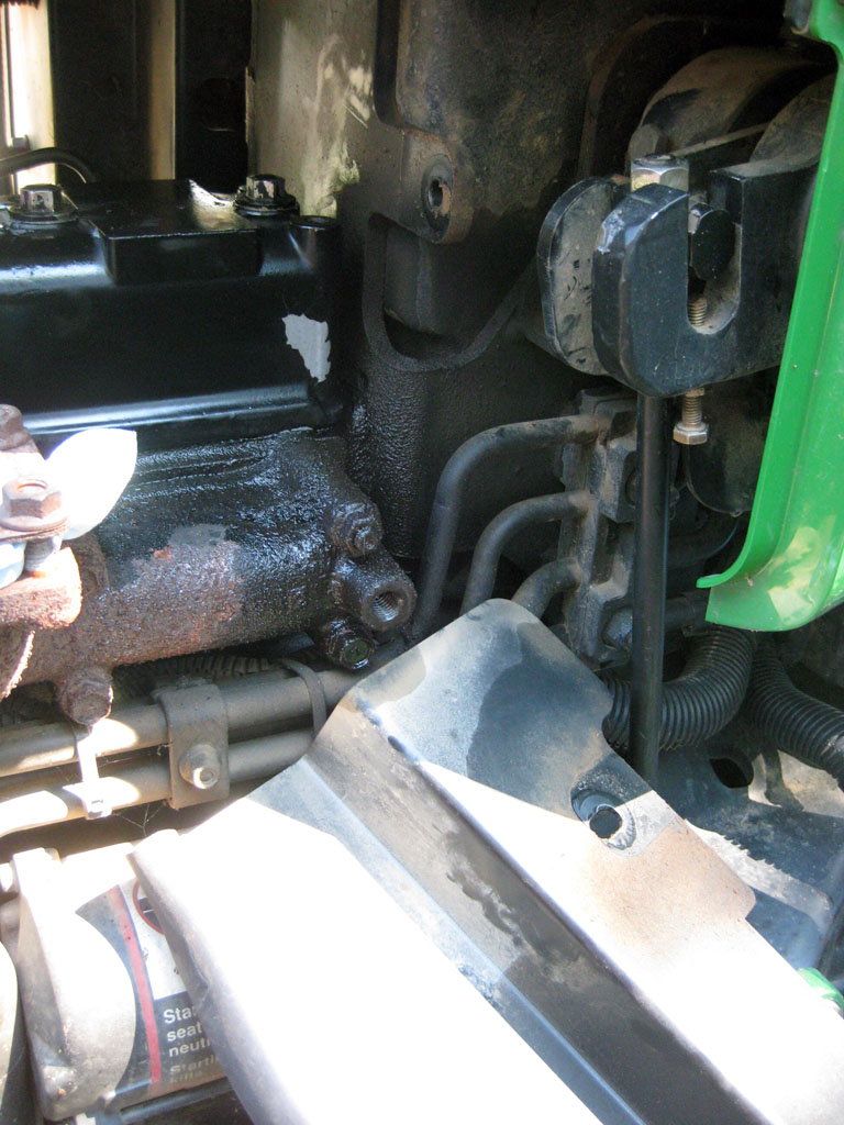

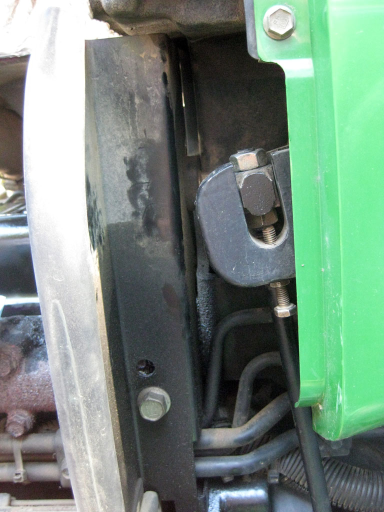

That sucks that the right loader mount has to come off. I have my canopy's front posts mounted to them.
Can't speak for your canopy, but I'm very glad I had to take the loader mount off. The bolts were super loose. 50 ft-lbs vs 166 ft-lbs (or 255 ft-lbs even according to the online manual). I wound up removing all eight and Blue Loctiting and torquing them. It was worth the work to know they're in there properly now.

On to the rest....
While you've got all this apart, doing the exhaust manifold gasket is only minutes more work.

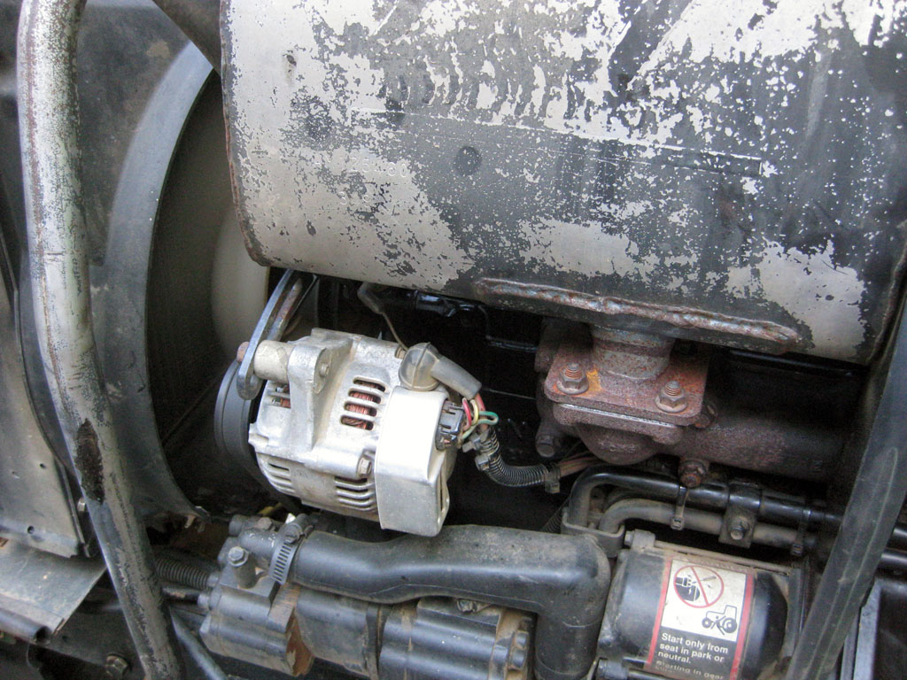

First the separator has to come off. One bolt/nut and one bolt.

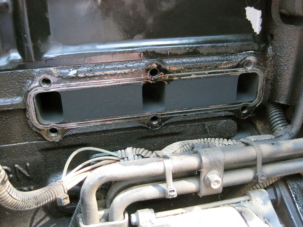

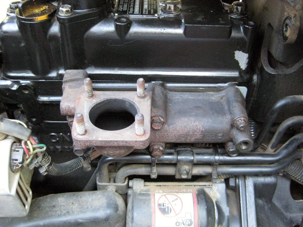

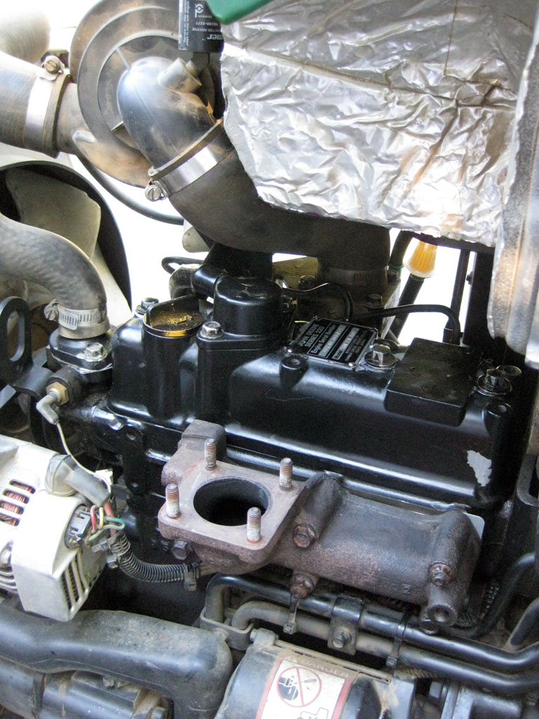

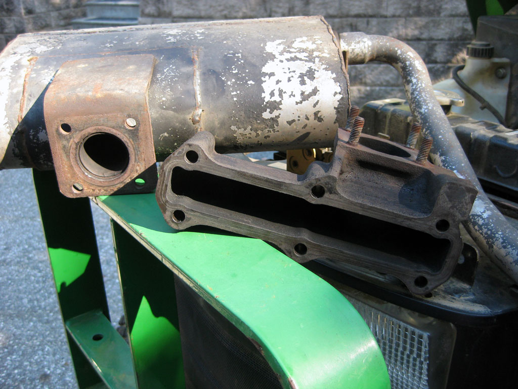

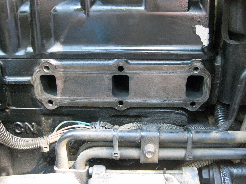

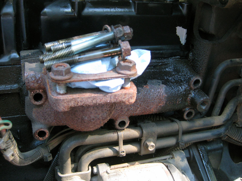

Undo the manifold bolts now. Two of them are studs with nuts. If the nuts stick and the studs come out, don't separate the two. Just treat it like a bolt at that point. If the nuts do come off, then you can use the studs as guides as they were intended to be used.
I can see why the bolts don't break off. They have lots of room around them in the holes so they don't rust weld themselves to the manifold. Thats a good design. Not every manufacturer is that smart. Believe me. Because of this I did not replace them with stainless steel ones.
Notice how dirty the mating surface is. I just knew the manifold gasket was shot. Make sure you clean this well if you want a good seal on reassembly. I scraped it well.
I stuffed some rags in the exhaust ports while I worked on the rest. This isn't critical but what the heck.

You can see I scraped both muffler mating surfaces clean too. Again, you're not going to get a good seal with steel gaskets unless the mounting surface is as clean as possible.
The new exhaust manifold gasket is visible in there.
You can see the airbox was reinstalled too. I did that while the manifold was removed and the ports were plugged with rags. I could just as easily have done that before touching the manifold.

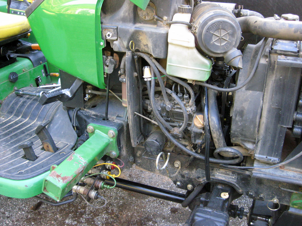

And finally the muffler and new muffler gasket are installed. You can see them with the running engine here.
Two things I noticed immediately. The engine is quieter. Its not quiet, but it is better than before. The exhaust manifold gasket wasn't doing anything. This may be the cause of my intermittent white smoke. Fingers crossed.... I sure hope so!
The second thing is that the engine sounds "tighter". This is what it should sound like after a valve adjustment. I'm glad I can hear the difference. Means it really needed it.
Now that everything else is done, the loader mount goes back on. I think I said earlier.... I actually undid all eight (both sides) loader mounting frame bolts, Blue Loctited them, and torqued them properly.
