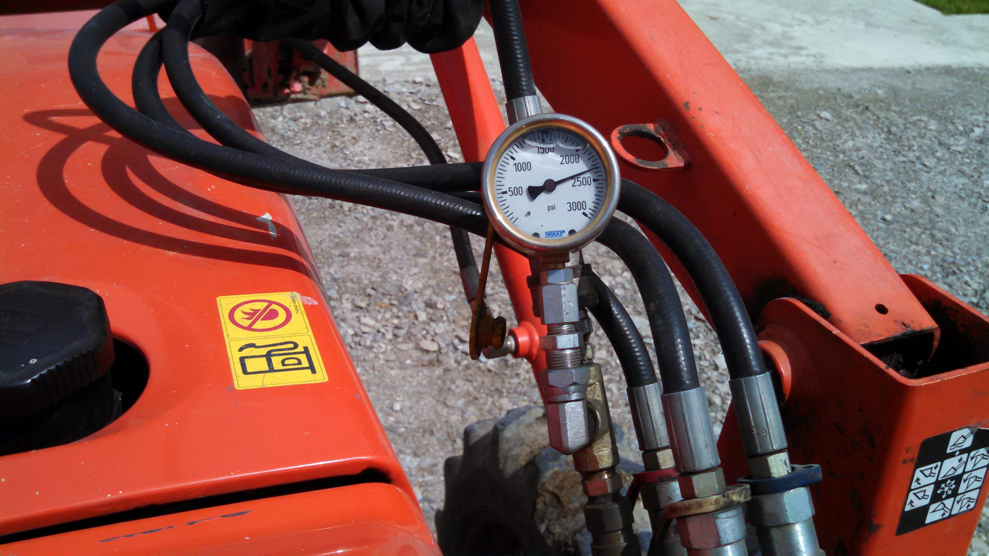

I think you are WAY underestimating your loader. Especially if these are SSQA pallet forks and not clamp on forks.
Here is 14 bags of mortar @ 75# each plus pallet, so about 1100#
Only took 2400# to lift, which is about the max for a loader that hasnt had pressure tweaked up a bit (mine is 2650psi).
So imagine how much it could lift if I lost the weight of the bucket, and moved the load that ~2' closer to the arms.
I am guessing your figures are about 1/2 of what it could actually do. I am betting closer to 1700-1800# with a SSQA forks.
Still well within the range of the forks, but it all depends on what you do. Pallets only (nice uniform load) the lighter ones will be just fine. But if you use them at all for other things, like lifting and prying on rocks with just a single tip, or using a 10' boom off the end, then I might suggest the heavier ones.
