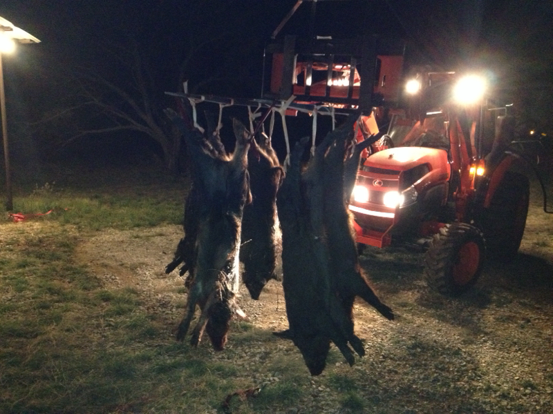

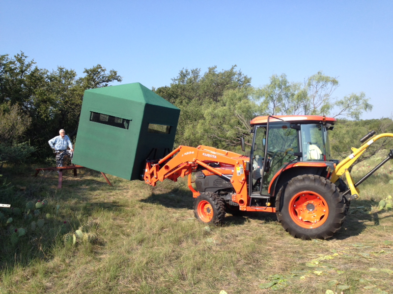

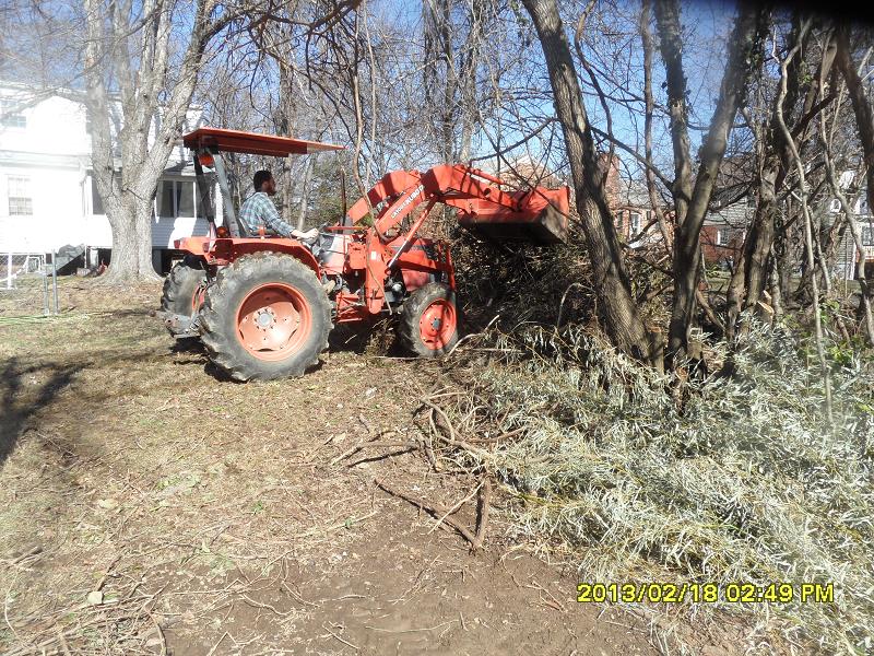

Advantages of going small - lighter, cheaper, maneuverable in tight quarters
Go big - fit more material, easier to lift pallets out of pickup trucks/position pallets on trailers, easier to see, lift 5.5x5.5' deer blinds, room to quarter 5 hogs, etc
I kinda wish I went 60 vs my 48 but never heard if anyone wishing they went shorter...
