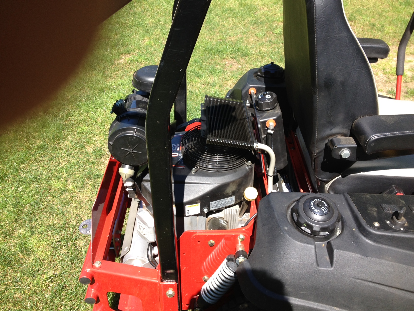

   / 42" ZTR with utility trailer hitch? #14
Hi Folio,
I have the Ferris with 25HP Kawasaki and tow a 10 CF lawn trailer loaded with wood over some rough ground and about a 200 yards from my woodpile up a small slope. No problems.
I also tow a Trac Vac Leaf vacuum 6HP B&S on the tounge weight about 75Lbs empty and when its full about 300 lbs but the tongue weight probably never is over 100 Lbs. I havent had any issues with stability or "tippyness" with the Ferris. It does weigh in at 1100 LBS and with me on it over 1300 Lbs.
When I spoke to Ferris about this they said the Trac Vac is more than the machine should be pulling due to the hydro motors on the axle so I added a cooler to the hydro line - now temps are 140* down from 180-190*.
You can see the hitch (got off ebay) on the bottom right rear in the pic. It has 1/4" plate and 4 bolts that attach to the back frame.
Anyway, you should be fine towing a small trailer with a ZTR.
