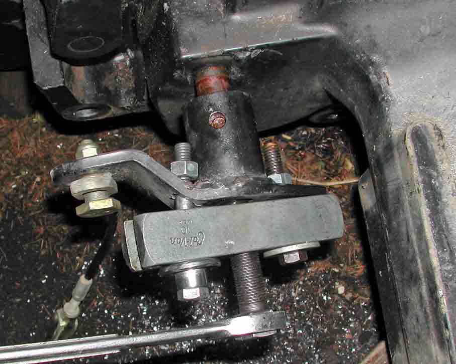

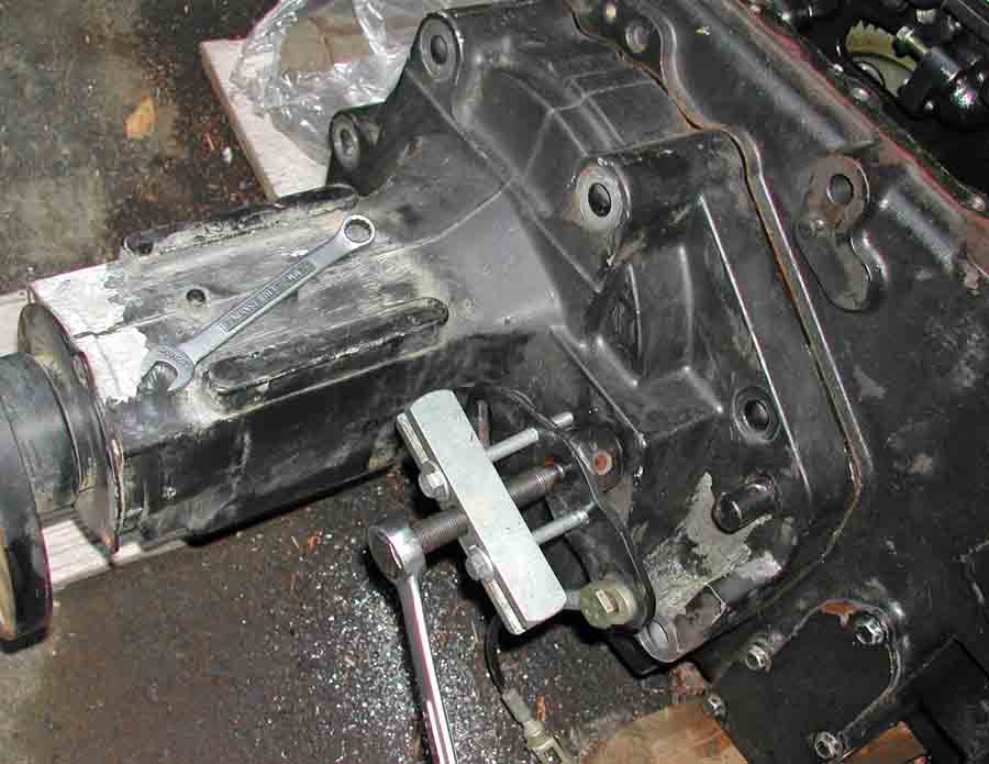

The hardest part of removing my axle housings was getting the
brake levers off the shafts. I had to drill holes for pullers (both sides).
Yours may be easier.
So I got to the point where I need to punch out the roll pins and there is not enough space to hammer the punch..
How did you get a puller to work for that purpose?

From my thread on my first 4300.
Did you pull the fender off first?

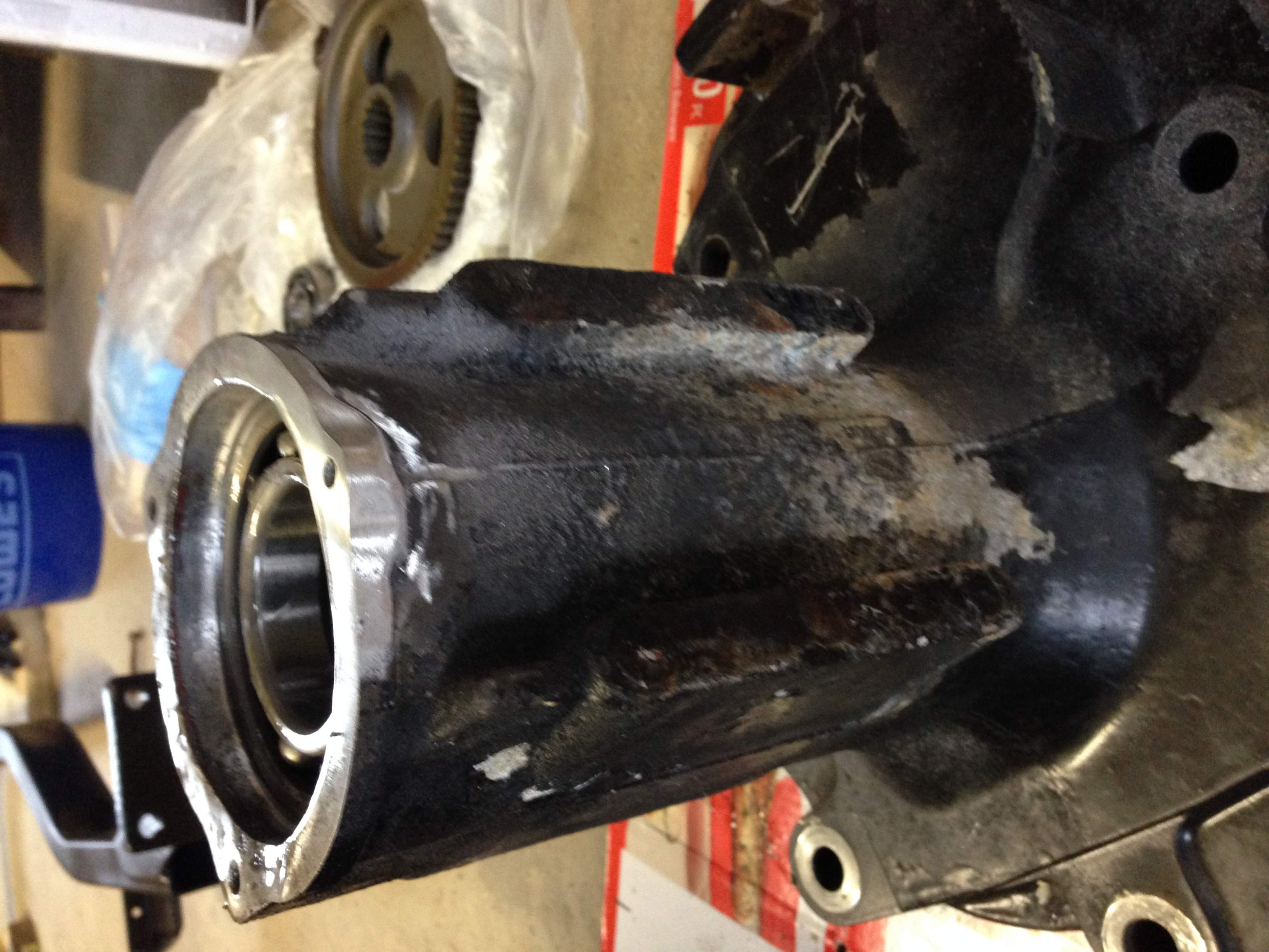

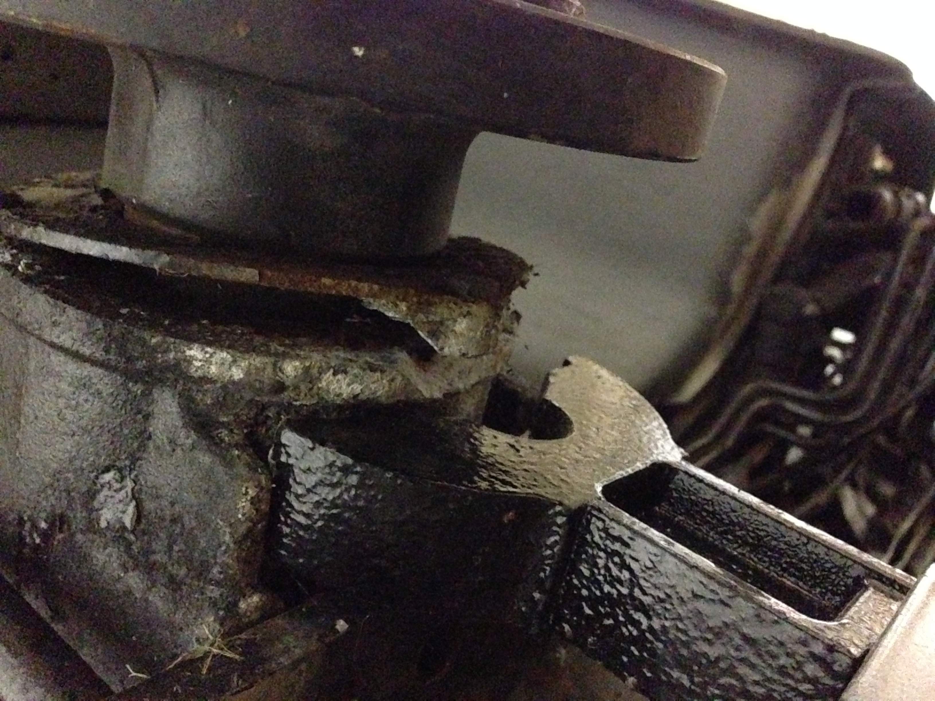

Sorry it took so long, I've been busy. I got my housing to the welder and they pressed it out. They also welded some aluminum so I could attach a new retainer. I got the other housing off and the axle slid right out. My housings were pretty corroded so hopefully the seal will seal good enough. Here are before and after pics for my right housing.

1. I had to drill to holes in the brake lever and use a small puller to get the lever off. It cans off easy using a puller.
