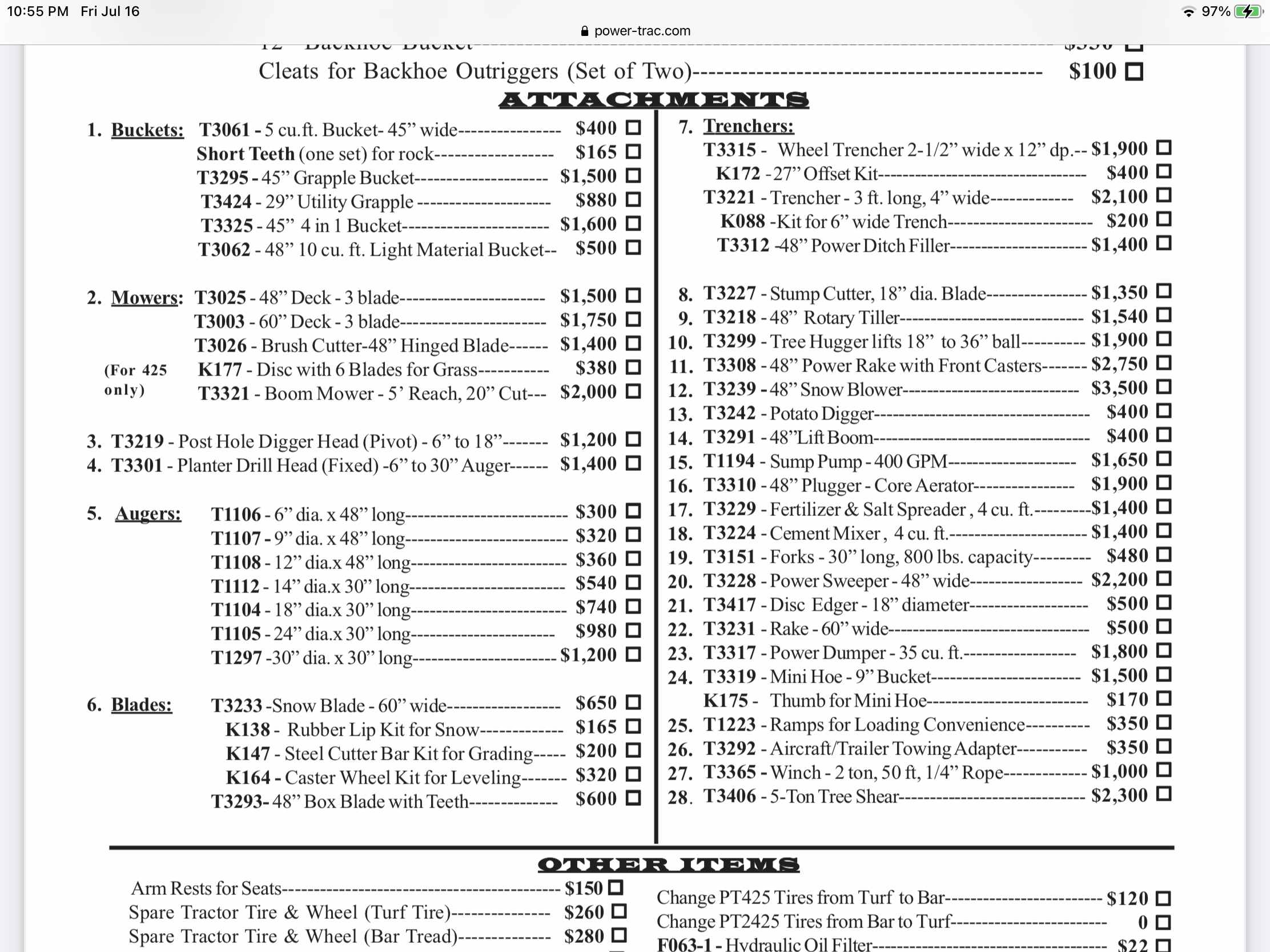

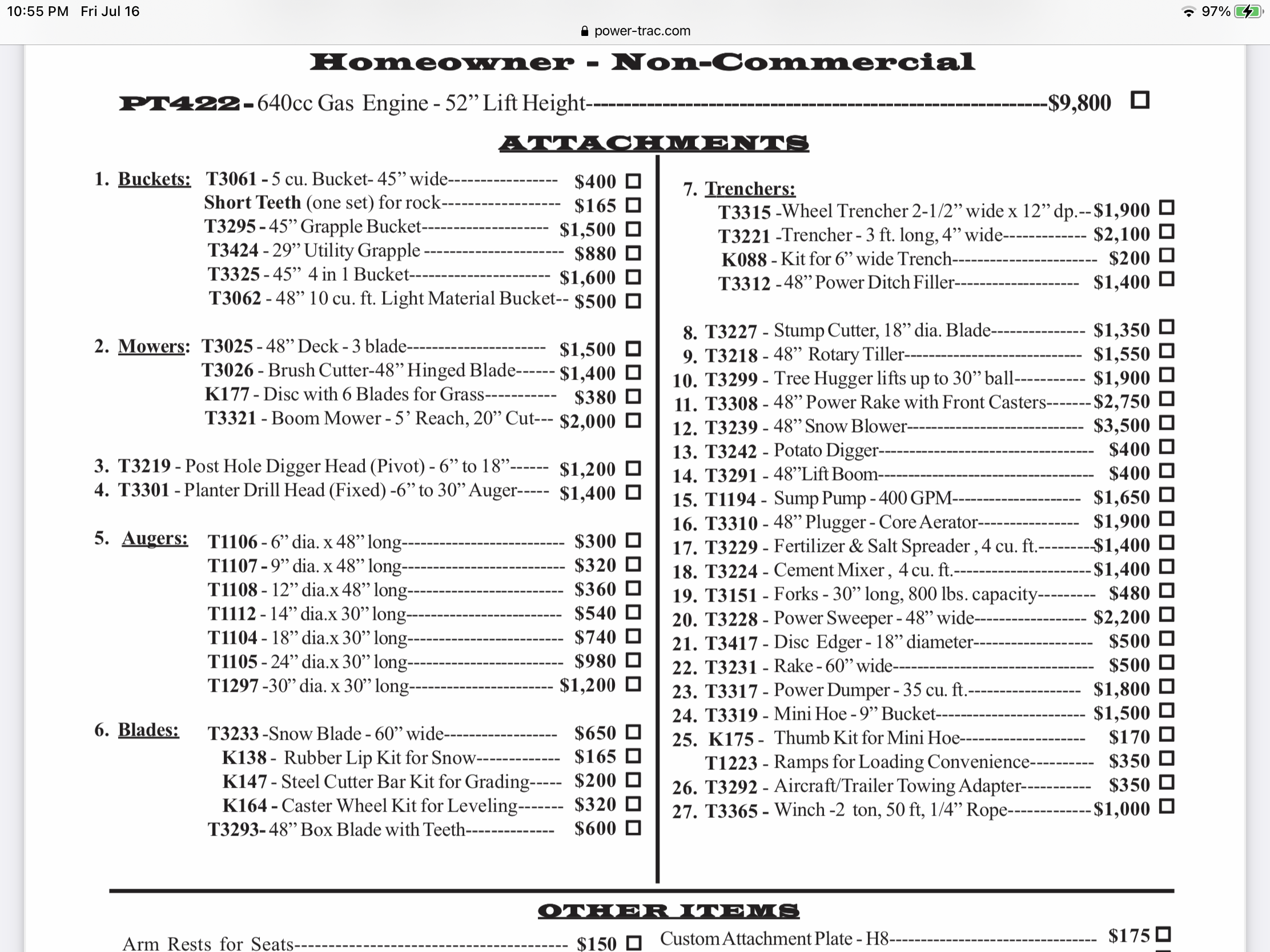

Does anyone know if the 422 and 425 use the same mowers? Or post hole diggers?
Terry had told me the plates were the same, but I forgot to ask about any hydraulic implements.
I was assuming a 425 could use any 422 attachments, since the plates are the same.

I just did a pass through the price lists for both the 422 and 425 and they have the same part numbers, so, yes, they are the same.
However, you'll notice they don't recommend the 60" mower for the 422. It's not on the price list. 20 years ago I spoke to Terry at PowerTrac and he said you'll want and need the extra HP to spin the larger deck.
But both the 422 and 425 use the same 48" finish mower, brush cutter, post hole diggers, trenchers (but a few accessories aren't offered on the 422), brushes, snow blower, tillers, etc...
Here's the 422 price list
And here's the 425 price list
Compare the parts numbers. They are the same.
That's odd - pulled them both and they were NOT the same. Huh. Must be something cashed on this PC or something. My apologies.

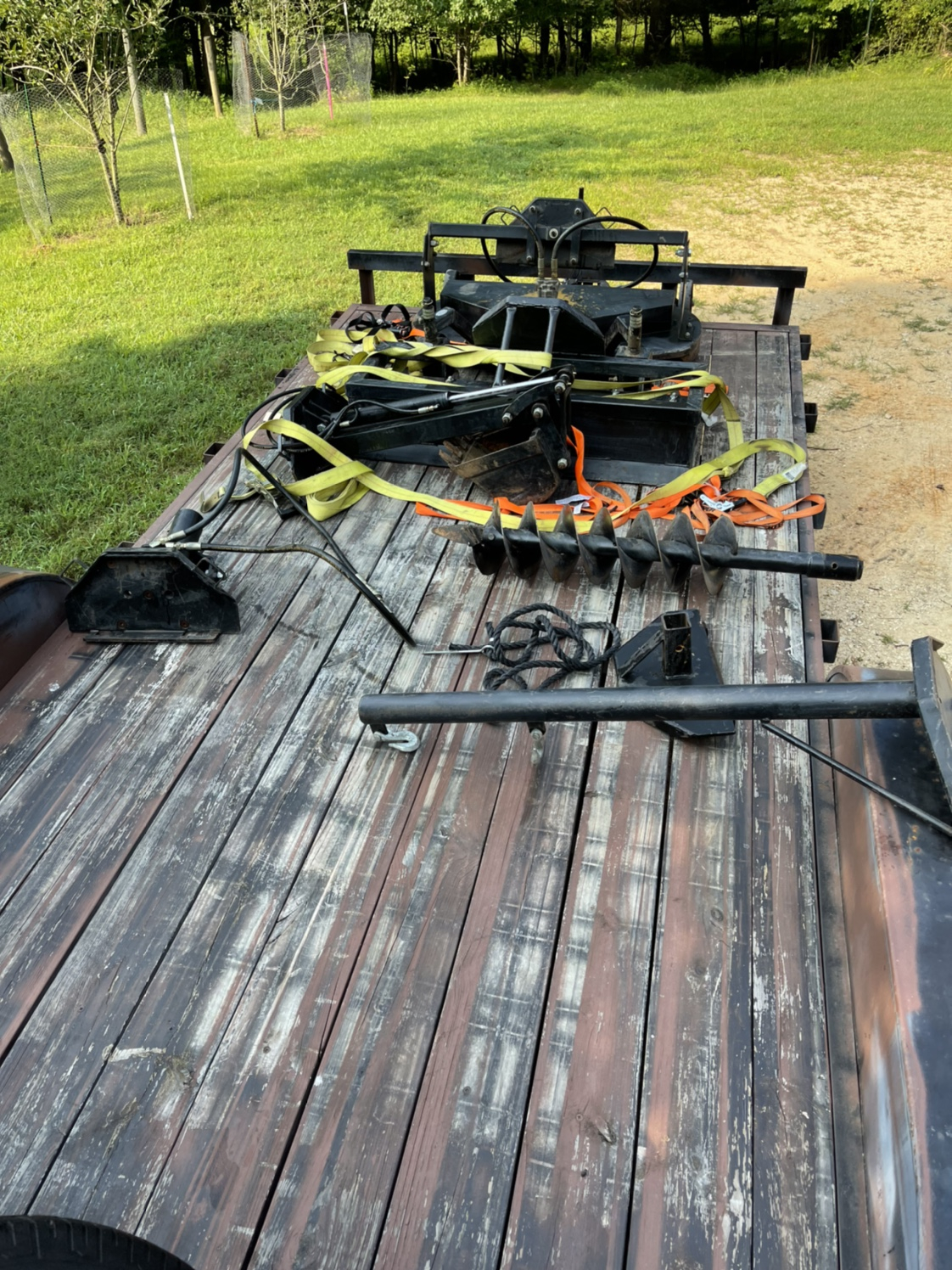

Here is my used attachments find.
Boom pole
Trailer mover plate
Pivoting post hole digger with an auger
Mini hoe
Box blade
Finish mower.
Got it all for $2600. Which I thought was worth a 12 hour round trip drive to retrieve them.
Now to head back to Tazewell to pick up a 425 with bucket, grapple and rake.
