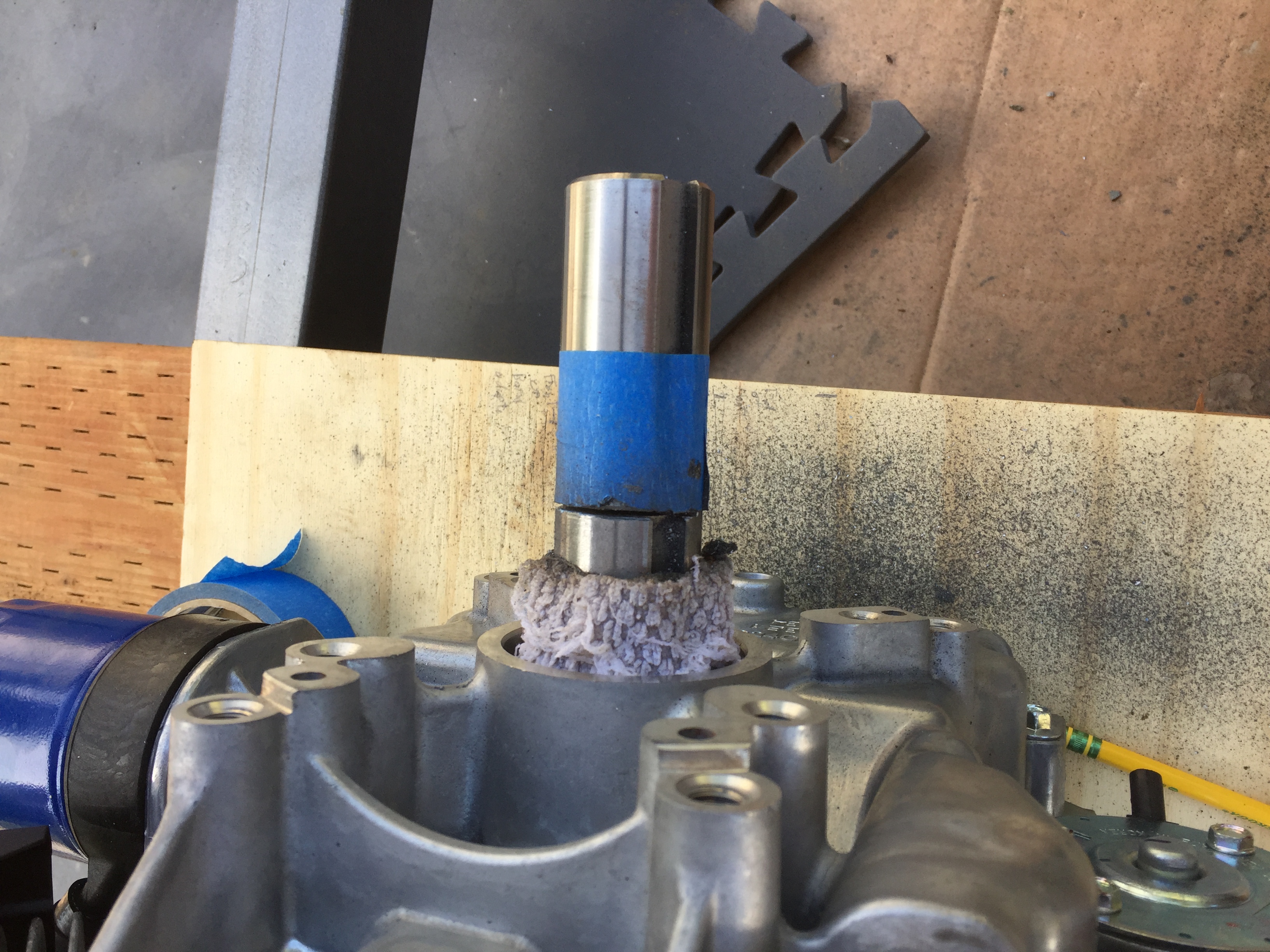

Long story short. cut crank to fit, drilled tub for new engine, rejiggered the plug on tractor side of wiring harness and started the engine and moved it twenty feet. :thumbsup:

Wow! Glad you got it going. How did you cut the shaft?

I cut the shaft with hacksaw, took about 15 minutes of non-frantic cutting. Used the wife's hem marking tool, it has increments of 1/64 inch! :eek: Blue painters tape as guide.

I see that Andy's kohler is a CH730-3205, it appears it has a 1 1/8" shaft which is that same size shaft as the robin's engine i had so could have used the same jaw off the lovejoy i took off my engine. I got a bored out jaw from PT, $35.
The thing that kinda confounded me, was determining the engine shaft length. I tried three different ways to measure it, two of which were 1/8" of each other.

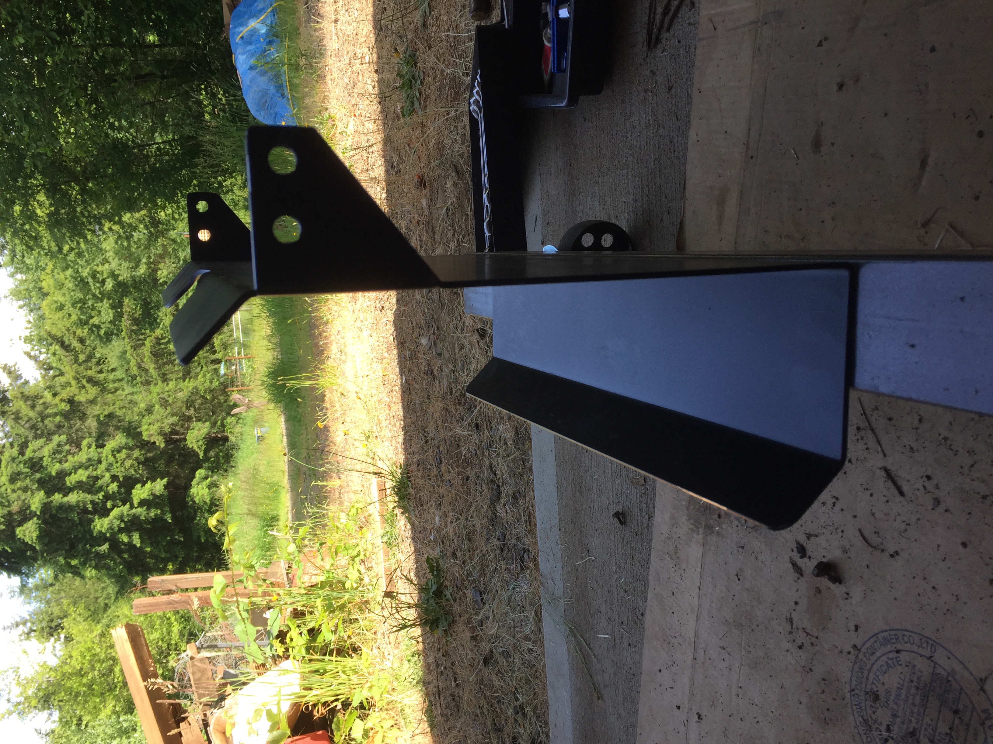

Heat shield:
Original, is much lighter gauge and could have been drilled to mount higher so as to clear the engine to pump coupler. I used the much heavier shield Terry sent, cut the ears off and drilled to mount just like the old one.
