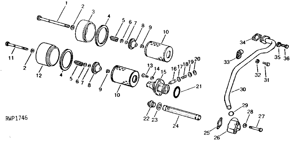

Jul 21, 2013 / 4240 john deere hydralic #1 S super joe New member Joined Jul 21, 2013 Messages 2 Location Palmyra Mo. Tractor 4240 How many hydralic filters and or screens and location of
Jul 21, 2013 / 4240 john deere hydralic #2 Tx Jim New Member Joined Jan 26, 2007 Messages 10,404 Location Coyote Flats,Tx Tractor JD 4255/Kubota M7040 HDC Quad range trans. has one hyd filter,Powershift trans. has 2. Screen(parts key #24) is located in bottom of trans case lying cross ways between hyd filter and rear axle housing. Attachments RWP1746________UN01JAN94.gif 16 KB · Views: 232
Jul 21, 2013 / 4240 john deere hydralic Thread Starter #3 OP S super joe New member Joined Jul 21, 2013 Messages 2 Location Palmyra Mo. Tractor 4240 Thank you for your help super joe Palmyra Mo.
