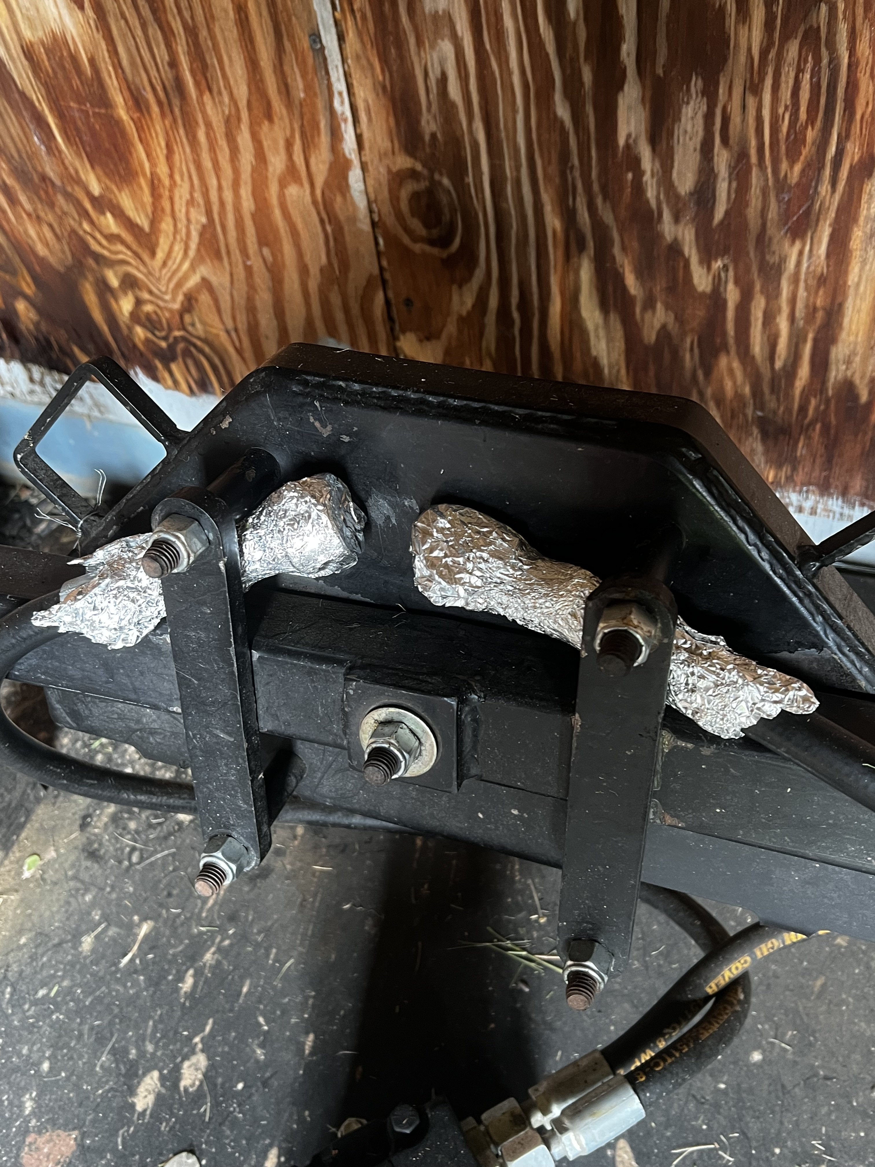

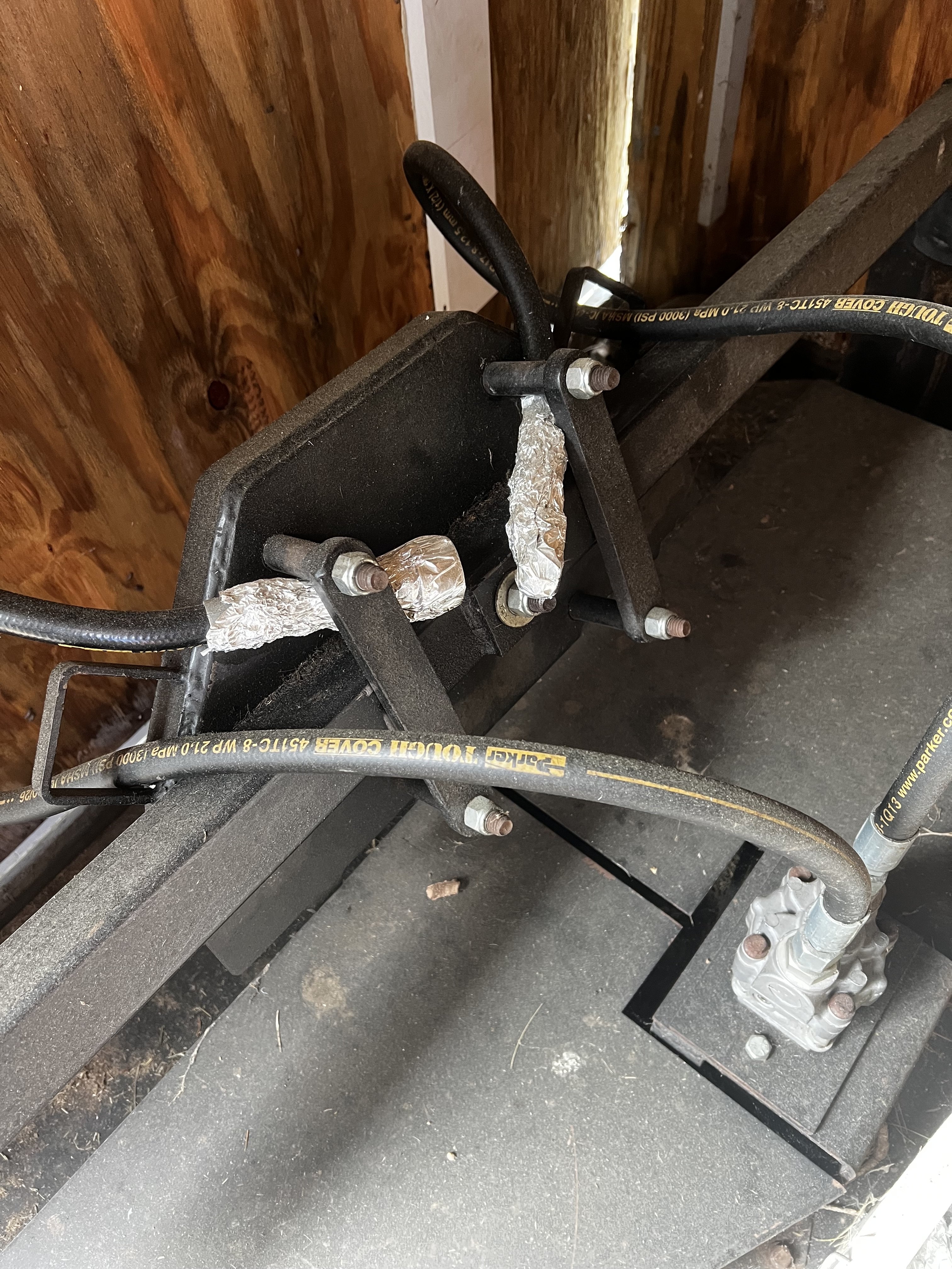

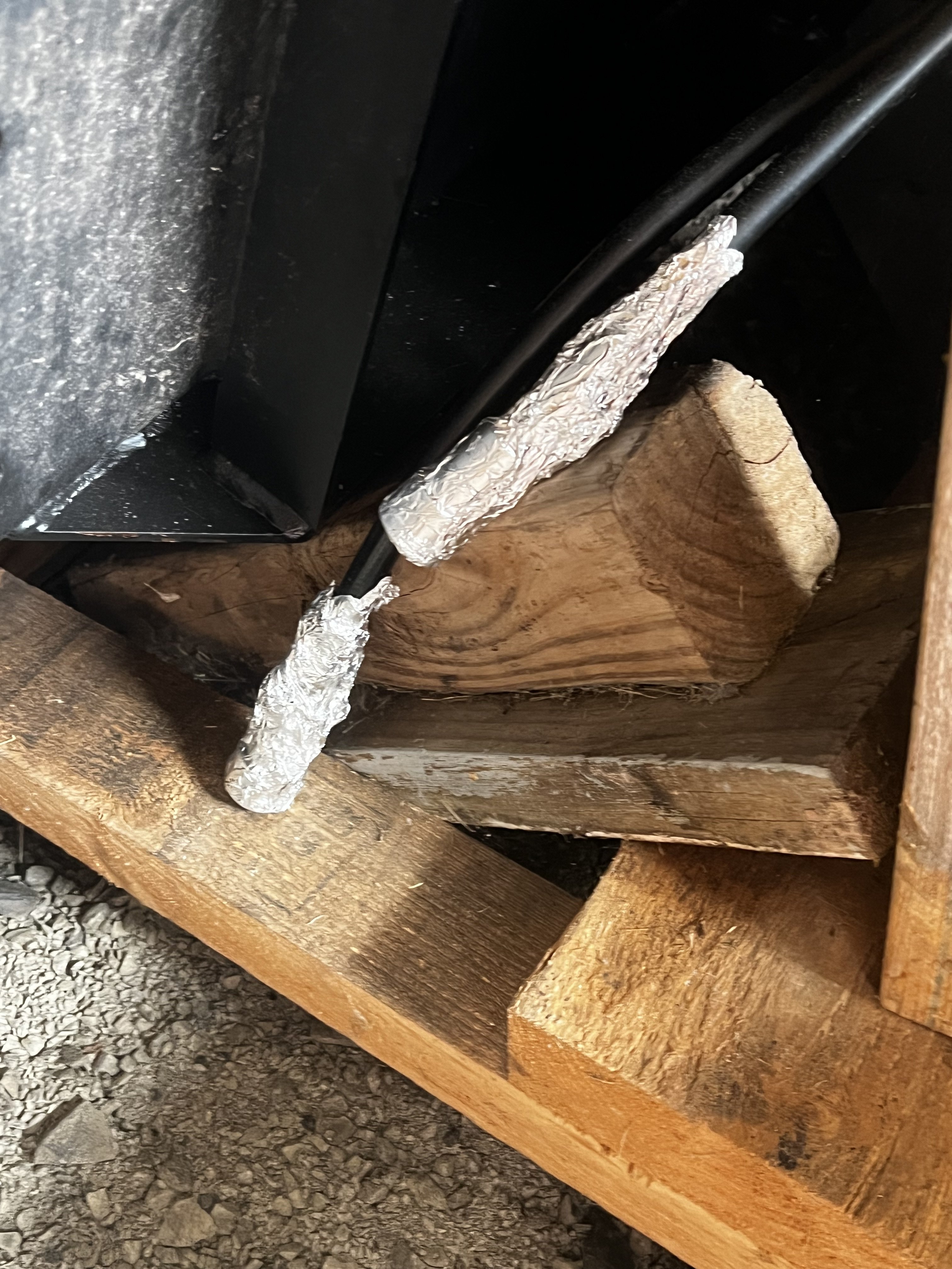

I use aluminum foil to cover my connectors, inexpensive and it works!
Always use a fresh piece, keeps them clean!
