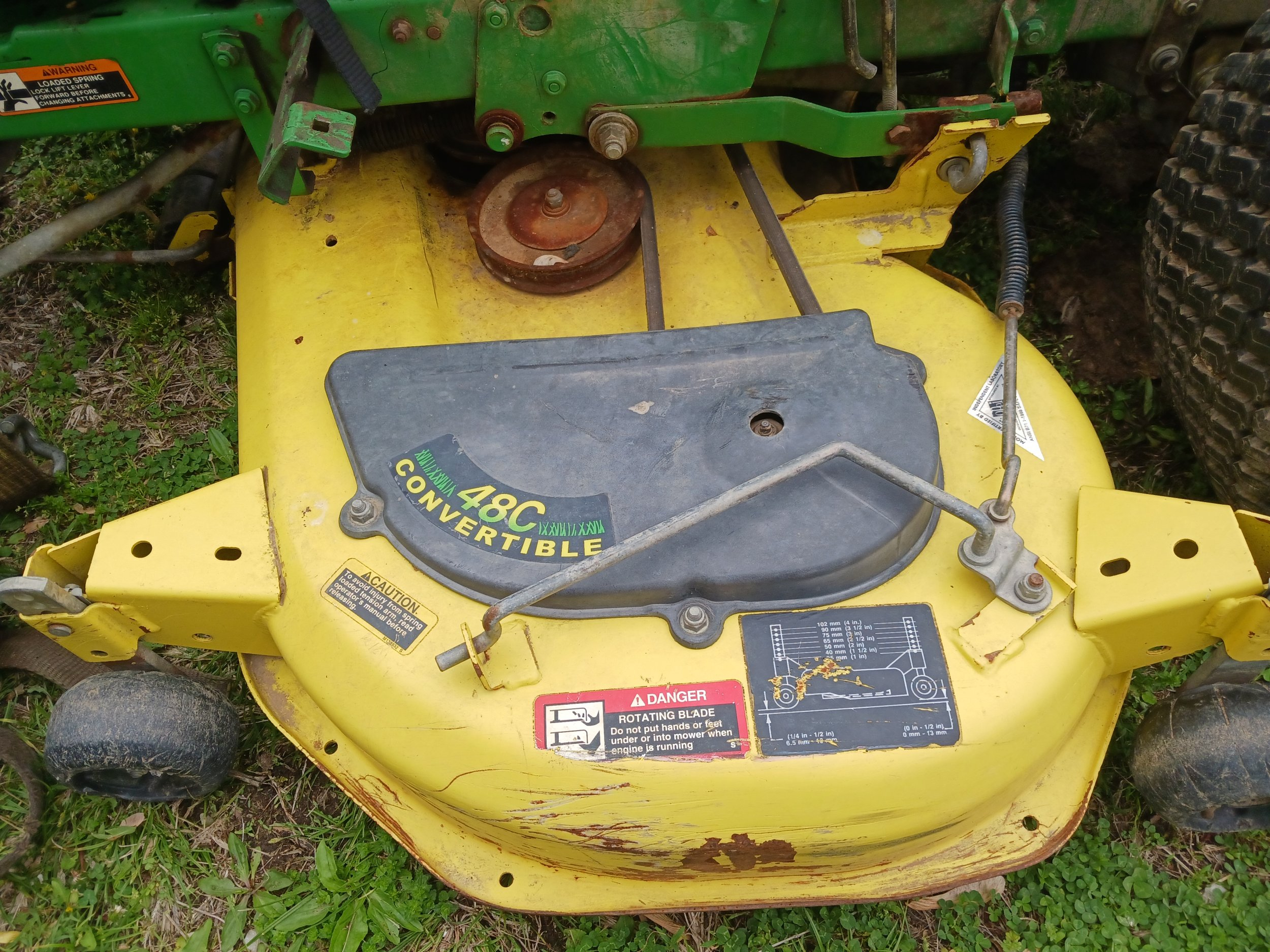

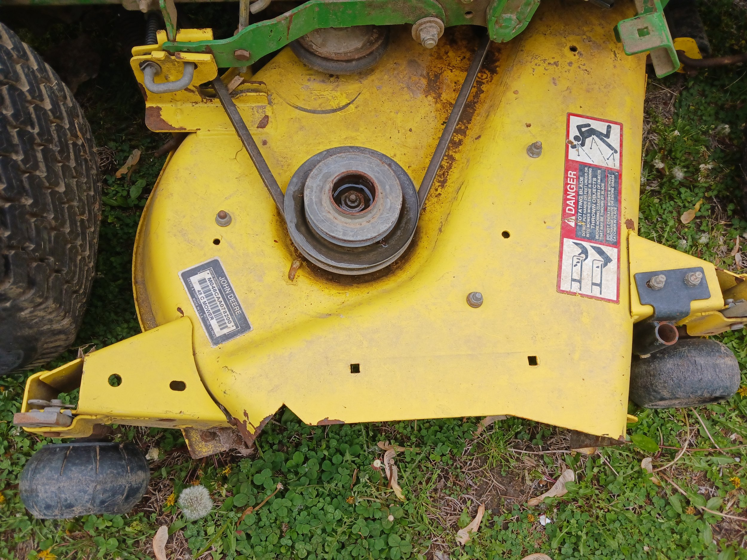

So these two photos are of the deck that is for sale ?
/ 425 48 inch mower deck
#22
Congratulations You did it. Scarry, but you just have to try and presto, there you are.
Yes he told me I just need my lift arms and my a gearbox??
/ 425 48 inch mower deck #23
The pics of the 48C deck shown will not fit your 425. And you mentioned needing a gear box.. ?? Seems to me, you are a long ways away from fitting this deck up to your 425, as the deck shown is a belt drive deck indicated by belt-tightening rod shown.
Good job on the pic posting. Narrowed down our thoughts and suggestions, that should keep you from making a buying mistake.
Keep looking for a 48" deck that fits your 425.. it will have a drive shaft to connect to your PTO and the right connection points for the lift arms and the front draft bar. The one you found is not it!
Thanks so much!! I figured as much, this guy was just trying to make $500 off of somebody! I will keep looking and in the meanwhile just keep welding the old one up!!
