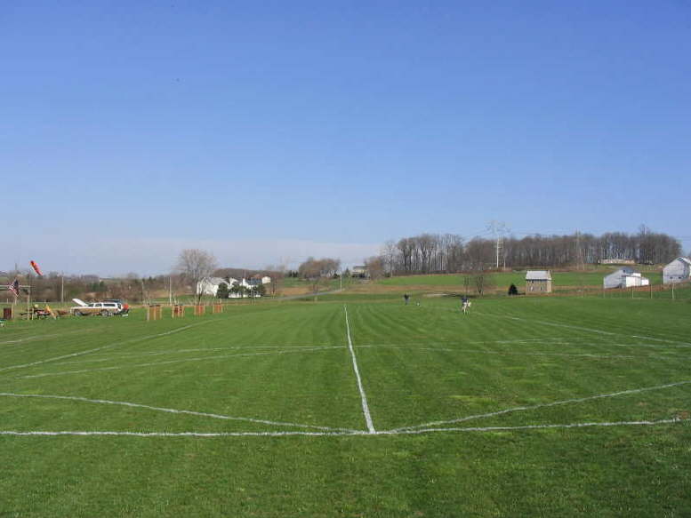

Here is a pic of our RC flying field after cutting with the 425. The grass was quite high before the cut due to all of the rain that we had i one week, but I cut a 1000' x 300' field with no problems.
