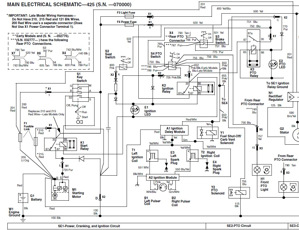

When it starts losing power, is it getting spark at both spark plugs? Just had an issue with my 425 and "no spark" at the left cylinder plug.
Turned out to be the ignitor.. after replacing the ignition coil, the pulsers, the ignition delay module, and the ignition module circuit board kit. Missed the ignitor completely by mis-reading the check down list and an error in a schematic. The ignitor is NOT the A2 ignition module. Chalk that up to my mistake too.
Only follow this path if there is no spark at one of the cylinder spark plugs.
Thanks I'll take a look in the next two days, I did a circuit trace three years ago on my 790 to track down a faulty fuel shut off, know the drill...........
