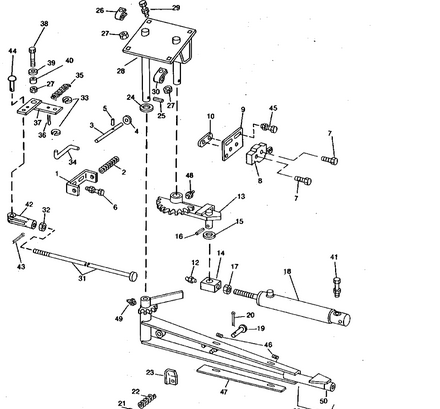

Are all 5 springs in place on twine pump mechanism? Have you liberally greased fittings(keys 48 &49) on twine gear assembly??
