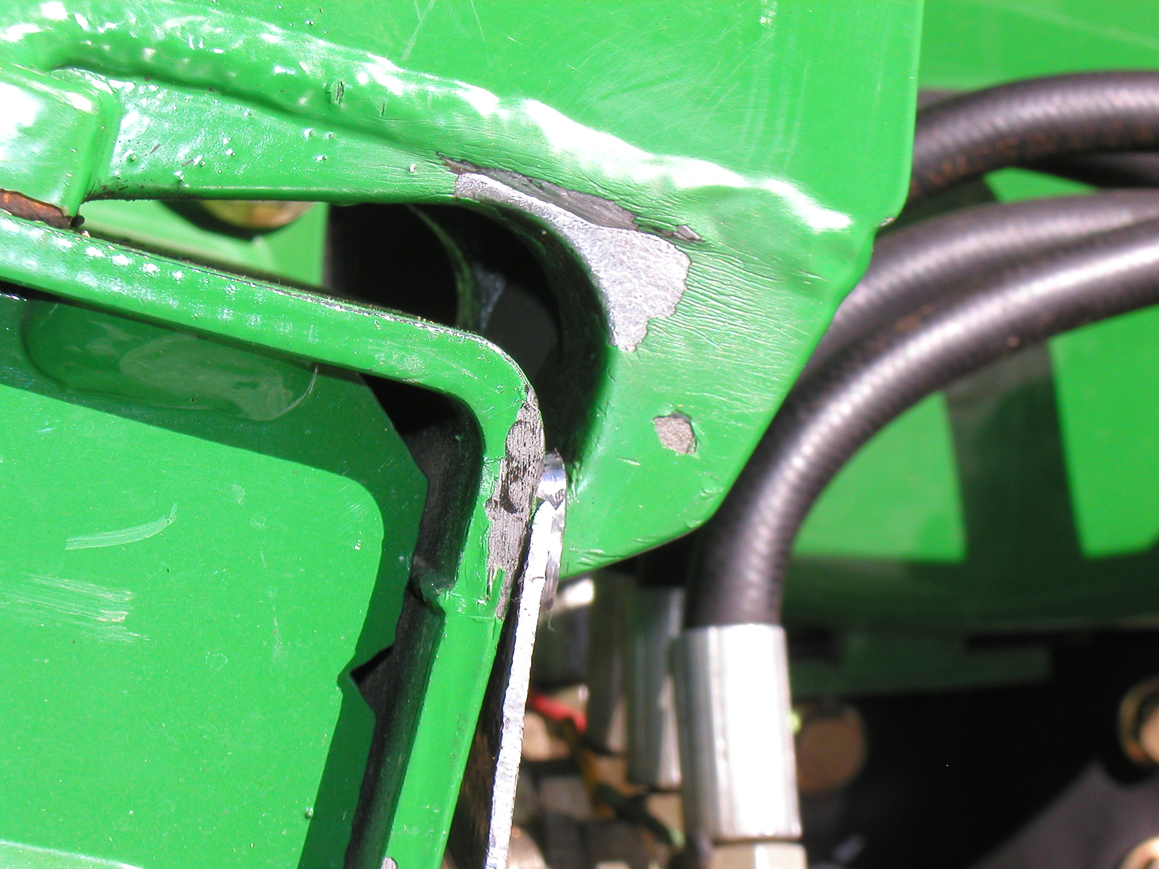

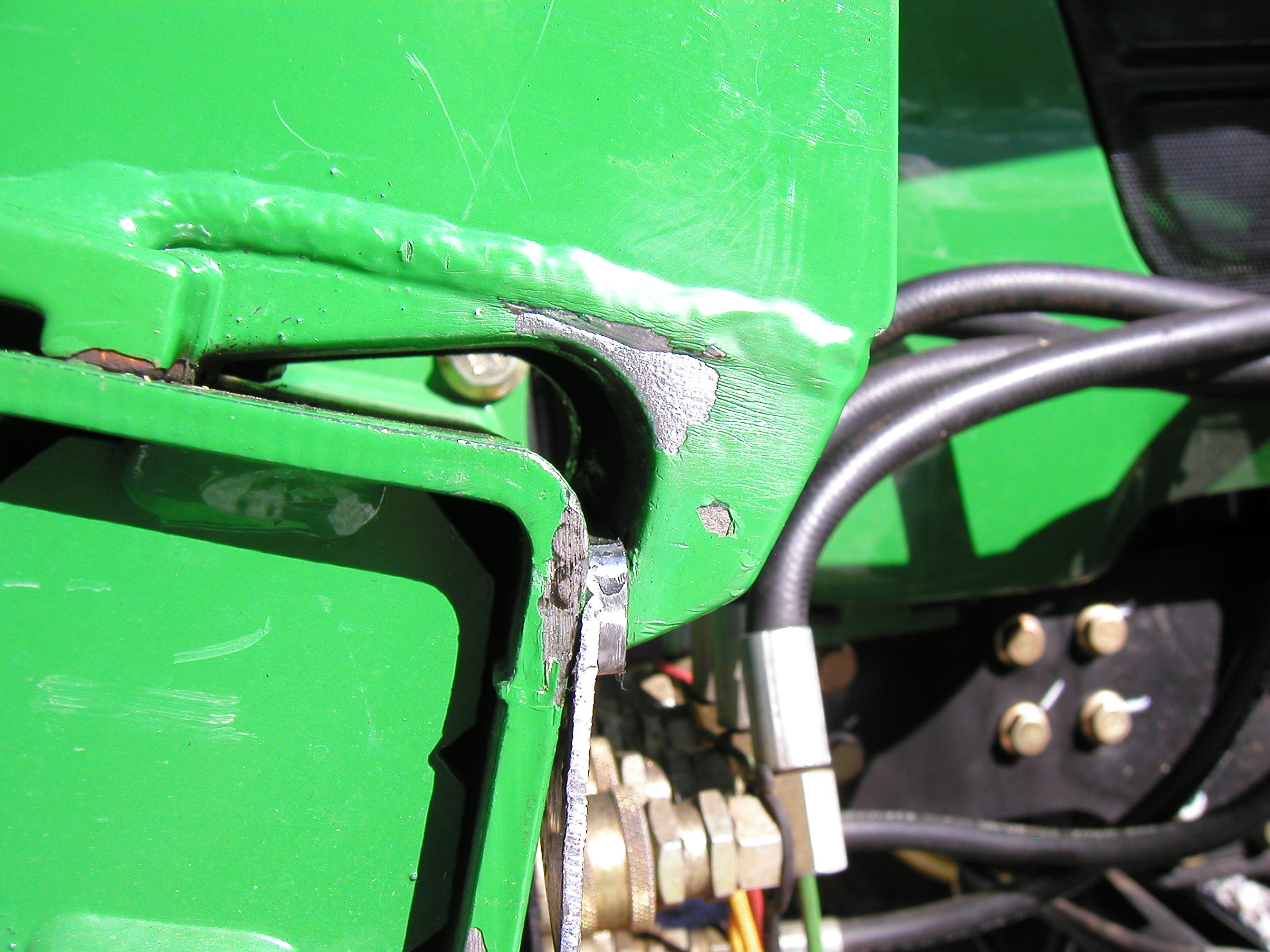

Seems like you all have seen something I've missed completely!
First I thank you all for your observations. I never would have guessed that this would be revealed in the pic.
Second, I'm going to take it out in good light and examine it more carefully, as you suggested nmu98.
That side is looser than the other so now I'm suspicious.
Besides the magnifying glass, are there any other simple methods to reveal a crack? I was thinking of putting it under stress and looking at it.
Chuck
Putting it under stress and looking at it is a great idea. Sometimes heating things up helps.... But i think you will be able to see whats happening once you remove the paint. That might be where the metal streched?
Just pick at it with your knife blade.
Still think it's a paint crack.
Will. It might be a crack in the paint. But most times paint does not just crack like that. It has to be streched, or moved to create a crack. Rust could have got under there, but looking at the placement of the crack, and the problem discussed, I think it was something other than sun or rust.. Might be wrong... but we are just trying to get to the bottom of his problem.

I have found cracks by scraping the metal and putting a touch of penetrating oil on. Seems to show the crack.
Looks like a paint crack to me but I'll bet the oil would find it.
   / 430 Loader getting looser #33
In picture 3 of this post, you have a crack on the front of the clamp. I would think that is why it is getting loose....
That does look like a crack, i believe i would scrape the paint off and check it out. Just to be safe.

Good news!
I took the tractor out this morning to check it out in the sun. I scraped the paint off from around the area of the paint crack. Then I cleaned it up with a wire wheel put it under stress and looked at it with a magnifying glass.
It looks fine. I could see no sign of a crack.
sixdogs- I tried the penetrating oil also and found nothing.
All I can think of is maybe it flexed there slightly at some point. Seems unlikely because it's pretty beefy.
jdgreg- I think I will try your solution and weld some strips of flat stock to the contact points in front. Beats sending it in to JD for the shim kits. I'll wait for a nice warm day to try it.
