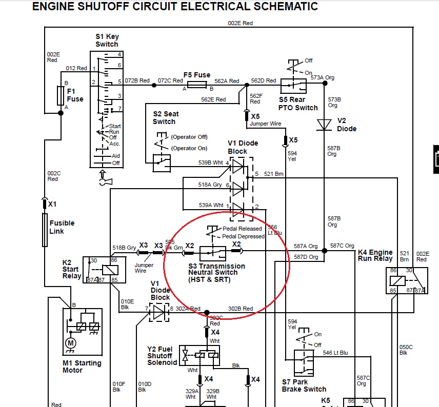

Where is the neutral safety switch on the 4300? I'm almost positive this is the problem, as I've had to jiggle the sync reverser handle while turning the key to start it for about two years now, it finally would'nt start, so I bought a new switch, with the copy of where it should be from John Deere, and I can't find it where it is supposed to be!

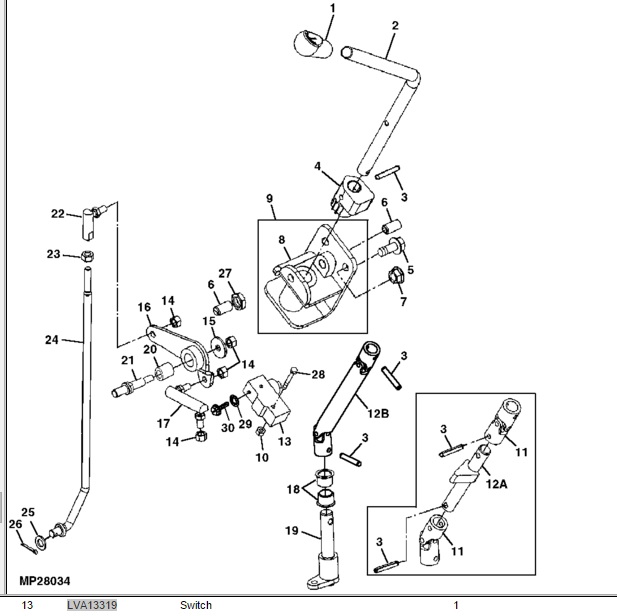

Will look in the serv tech manual I have, and see what I can find.
Found the following pic in jdparts.com, shows the switch and part #.
Hope it helps to locate it on the control lever mechanism.

Yes, that is the same page which I got from the dealer. But, it was'nt where it was supposed to be. I followed the linkage all the way from the handle down to the entrance to the tranny, and could not find it or even a wire to jump it, so I could at least start it to see if that was the problem. I called the dealer yesterday, and they said it might be in the tranny.
I don't know if I want to pull the tranny in this weather(teens here today) so it looks like I'm going to have to ask a neighbor to plow me out until I get this fixed.

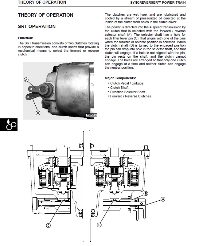

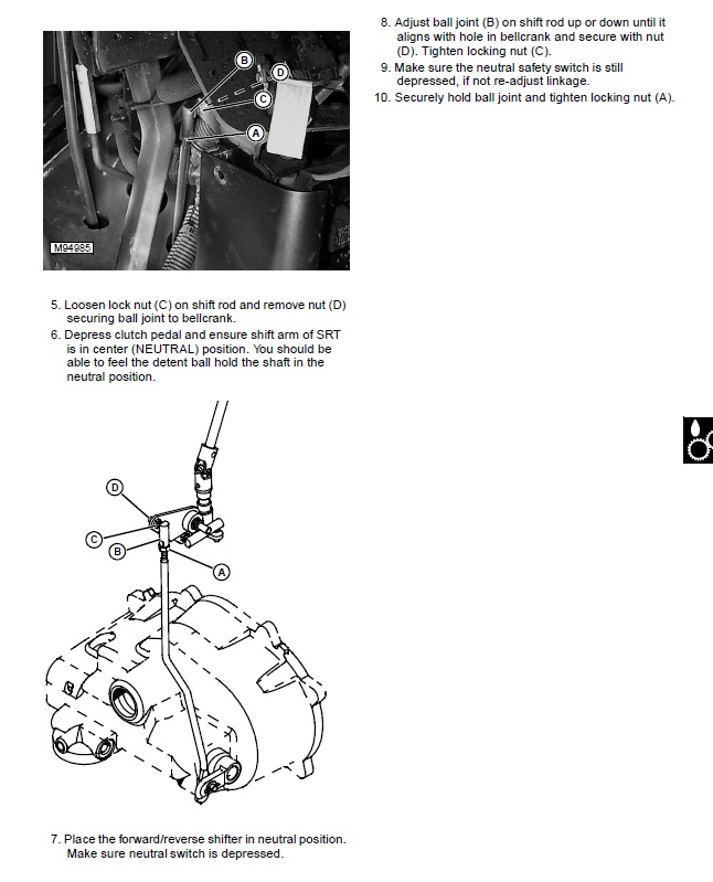

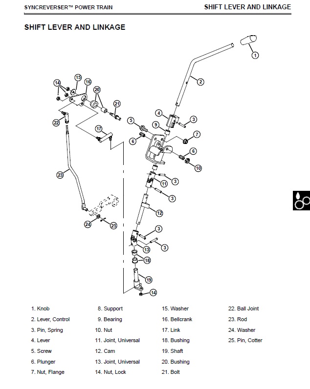

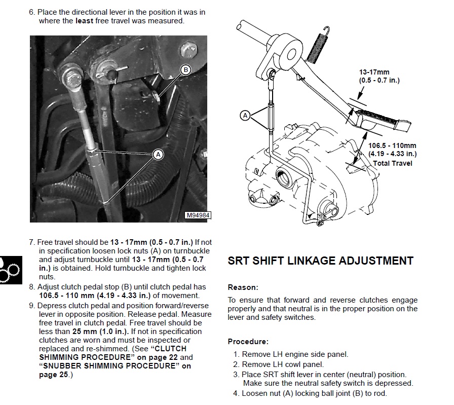

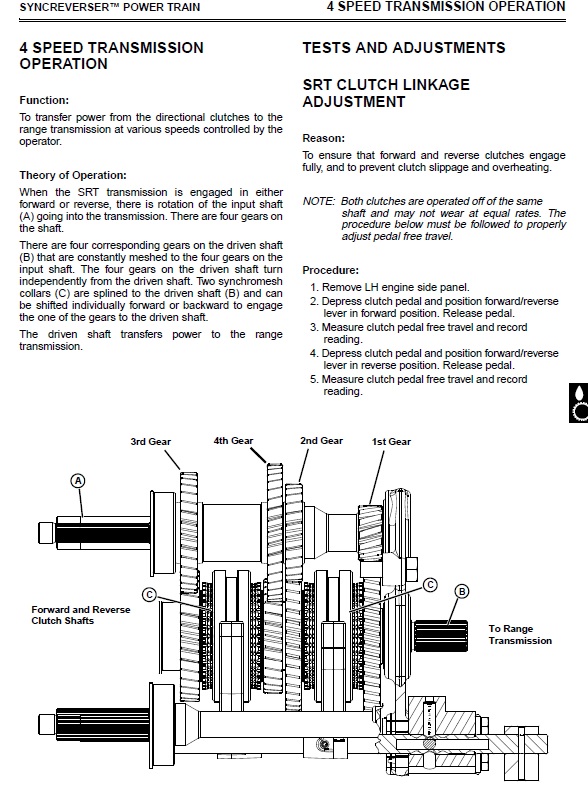

I went back to the service tech manual, and poked around some more. Appears, to me, that there is a wired safety switch for the synchreverser tranny, but appears also may need a mechanical linkage adjustment where position is important. Maybe the following five attachments will help locate the problem.. Looks like adjustments can be made without going into the tranny.
I'll poke around some more in the wiring schematics for the switch, and maybe on the clutch linkage. ??

The wiring schematic attached implies the switch for the SRT may be on the clutch pedal, circled in red. Also the pic in the 5th attachment of previous post talks of the switch and shows the area around the clutch pedal.
See if this helps.

Well, after all this, I had to spend the money and have a service guy from John Deere come out. It was the wire that goes to the starter that had worked it's way off!
Anyway, thanks for your help.

On an HST the switch is approximately 1 foot to the left of the forward/reverse pedals. But since you mention "forward/reverse handle" I'm assuming your 4300 isn't an HST?

You could bypass the switch - but I wouldn't. Starting in gear is asking for transmission trouble and / or starter gear and flywheel damage. But if you are positive it is in neutral and you just want to load it; it's your call.

There is a relay in the fuse box that is the starter disable relay. If you make up a 3" long wire with male 1/4" spade terminals crimped on each end and replace the relay with that, you'll be able to just use the key to start it and it bypasses the seat switch, pto switch, and nss. I have a hydro tractor so I'm not as worried about starting in gear and did that when I started having intermittent problems with some safety switch I couldn't track down.
