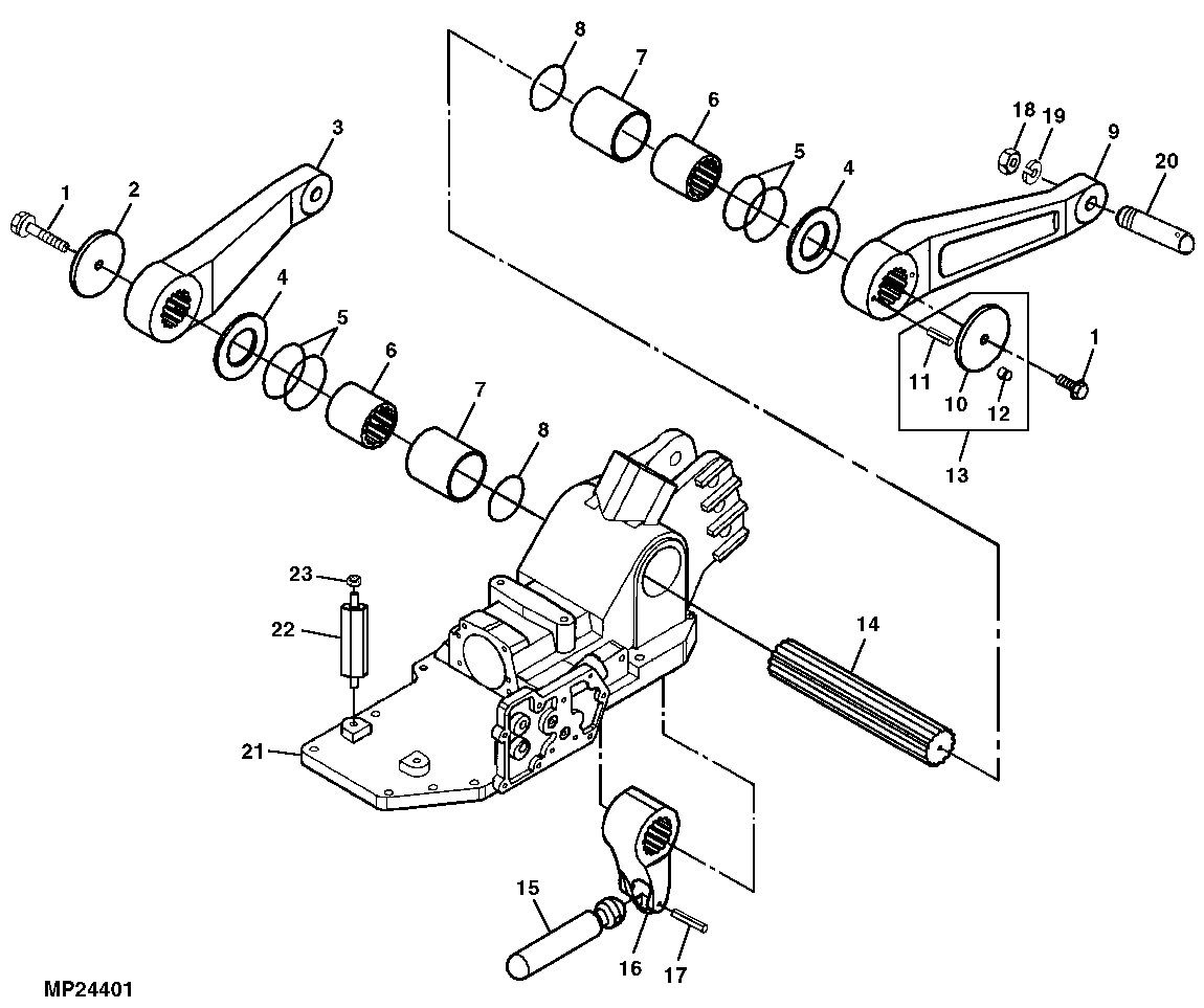

All set guys, I think. After reading your reply I went out and wanted to get more info. I checked the rod for the rate drop and could see that it was moving properly. I unbolted the seat to check the other linkage. After the seat was off I started the machine and she ran fine. I looked at the pawl and the black paint was worn off the top and it was shiney, sure enough the same wear mark was on the bottom of the seat frame. I am wondering if the up travel is set too far? Any way it seems to be working now, thank you for the quick replys. When I had the seat off I noticed the cylindrical shaped part which apears to be a filter. How ofter should I clean this? I just had the hydro oil changed and I dont think this was done. Can I unscrew this now or will I loose all of the hydro oil.

The pawl (that's not really the right term; JD calls it a "crank" or an "arm") on the splined rockshaft on your 4300 should be pointing down (not up toward your seat) according to the parts diagram I'm looking at. In the attached diagram, the "crank" is the part near the bottom labeled 16. So I don't know what part is wearing against your seat frame.

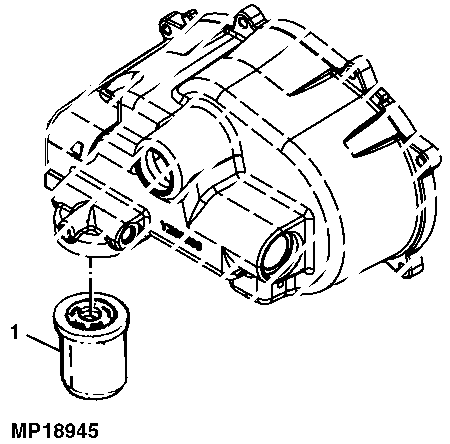

The hydraulic oil filter on your tractor mounts as shown (part 1) in the other attached diagram. I'm not sure what you're seeing under your seat, but I doubt if it's your hydraulic oil filter, so think twice before you unscrew it.
Your owner's manual should have all of this information in it, including the location of those parts and how often they should be cleaned/replaced. Mine calls for cleaning the hydraulic oil screen, replacing the filter, and replacing the oil every 500 hours. If you don't have the owner's manual, you can obtain it from the website described below.
I got the attached parts diagrams from the JD Parts website. You'll have to register to use the site, but it's free. Click on the JD Parts Catalog link to get to the parts diagrams. Or you could click on the "By Model Search" on the left to look up prices for parts that you know about. Here's an example. I looked up your 4300, and if it doesn't have a hydrostatic transmission, then the hydraulic oil filter is part # AM102723, costs $23.63, and my local dealer has three of them in stock. If you have a hydrostatic transmission, it's part #LVA10419 and costs $28.61.
