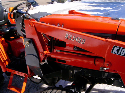

</font><font color="blue" class="small">( The loader arms I really dislike are the old dogleg style, but if that is not bad enough, go take a look at the DK Kioti series loaders, For the most part those all are positioned well above the hood of the tractors )</font>
A look at my DK/Kioti series loader as compared to the hood height
