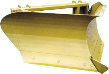

I'd like to see a boom mounted Boss 8'2" power Vee. THAT would move some snow...
