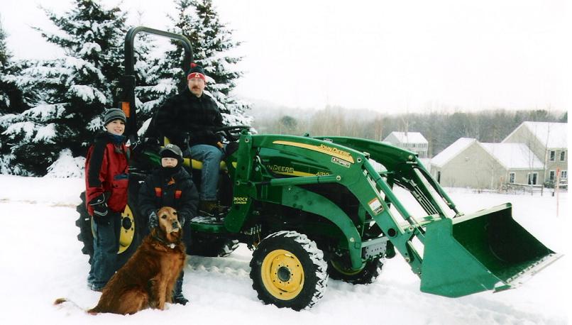

You know if you put your camera on wide angle you can take a picture even in the garage....

Here is a record shot. Not the best - scanned a photo. Maybe after paying for the tractor and assorted implements, I'll be able afford a digital camera.

Oops...let's try again.

The scanned picture turned out very good. Congrats on the beautiful tractor.
