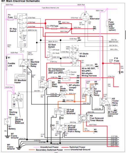

Thanks for all the input guys. I'm at a loss though...can't figure out what's turning off fuel after 9 seconds. I haven't replaced the fuel timer solenoid module....yet. It's doing at least part of it's job cutting power to the second coil. Seems a consistent 9sec delay (missing pressure buildup?) would be a clue as well as that the tractor won't move during the 9 seconds....the reverser lever, shifter and/or clutch do nothing. Guess I should check oil and hydraulic pressure's somehow...........or jump/bypass the engine run relay to hotwire the fuel shutoff solenoid. I build cabinets for a living....this is getting waaay past my pay grade.
   / 4310 runs for 9 seconds and dies #25
I was going through my schematics and your fuel pressure solenoid should have 3 wires to it. Red,white, black. When you disconnect the connector only the red lead should have power. When it is connected back up the white lead should also have power to it because the solenoid should have closed which will than supply power to the K3 relay which is the shutoff solenoid pull in relay that then goes to slot K6 which is your fuel timer module relay. You can also try doing a quick switch on slot K4 which is the engine run relay which is the power system to the whole circuit. I doubt this is it but it could be heating up and breaking contact causing the whole circuit to de-energize.
With a test probe light, pierce the red and white wires to with the key in the run position to make sure you have power. You cannot do this by disconnecting the connector because the red wire is supplying the white wire after the solenoid closes. If you do not have power to the white wire but you do to the red than your fuel solenoid is likely faulty. A quick way to check would be if the white does not have power than use a paperclip, pierce the insulation and jump the two wires together. This will bypass the solenoid connection and complete the circuit to the fuel timer module.
Just out of curiosity when you get it started and running for your 9 second intervals does it restart immediately and when you restart it do you just keep it at idle? While the system on JD is self-priming you usually still need to top the new filter off with diesel before putting on and then once started run the tractor at near wide open throttle to try and bleed any air that might be caught in the line. If you have an air pocket trapped in your fuel line the injector pump is going to push it right up to the injectors and die. Than the air is going to try and move back to the highest spot in the fuel line which will give you hard starts immediately after stalling, quick starts after sitting a few minutes and quick shutdowns until the air is out of the system.
I attached the schematic for the 4310 to give you some assistance on what I am referring to.
Don't give up yet :thumbs:
#26
Well, it's running again. I swapped the diode block 1 with block 2. Also, couldn't remember if I swapped the engine run relay yesterday when I swapped the pull-in relay so did that again also. So, still don't know what was wrong but it's running again, for now anyway. I read somewhere, can't find it now but will continue to look, about a circuit involving the diode block 1 that has or waits for a delay when running the pto off seat with the parking brake on. Or something like that...my mind's mush. A big possibility also...the contacts on ALL the relays and plug ins on the fuse panel were really dirty. I'll see of I can find what led me to swap out diode block 1. I don't know yet what block 2 is for either. Thanks Super55 and others for your thoughts and pics on this crazy problem too.
