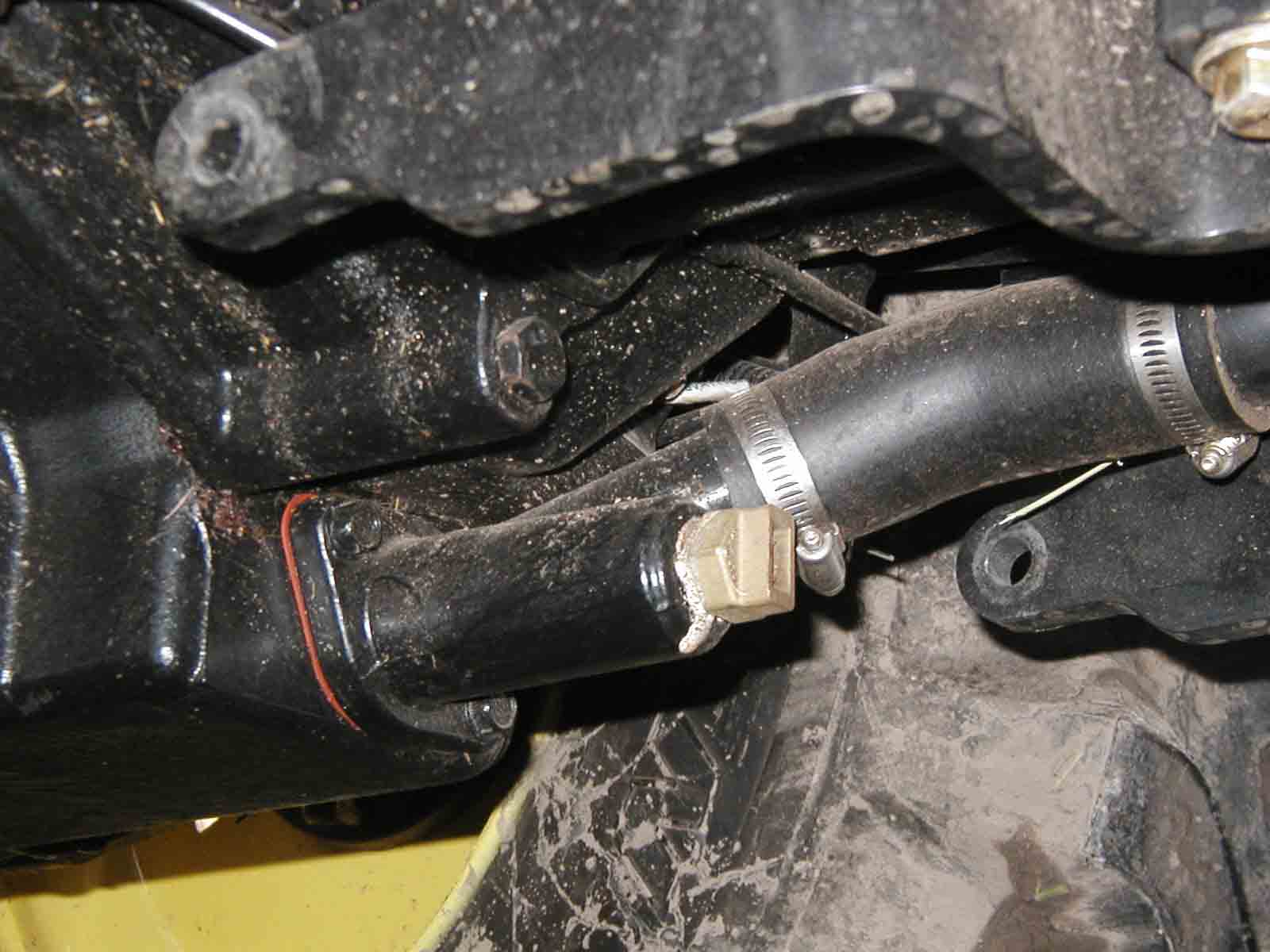

   / 4310 Transmission Oil Heater #5
Attached is a photo of the heater installation on my 4310. Photo is taken from the right side of tractor looking at the left rear tire. If you need more details let me know.
Jeff

   / 4310 Transmission Oil Heater #6
Mine is a 4300 that came with a heater with a cord about 6inches long.It is centered under the chassis in front of the axle.It seems that the JD engineers have never tried to plug in these heaters during the dead of winter with everything covered with ice. Make sure that you use lots of cable ties and run the cord up to where you can get at it in the dark, when it is cold etc. I ran all my heater cords to one central spot and tied them all together so I just plug in one cord up by the FEL to feed everything .
